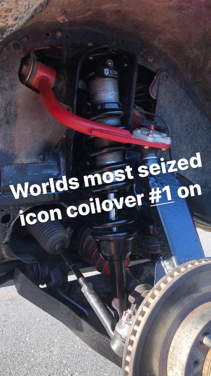

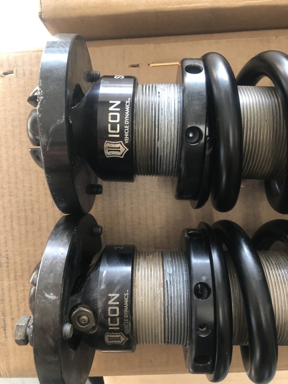

    So, does anyone have any tips for removing the misalignment spacers?

    You could always replace the spacers as well as the bushing/bearing down there. Wheelers sells them for like $7 a side. A couple snap rings and use a ball joint press kit to pop them in and out. Pretty easy.

    Yeah, ideally not trying to do that for time’s sake. Just trying to get the truck off jackstands haha

    Wheelspinner
    Wheelspinner Coco Customs
    Jul 6, 2013
    #107741
    4,370
    Steve
    Northern NJ
    '13 4x4x4cyl
    @Chux definitely beats you on worlds most seized coilover lol

    Chux
    Chux Pura Vida
    Oct 1, 2013
    #113652
    6,234
    NJ beaches
    2013 TRD O/R Beach Buggy
    Click on my Build
    :anonymous:

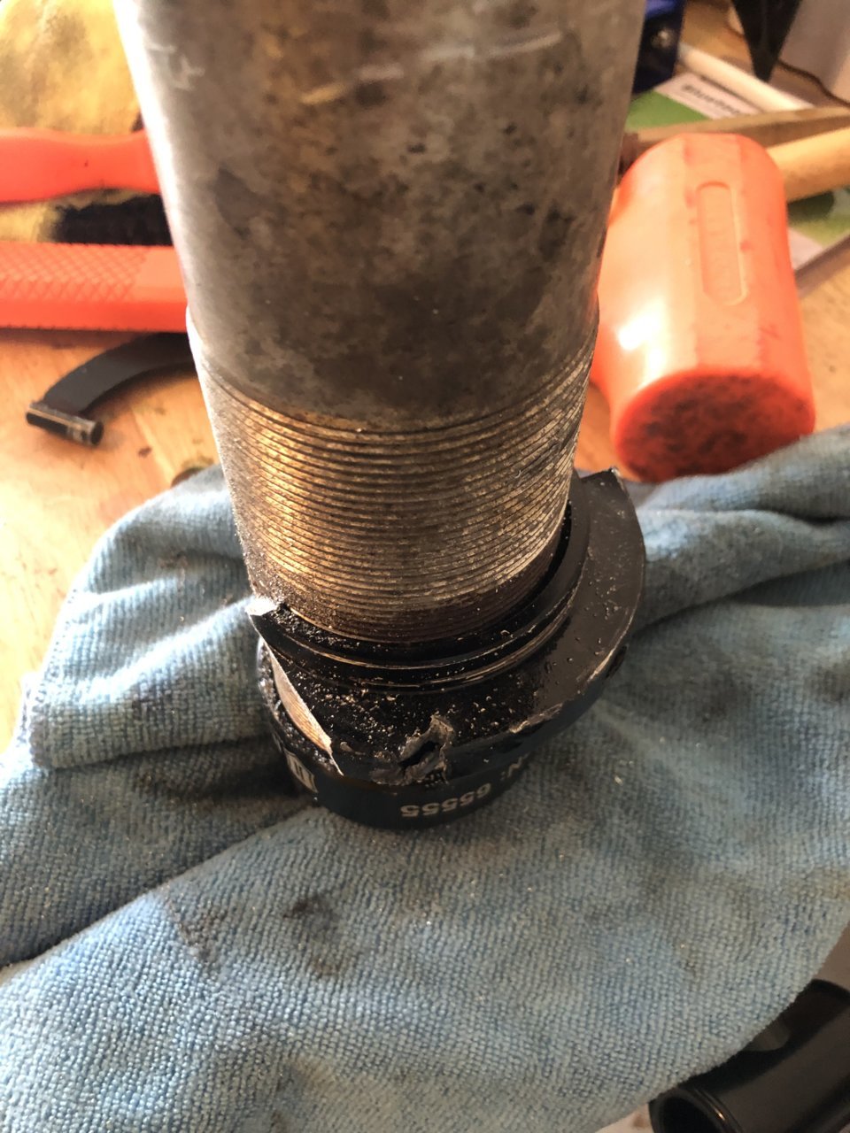

    Nimble9
    Nimble9 [OP] visit squareonecreations.com Vendor
    Oct 20, 2015
    #167184
    11,157
    Lebanon, PA
    2006 4x4 DCSB
    enough to have fun
    Hahaha I’ll take a photo of the other one. Air hammer didn’t do a damn thing

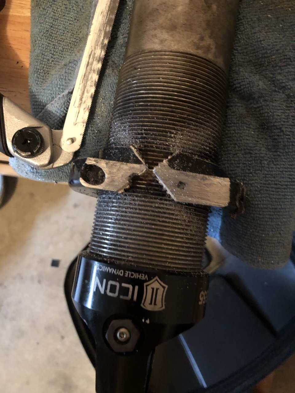

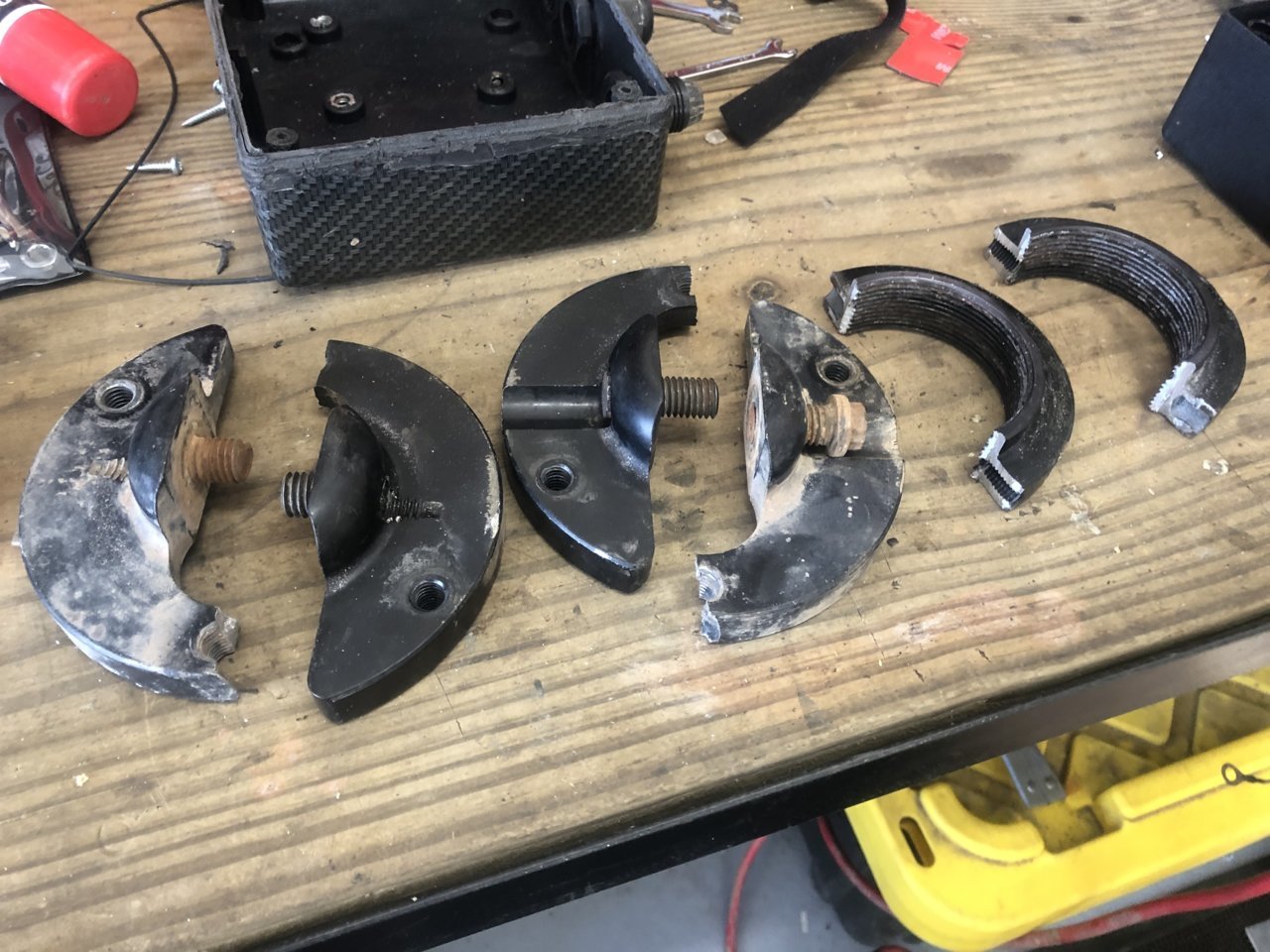

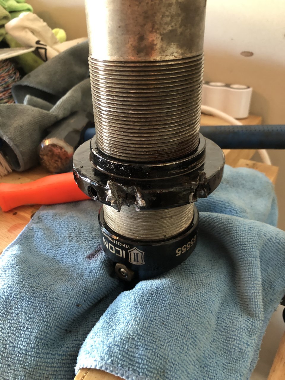

    Took a hacksaw to the collar. Still didn’t budge, so I cut the rear too.
    One half off, still stuck
    Take a look at these threads.
    Pick ftw
    @Chux I feel you lol

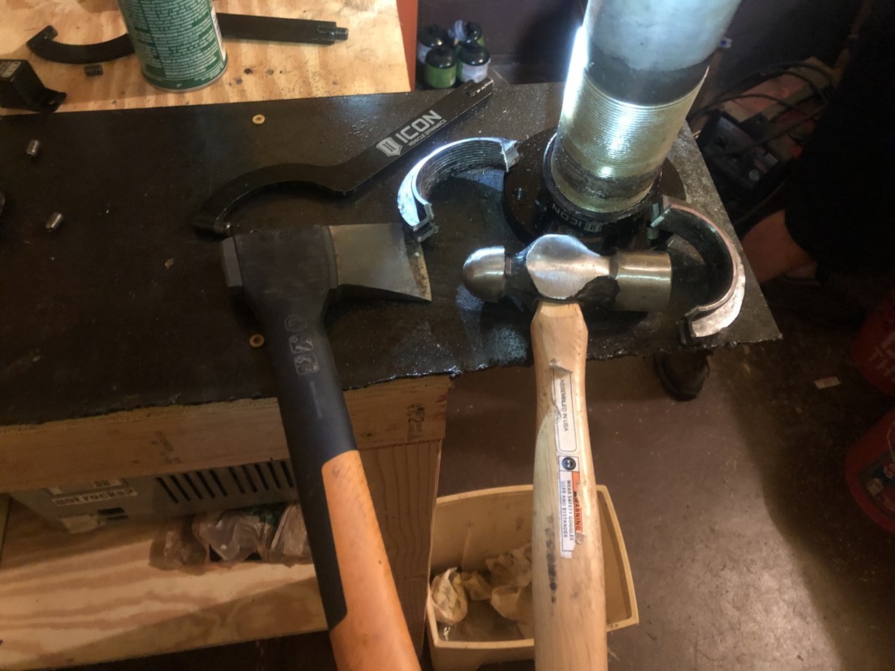

    Chux
    Chux Pura Vida
    Oct 1, 2013
    #113652
    6,234
    NJ beaches
    Click on my Build
    I took a grinder and ever so gently went in deep with two relief cuts opposite sides.. was trying to think of a way to force the relief cut open and ended up using a hatchet as a wedge, couple taps and it exploded. Like yours one side was still stuck on pretty good after getting the other off. Matt made a plate jig to mount the strut upside down that made it easier to work with. Two separate orders from icons and all the parts later getting things back in order...

    That’s amazing!!! Nice plate jig, I coulda used one of those!

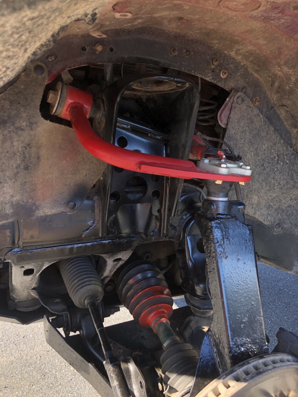

    I ordered the new collars (PN 257501) so hopefully they come this week.
    I’ve decided to swap shocks so that the larger misalignment spacers is on the rear, so the shock lower doesn’t hit my out CV boot.
    I was thinking about flipping the top hat, but the fill port might hit the chamfer at full droop lol
    It’s always something haha
