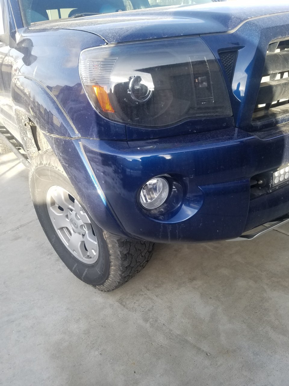

    those are awesome! I haven't seen those!
    I wonder if the light output is good lol

    Pair them with some Kensun HID off Amazon and you’ll be set up for $200! I think it’s @FadedComa or @08TRDOFFROAD with this set up. And I have another friend with those hids in his 4runner and he’s happy.
    Nimble9[QUOTED][OP] likes this.
  5. Oct 16, 2019 at 11:47 AM
    #1785
    08TRDOFFROAD
    08TRDOFFROAD Well-Known Member
    Nov 4, 2008
    #10482
    4,435
    Dan
    21' Tundra Platinum & 08' TRD Offroad DCSB 4x4
    Bilstein 5100's w/front's set at 1.75", TRD exhaust, Colormatched grill, Illuminated 4wd selector switch, BAMF Bolt on Sliders w/kickout.
    Yep, I have them.
    Paired them with a DDM tuning bi-xenon hid kit and the light output is 1000 times better than the stock halogen housings.
    I can also vouch for k2motors. I purchased mine from them too! My first set I ordered had one of the projectors set in the housing crooked so the cut off was not parallel to the ground when installed. They made the exchange painless and sent out a replacement set immediately.

    Do you have a link for the kit?
    @08TRDOFFROAD can you aim the headlights?
    I’m really interested in this kit lol

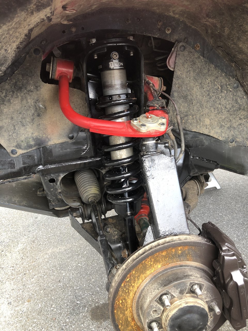

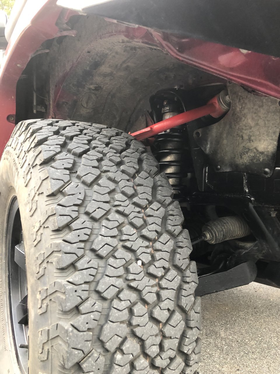

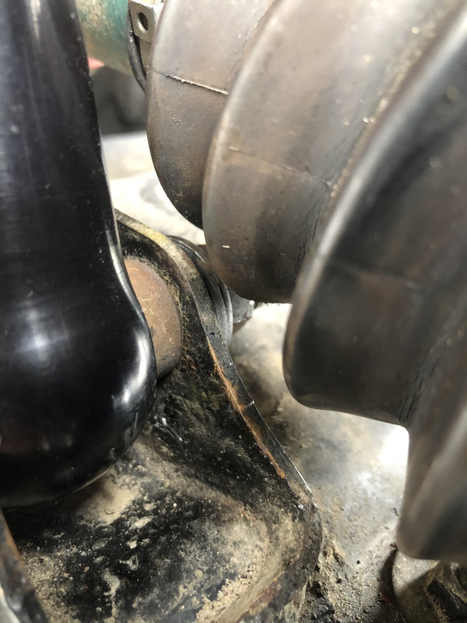

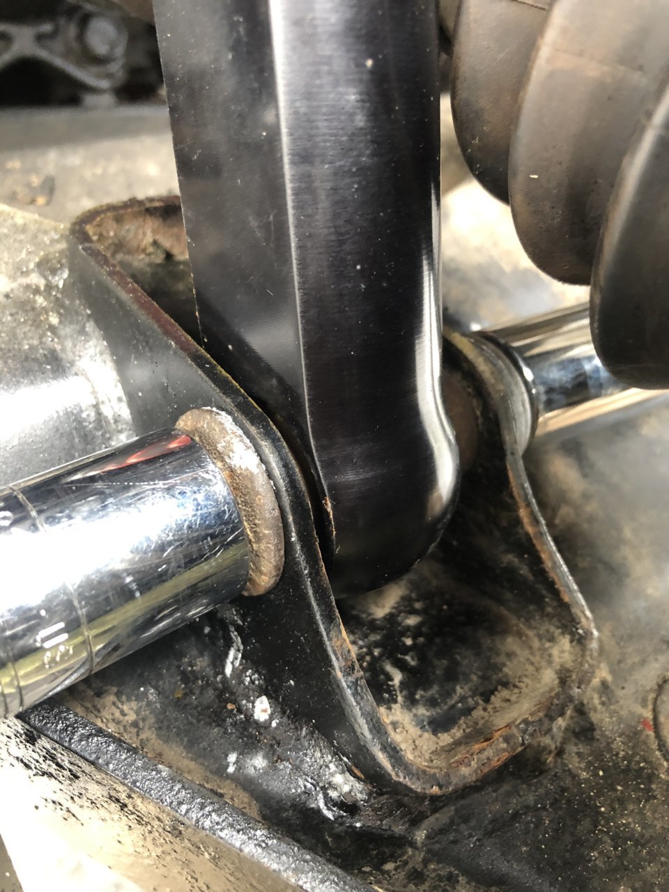

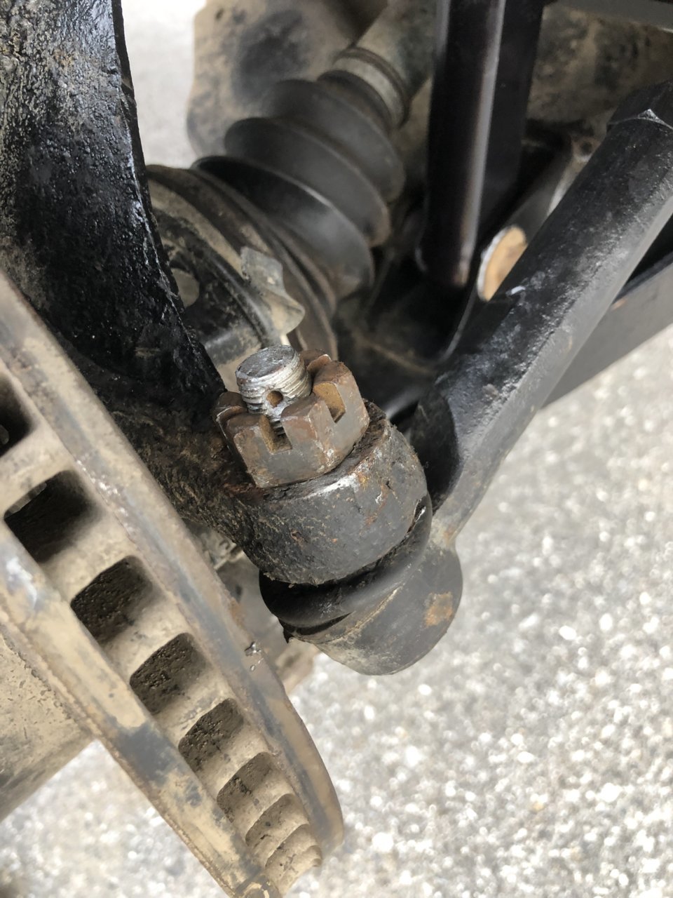

    Took me about an hour to throw the coilovers back onto the truck.
    My CV boot was touching my shock at full droop, so I had to swap the large and small spacers. Icon said it was okay to do this, but I’m not sure how I feel about this clearance:
    Now the driver’s side didn’t hit at full droop.
    But the passenger side CV fin did barely touch the LCA shock ears at full droop. I don’t know how they’re uneven. maybe @Arcticelf and his suspension wizardry has a reason? Maybe I'll need limit straps? lol
    Ratchet strap FTW
    Lastly, on the passenger side, I had to use a castle nut from my OEM UCAs since my TRE castle nut was messed up.
    Glad to know that fit.
    All back together. And honestly the ride is so much better than my OME 866 / 90021 setup. So much smoother on bumps.
    measurements:
    Before: hub to fender (OME 866 / 90021)
    • Driver: 24”
    • Passenger: 24”
    Forgot to write down droop measurements :(
    Icon Shocks:
    Initial threads showing when bought - 1.3” BOTH
    Current 10/16/2019
    Passenger Side Threads Showing - 2”
    Driver’s side threads Showing - 2.25”
    Full Droop Current
    Passenger - 27”
    Driver - 26.5”
    Ride height Hub to Fender (not settled)
    Passenger - 25”
    Driver - 25”
    Ride height Hub to Fender (10/27/2019)
    Passenger - 24”
    Driver - 24”

    the boots move when the steering swings through its arc. Looking at the pics your steering is cocked a touch so that would be the reason they arent even
  11. Oct 18, 2019 at 7:28 PM
    #1791
    Nimble9
    Nimble9 [OP] visit squareonecreations.com Vendor
    Oct 20, 2015
    #167184
    11,157
    Lebanon, PA
    2006 4x4 DCSB
    enough to have fun
    You’re right! That makes so much sense. I didn’t even notice it haha.
    so at full droop and full lock I’ll be rubbing badly I bet

    Two things
    1. The amount of time you spend at full lock and droop at the same time is extremely minimal and at very low speed
    2. Ive had the same coilovers since 2015 and I’ve never had an issue with the boots due to rubbing there

    True that. And I have CVJ axles so I don’t know if the outer boots are different lol

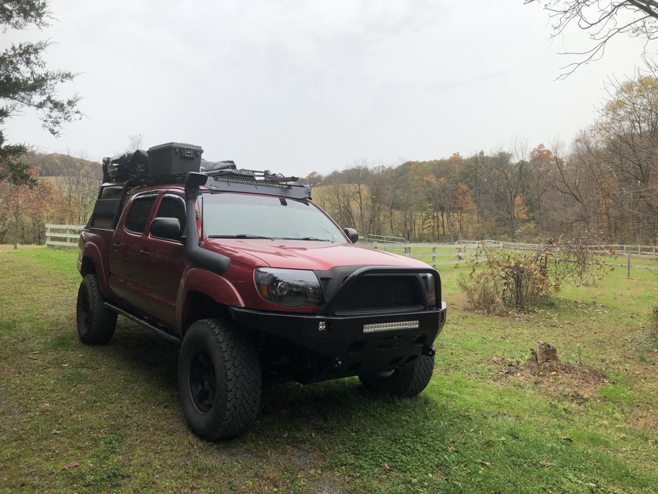

    Got around to finishing some odds and ends on the truck, and went on a fun drive to enjoy the leaves from the vehicle. (My Fiancé is recovering from surgery, so we couldn’t really hike or walk far)

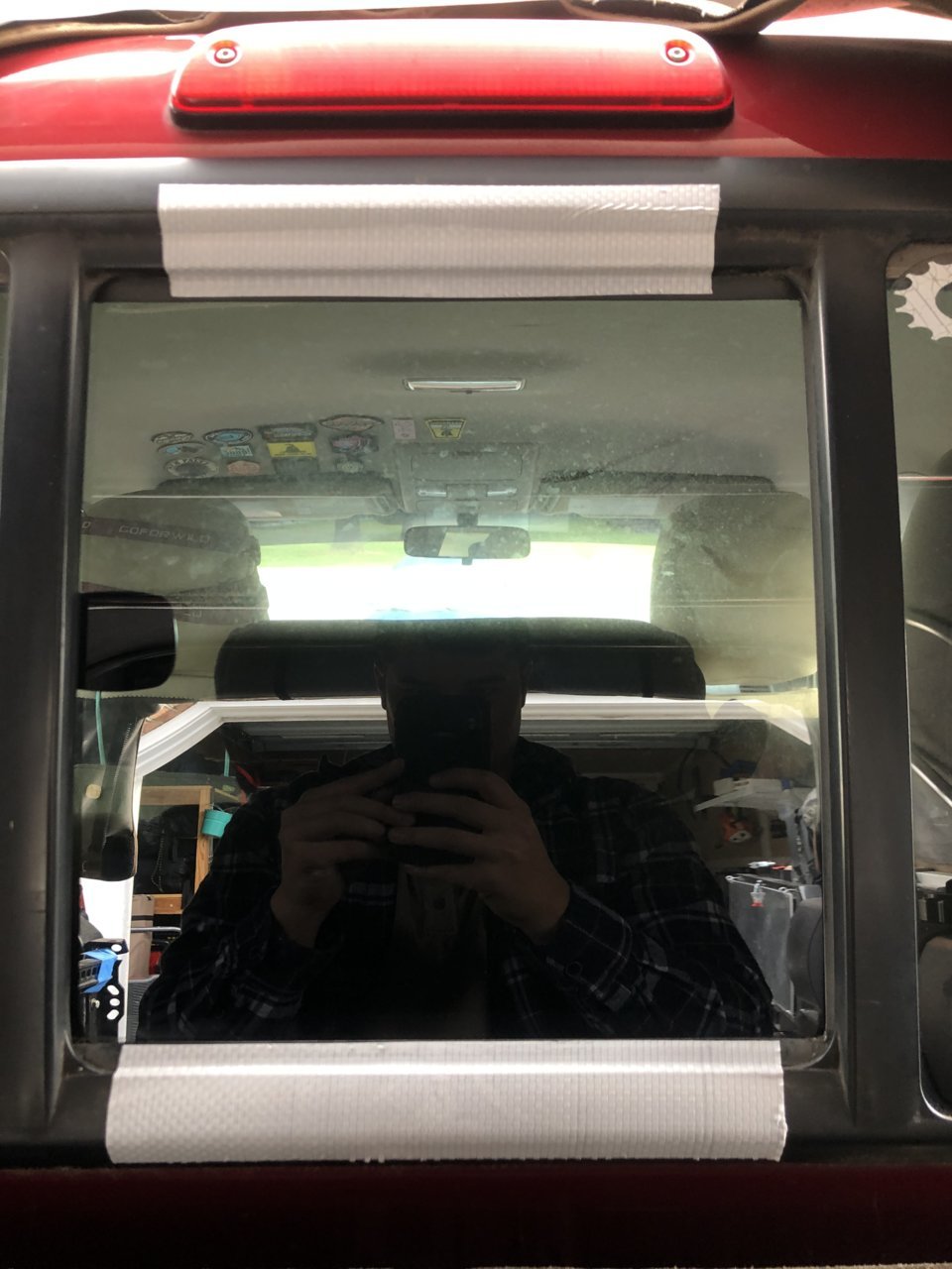

    CVT Annex channel cut and installed
    Taped the seals (don’t know if this will help or not) I’m trying to eliminate a funky smell after rain.
    303’d the plastic bits (mirrors, snorkel, handles) And then detailed the inside because why not
    at our cabin
    Cooktop86 and Tatts521 like this.

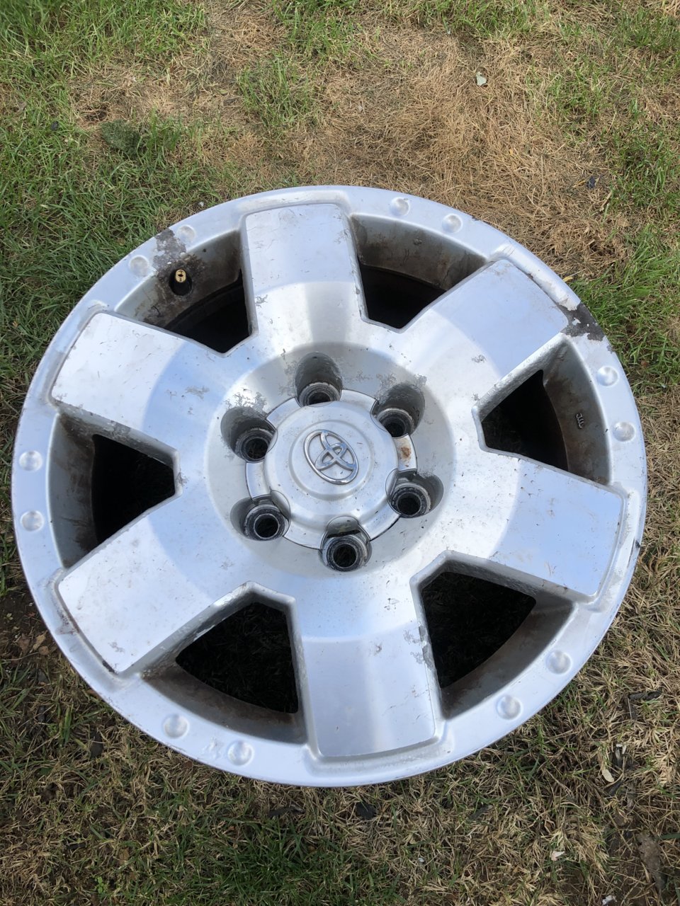

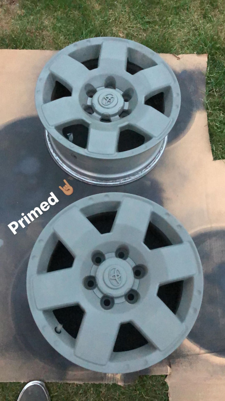

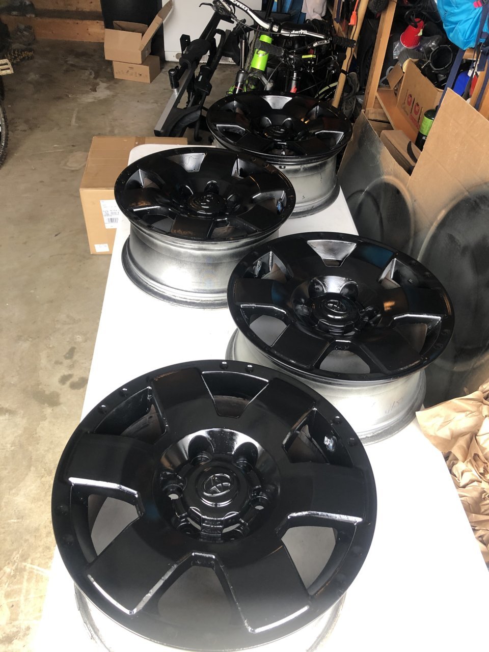

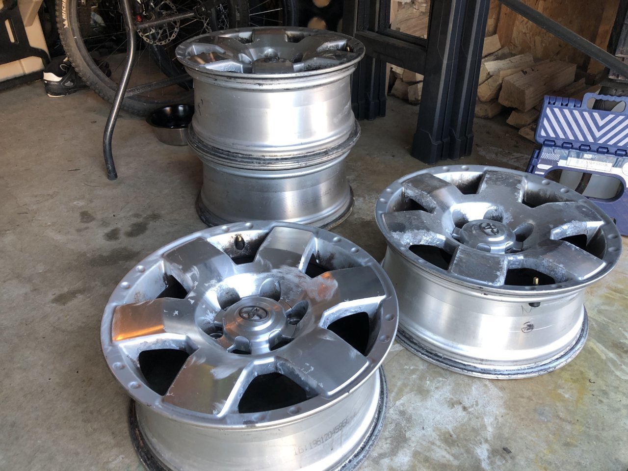

    Been working on these bad boys for a little. Refinishing these has been really fun so far
    2 sanded, 2 to go
    The before:
    Fully sanded and primed
    While paint was drying, decided to organize my tool box which was long overdue
    And cleaned the garage up to the point that I found a spare tire for @loosnut lol
    overall productive half day off work!
    Oh, and these were the remains of the candy I gave out for Halloween
    and last but not least, this good boy turned 5!

  17. Nov 17, 2019 at 6:53 PM
    #1797
    Chux
    Chux Pura Vida
    Oct 1, 2013
    #113652
    6,234
    NJ beaches
    2013 TRD O/R Beach Buggy
    Click on my Build
    That’s wild I have the same FJ wheels I’m saving for trailer build and they have the same anodize corrosion those do. Must be a thing with them..
  18. Nov 17, 2019 at 7:30 PM
    #1798
    Nimble9
    Oct 20, 2015
    #167184
    11,157
    Lebanon, PA
    2006 4x4 DCSB
    enough to have fun
    it must be. I’ve never seen aluminum wheels this bad. It’s been fun refinishing them though!
    stoked to see your trailer!!

    How are the new headlights working out?
