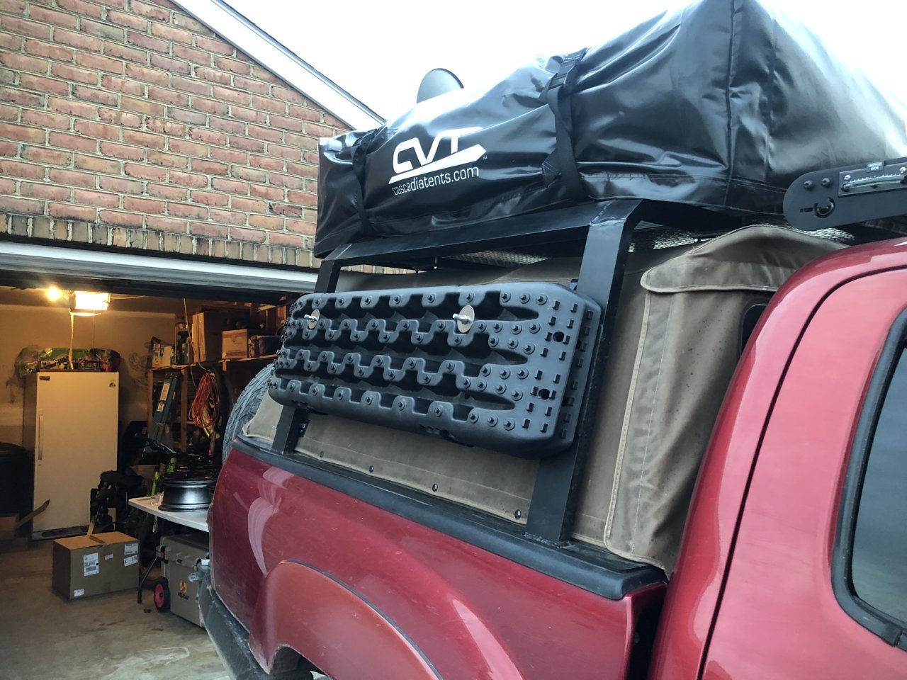

    I decided that I’m inevitably getting a cargo box, that I should start by moving my traction boards to my bed rack.
    thankfully I designed it for 3/8” cartridge bolts, so mounting took about 5 min, with most of the time rummaging around for long enough bolts.

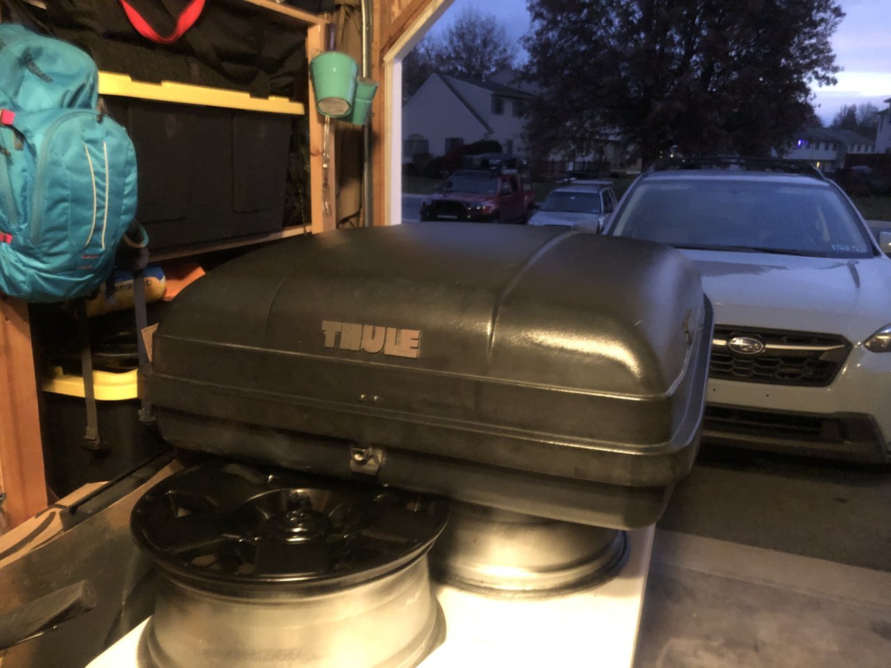

    Scored this yesterday! Stoked to have more dry storage and free up space elsewhere
    came with a missing key, but I have a ton of spare lock cores so no biggie there.

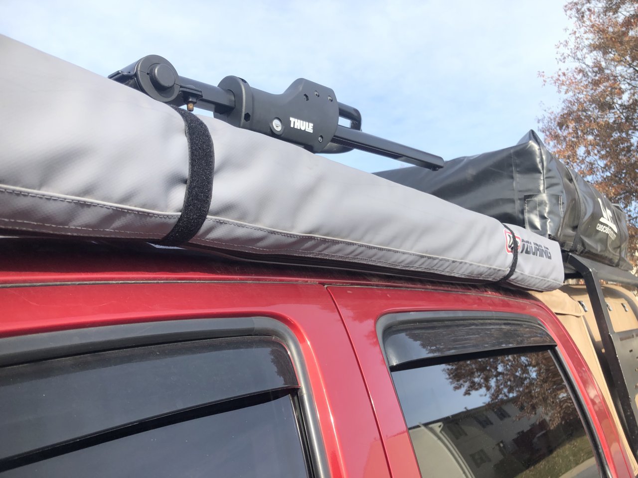

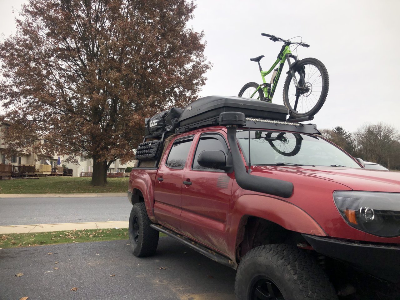

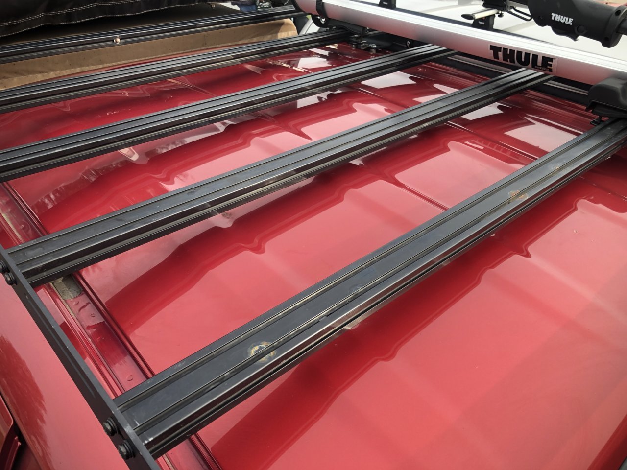

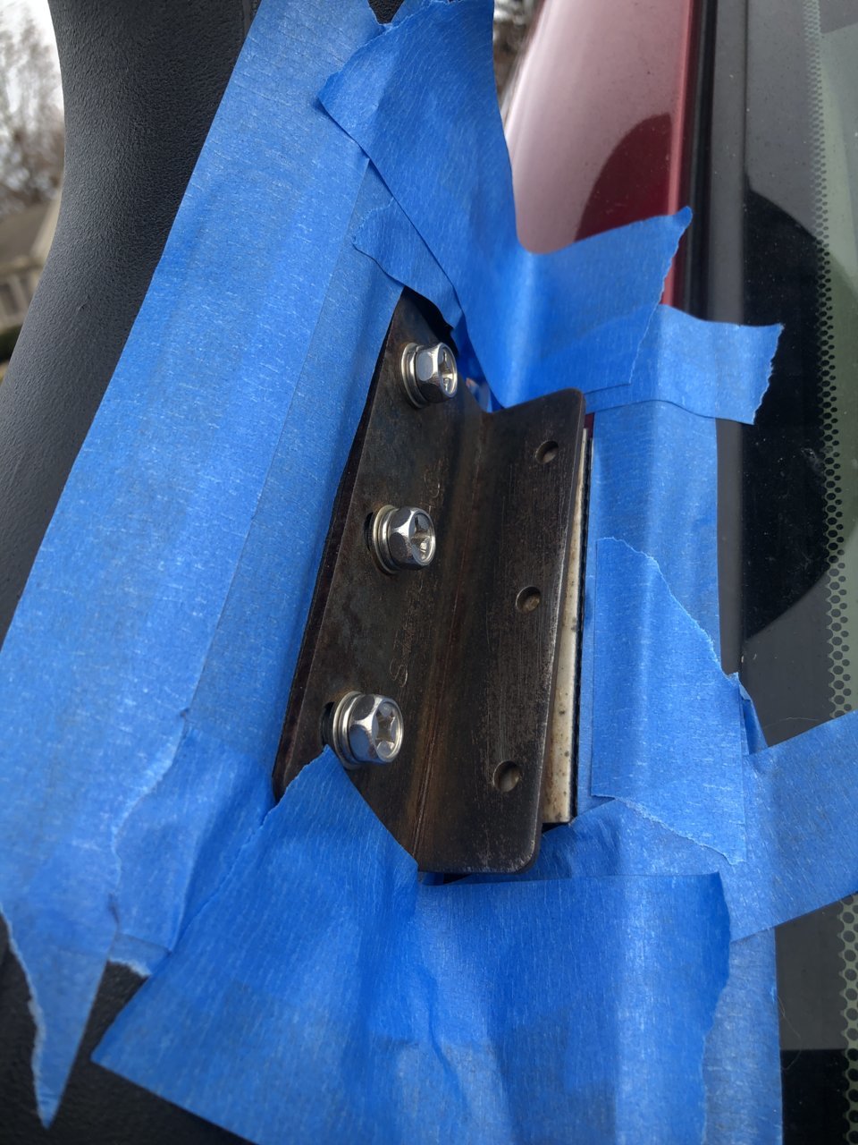

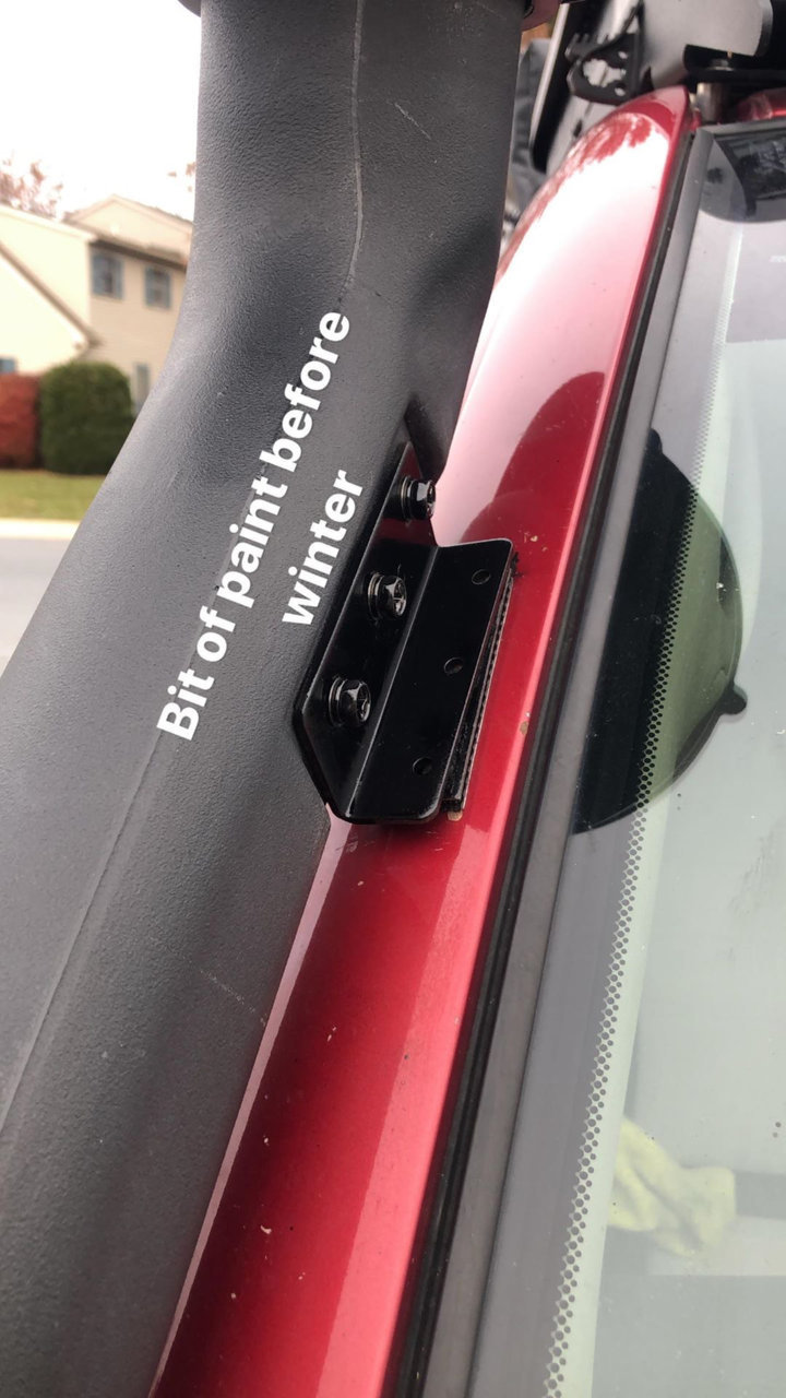

    Did a bunch of stuff today, starting with adding extra straps around my awning, the built in straps are sagging a bit
    Painted my snorkel A pillar bracket
    Removed my firewood box and cleaned/ waxed my roof
    Mounted the cargo box and tested that a bike fit up there next to it. There’s just enough space to make it work!

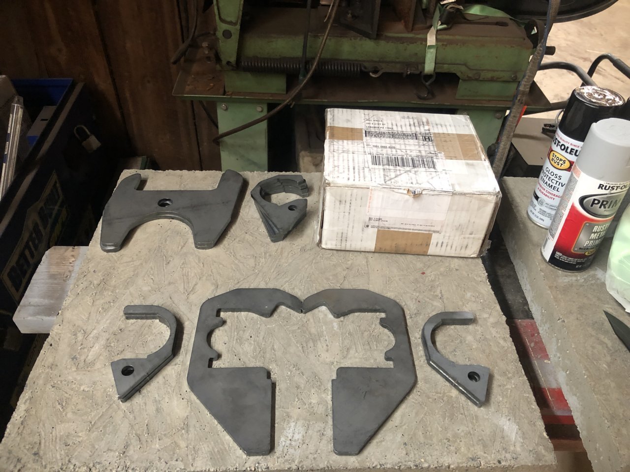

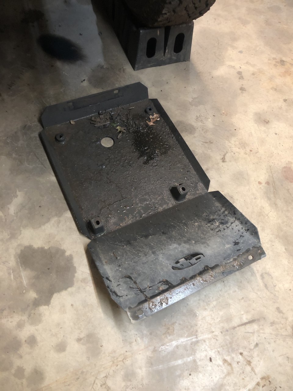

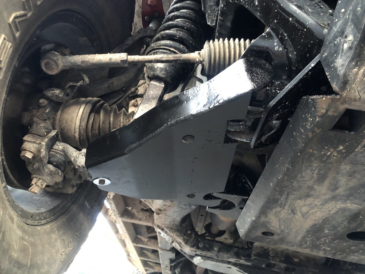

    Finally got those @Marlin Crawler HD braces burned in thanks to @Skell

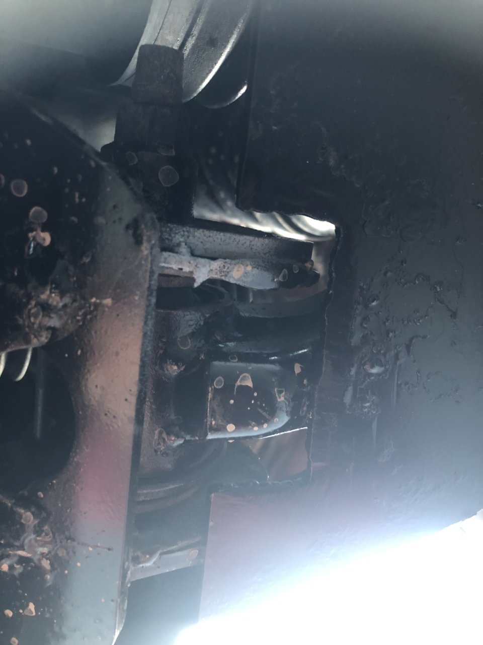

    We discovered a number of issues along the way, including how my IFS skid was rubbing on the bottom of my front diff, and that my RCI offroad LCA skids we’re rubbing on my LCA frame mount!
    I have a number of photos on my camera, but here are the ones from my phone for now:

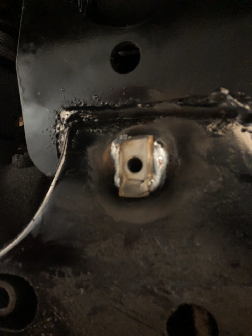

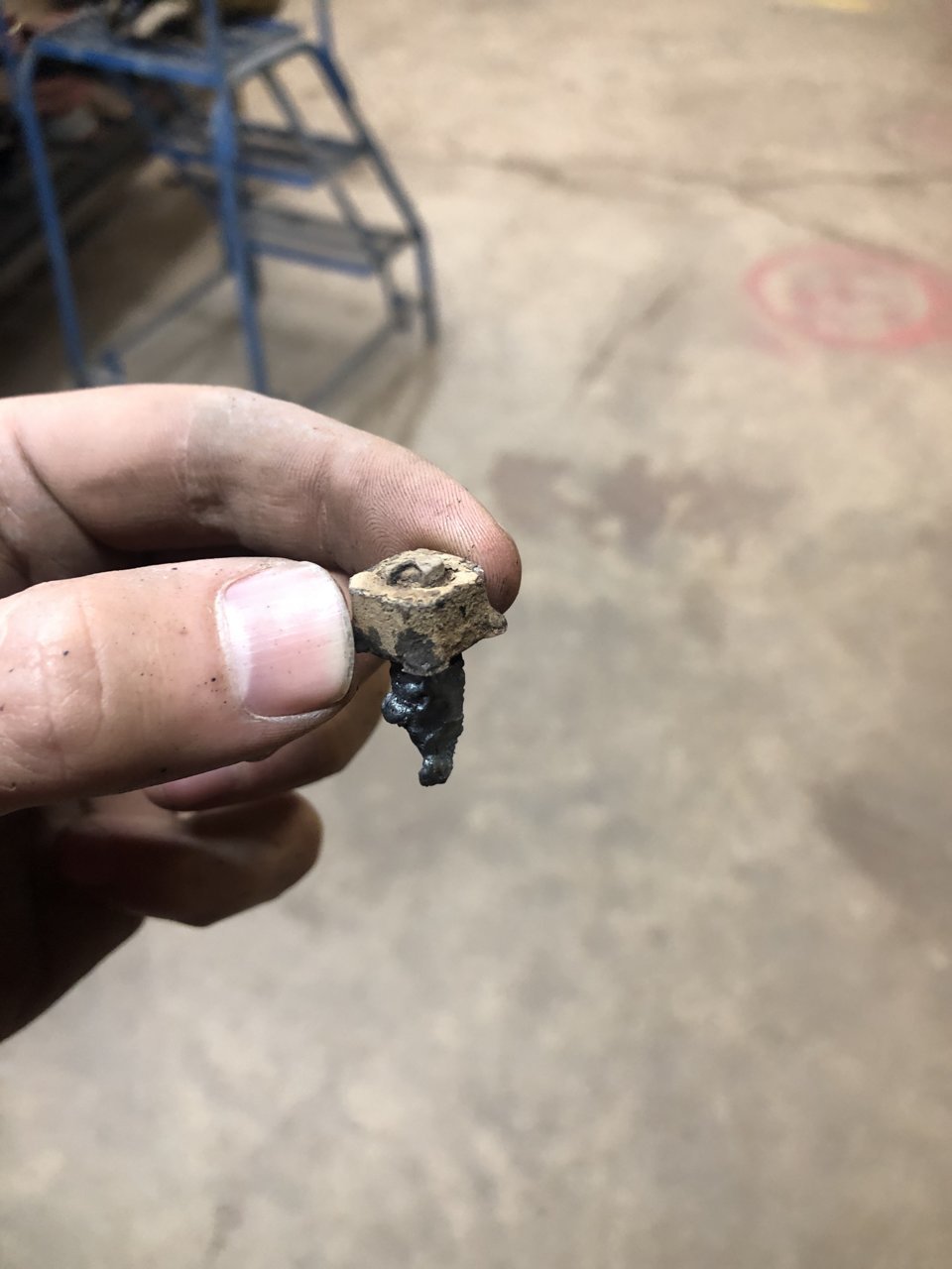

    Had to drop the IFS skid first. The weld nut in my crossmember broke, and the bolt was stuck.
    it can’t be stuck if it got turned to a liquid:
    And boom, the first time the IFS skid was dropped in about 2 years

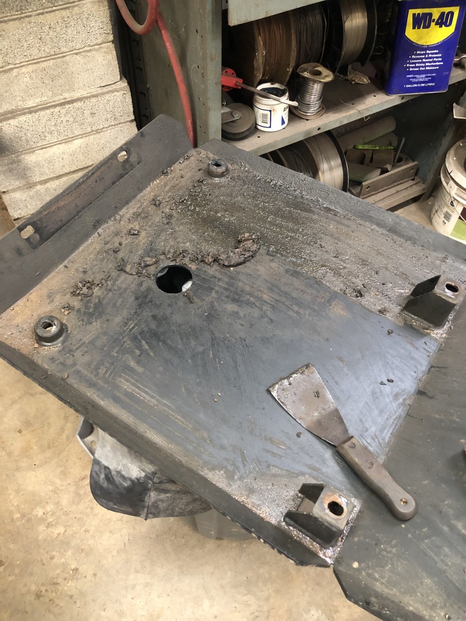

    Spent some time scraping the crud off, while Tony bent my cam tabs into place

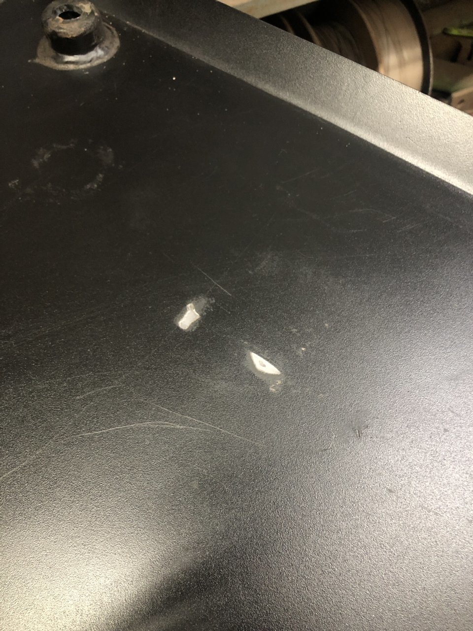

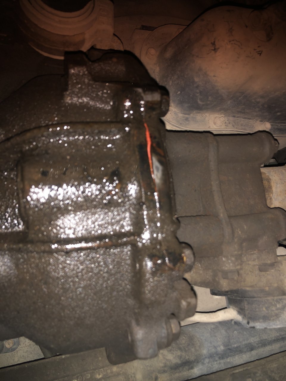

    after scraping, this is where I noticed the wear marks on the IFS skid
    Verified on my diff. Also, I know my Drivers Side CV seal is leaking lol
    We had an idea to fix this issue, while solving the broken weld nut in the crossmember issue.
    Tony moved onto tacking the stuff in place
    I got to cleaning up the LCA skids with the wire wheel

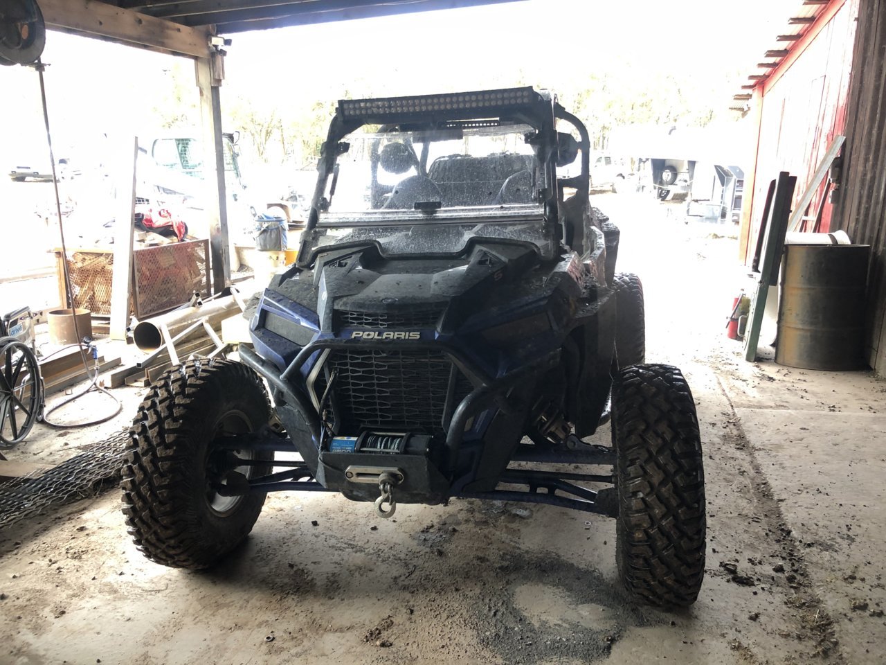

    Took a break and went for a quick rip in this thing!

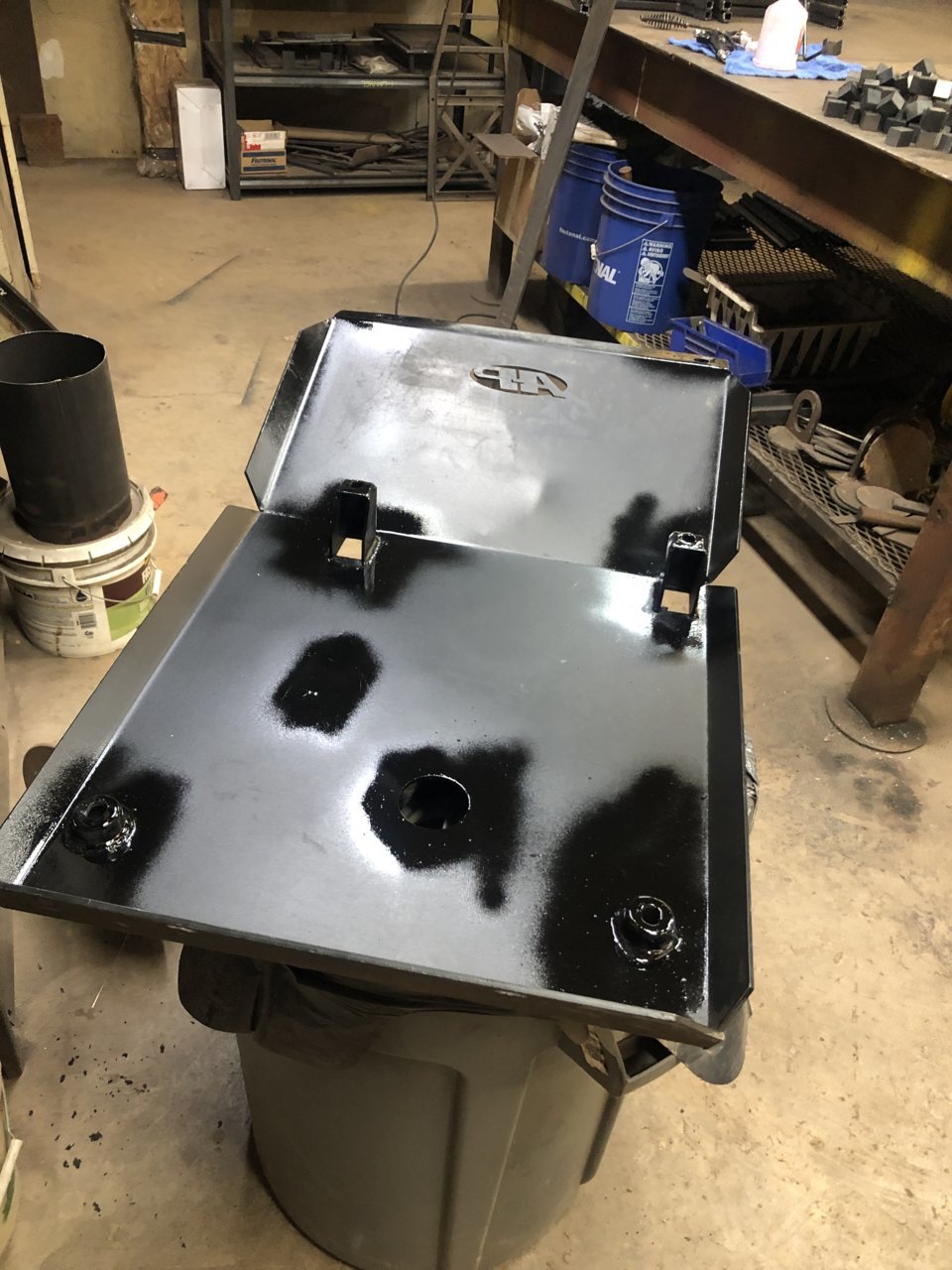

    Painted the top of the IFS Skid. Oil and dirt kept my original paint pretty good!

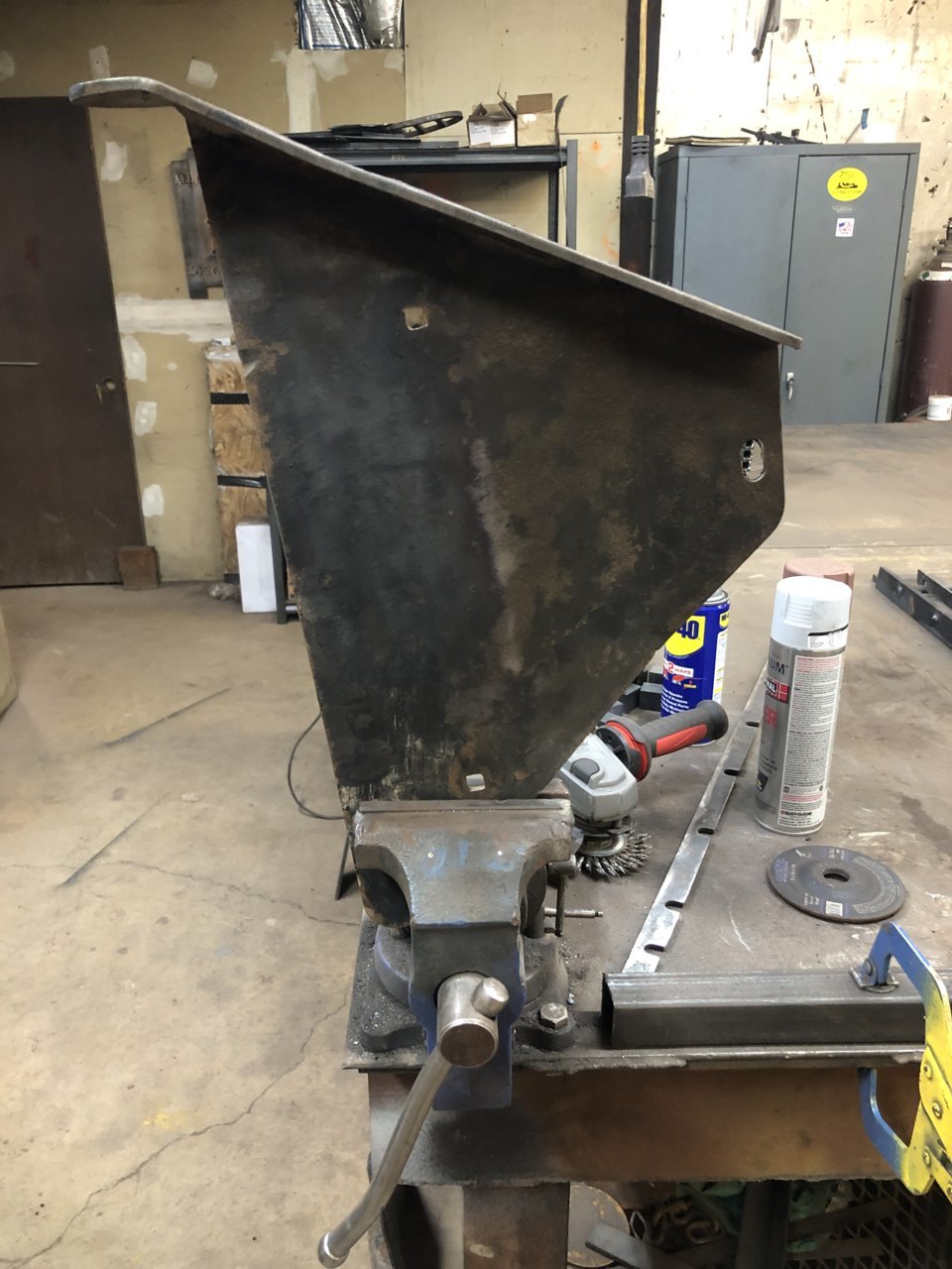

    Then marked where the LCA skids needed to be trimmed - note the wear marks from the LCA and frame mount - both sides were like this.
    Tony finished up the cam tab braces! I painted them while we moved on to drilling out the weld nuts for the cross member bolts
    Tony had the great idea of welding unistrut 3/8” nuts on in place of the original Weld nuts. This will allow new larger bolts to be used, and space the skid off the front diff.
    We drilled the holes out, and he tacked then on with a bolt threaded through the unitsrut to ensure we were centered.
    then we fitted the IFS skid and we were done for the day!

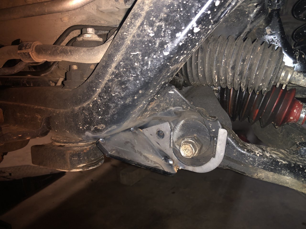

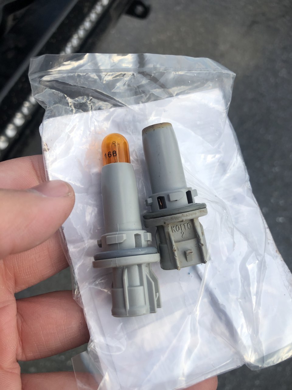

    A bit of love on this cold taco Tuesday
    New sockets and seals for the side markers
    Topped this off
    Threw these back on

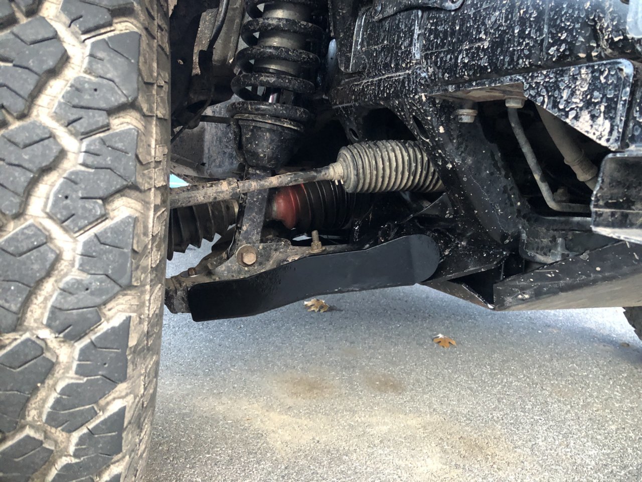

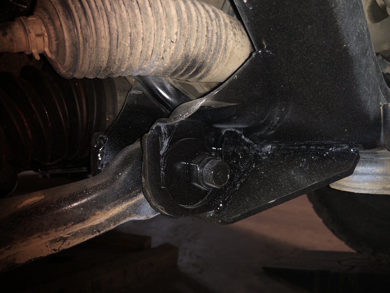

    Trimmed where they needed to be trimmed. They were rubbing so bad in the LCA mount it flared and bent the ear
    Done!
