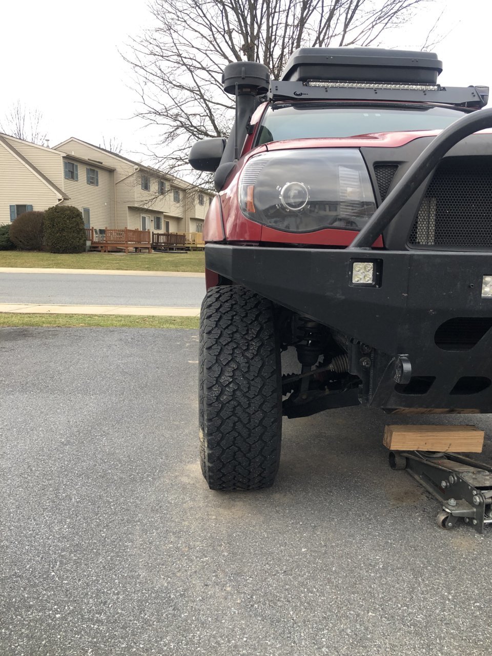

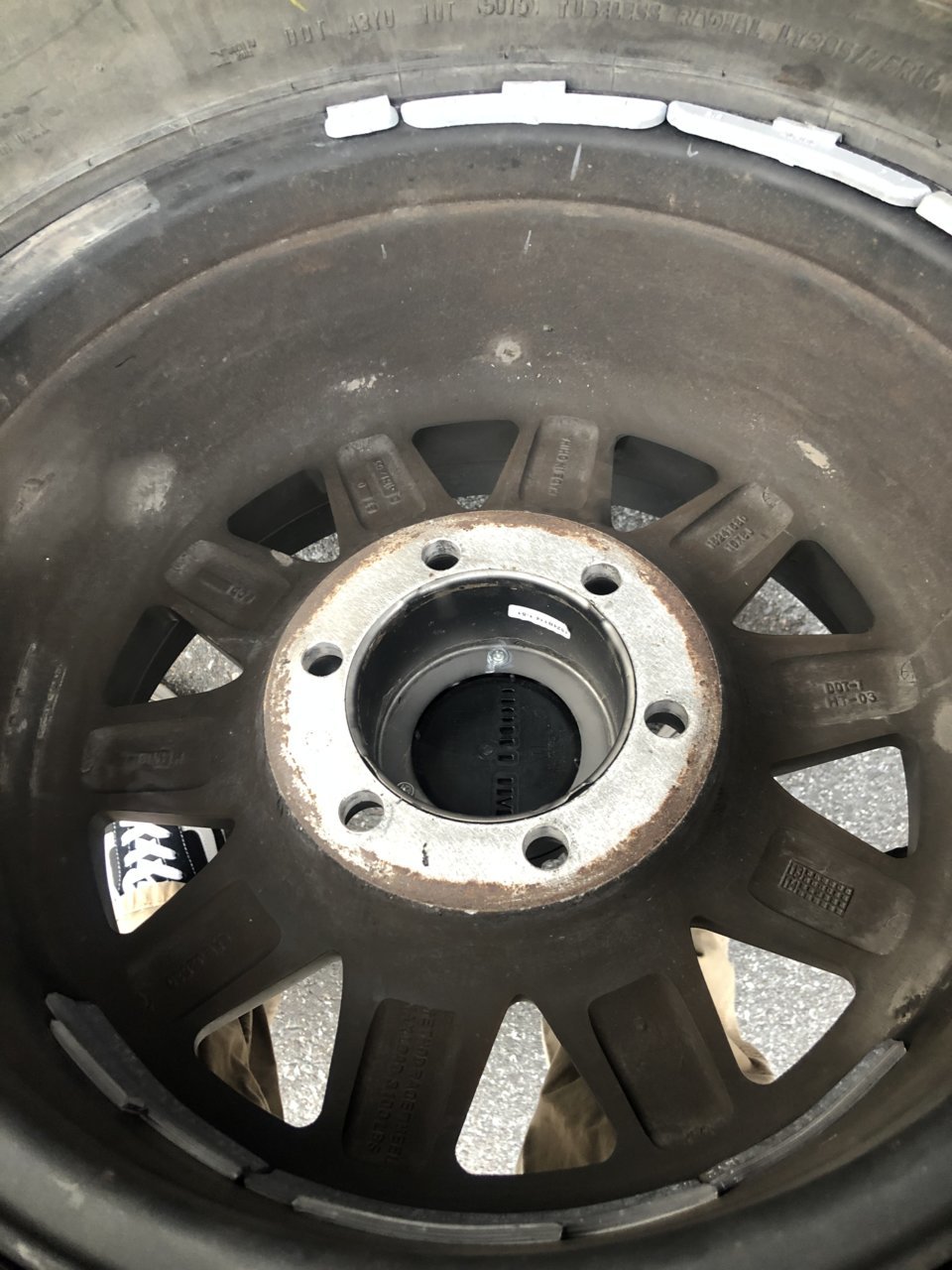

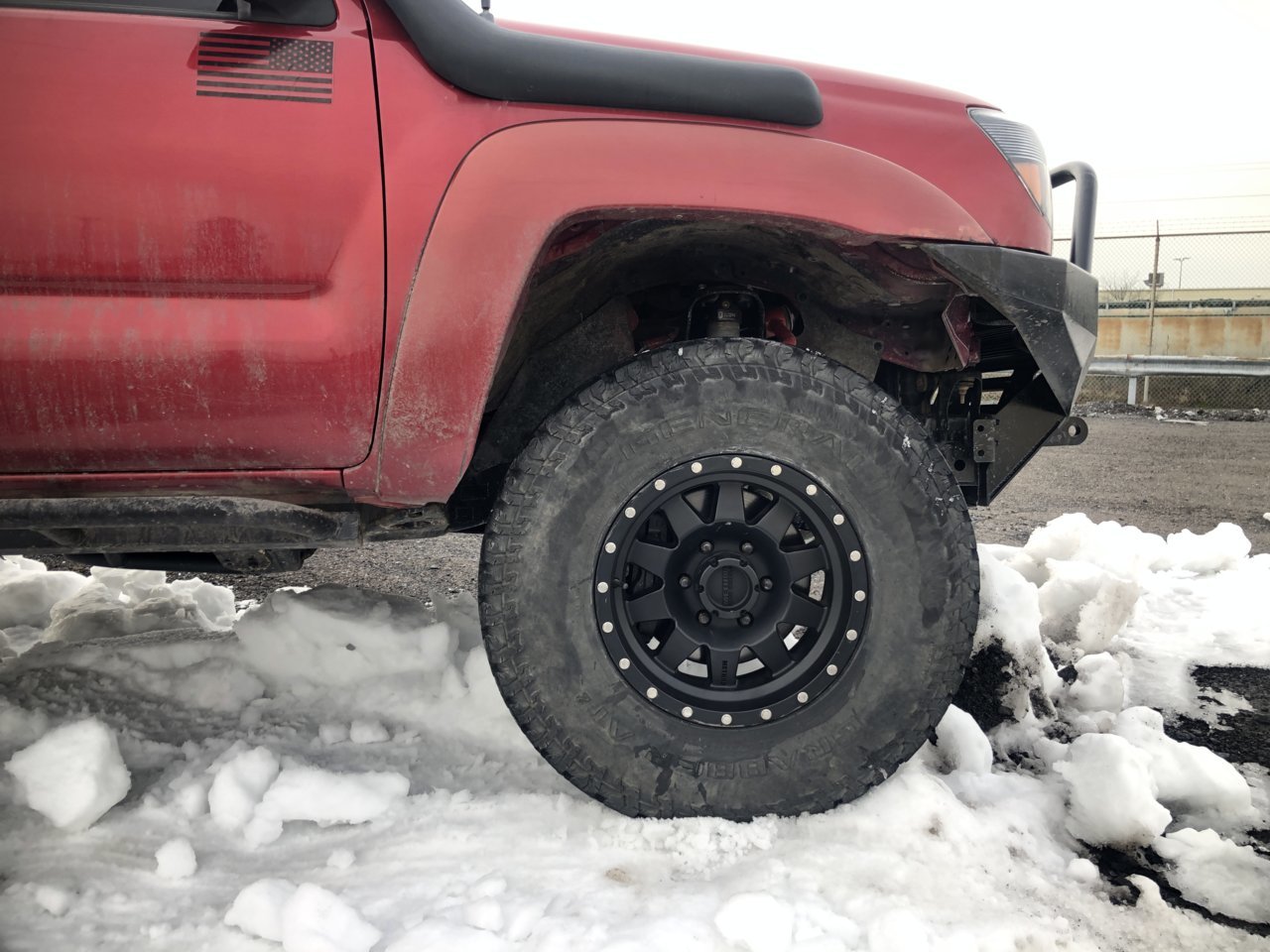

    So I noticed that the new wheels had a different offset / backspacing and that kinda bothered me.
    i was thinking about snagging some .75” bora spacers, but I knew that my wheels would need little “pockets” for the hub bolts to go into.
    I couldn’t remember what they looked like, so I took a wheel a wheel off only to find out that they wouldn’t work.
    No pockets

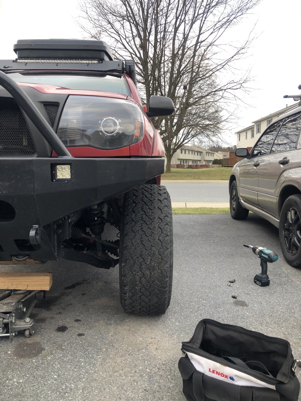

    So since I had one off I decided the throw on one spidertrax spacer to see how it’d look
    No spacer side (not settled spring)
    needless to say it looks way better so they’re staying

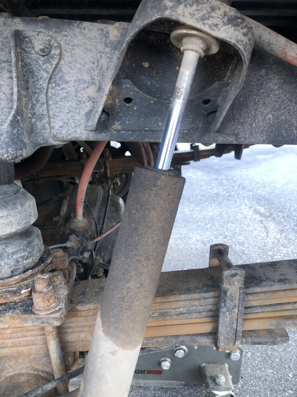

    Shoulda kept the spare shocks I had lol

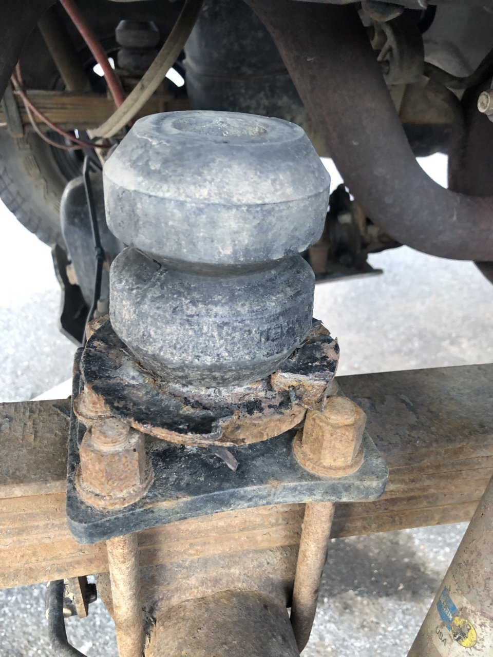

    And my timberen bumps have seen better days with a literal chunk missing lol

    I think that's what killed mine this winter lol
    I noticed the back end started getting bouncy, and at first I thought it was the weight of the full gas can on the swingout, but i'm pretty sure this is why.
    for $206 you can't go wrong
  17. Jan 30, 2020 at 12:48 PM
    #1877
    EatSleepTacos
    Mar 24, 2015
    #151688
    59,834
    Randy
    West Valley, AZ
    2017 4Runner
    Is that what died, a b110? That’s why I left my boots on. Iirc on shocks with an exposed shaft there’s an extra seal designed to clean dirt and stuff off the shaft as the shock compresses. So taking the boots off and exposing to mud and salt es no bueno. Not definitively saying that’s what caused it but maybe
    Gunshot-6A likes this.

    Wiper seals are a god send. If the 110s do indeed lack the wiper seal, the internals may look the same as that corrosive material would potentially be allowed to ingress to the internal bits as well.

    The boots tore off after like a month of being mounted. I don’t know how anyone got theirs to stay on lol
    EatSleepTacos[QUOTED] likes this.
  20. Jan 30, 2020 at 1:54 PM
    #1880
    EatSleepTacos
    Mar 24, 2015
    #151688
    59,834
    Randy
    West Valley, AZ
    2017 4Runner
    Before I installed mine I warmed them up with my wifes hair dryer and kinda massaged them so they took a normal form. Then used hose clamps to hold them to the body. Worth a shot at least, mine lasted like this as long as I owned them. And they saw some flex lol
