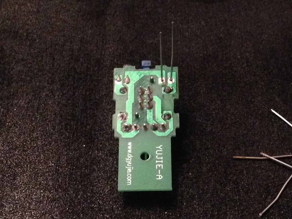

    This is the switch pcb for the small toyota push switch. 09F55BAF-0DE3-4F42-8AA0-CE9FC881C66C_zps_9485334003966c7efab8170662188abe72dc2b46.jpg
    The 6- closely spaced pins in the center are the switch pins, the 2- pairs at the top corners(one set unsoldered) are the led pins, below each pair is a pin, a space, and another pin, these are the pins for the resistors that determine light output for the leds(more often than not much brighter than oem)
    The 5 pins along the bottom of the trace area are 1- led ground(dimmer ground or chassis ground), 2- led power for general illumination, 3- not connected, 4- switch out(note this powers secondary led for switch-on), 5- switch power. I haven't popped open either an oem long switch or one of the aftermarket versions to tak pics but even though the current max is much greater(20A vs 3A) I'd be surprised if the pcb layout weren't similar.
