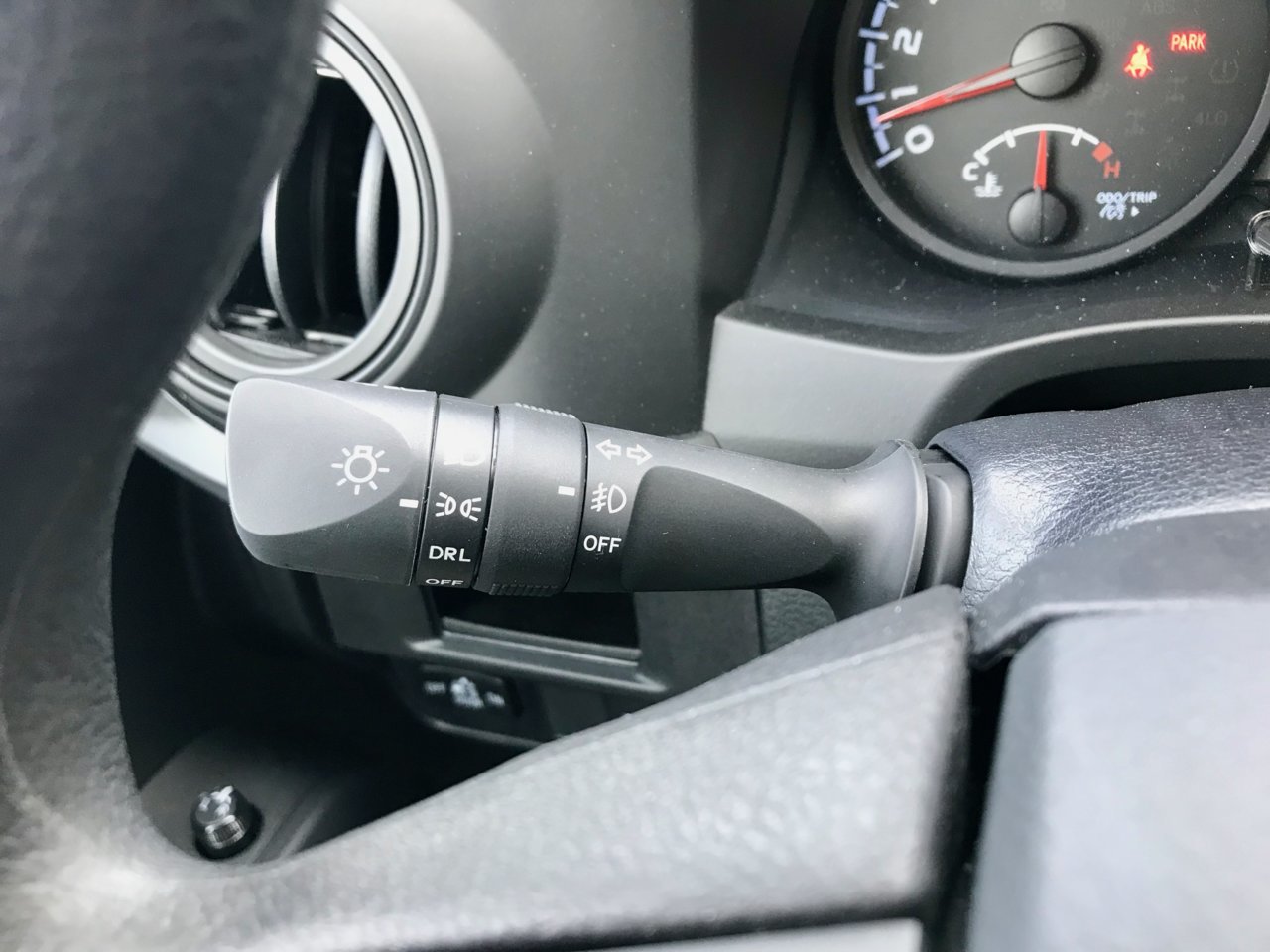

    2018 Tacoma SR
    Here you go: https://www.tacomaworld.com/threads/2016-2018-3rd-gen-intermittent-wiper-mod.397942/

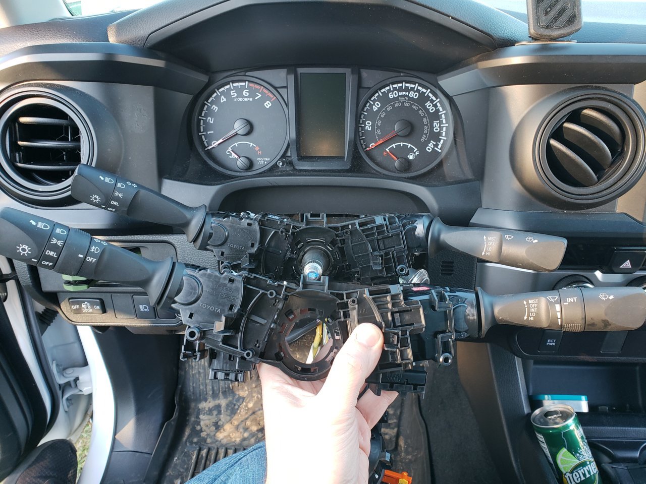

    I just went ahead and added these when adding the fog light stalk as they clip together.
    Old in the back - no fog light toggle, no intermittent wipers
    New stalks in the front - Fog light toggle and intermittent wipers

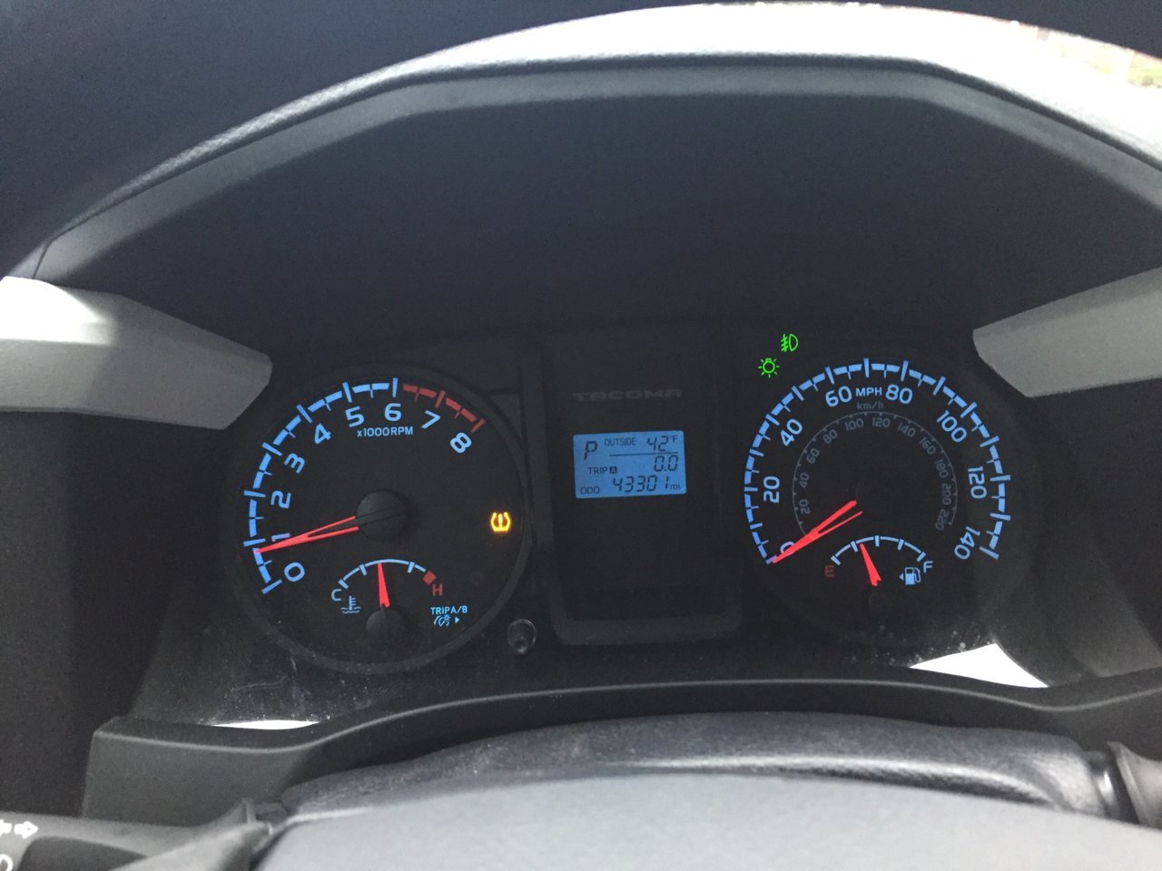

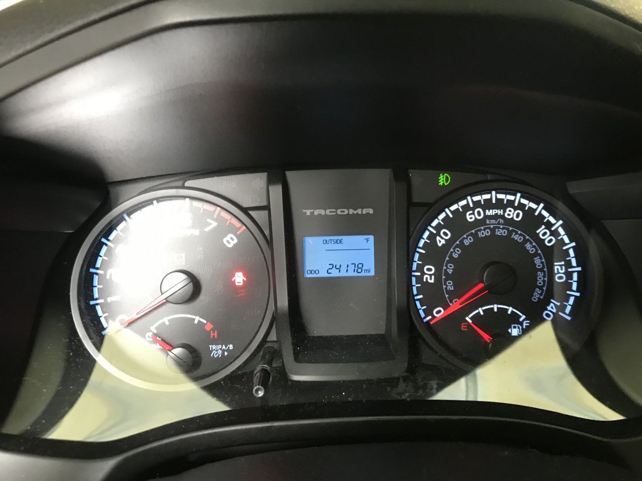

    That's exactly the same way mine works. The instrument cluster light is what tells you the fog lights are on, and nothing else.

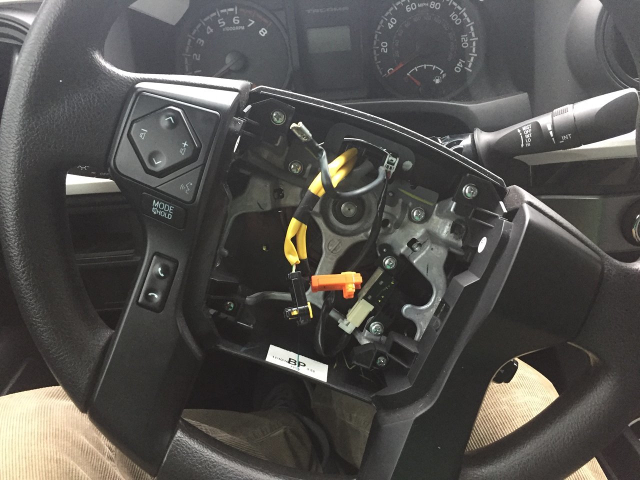

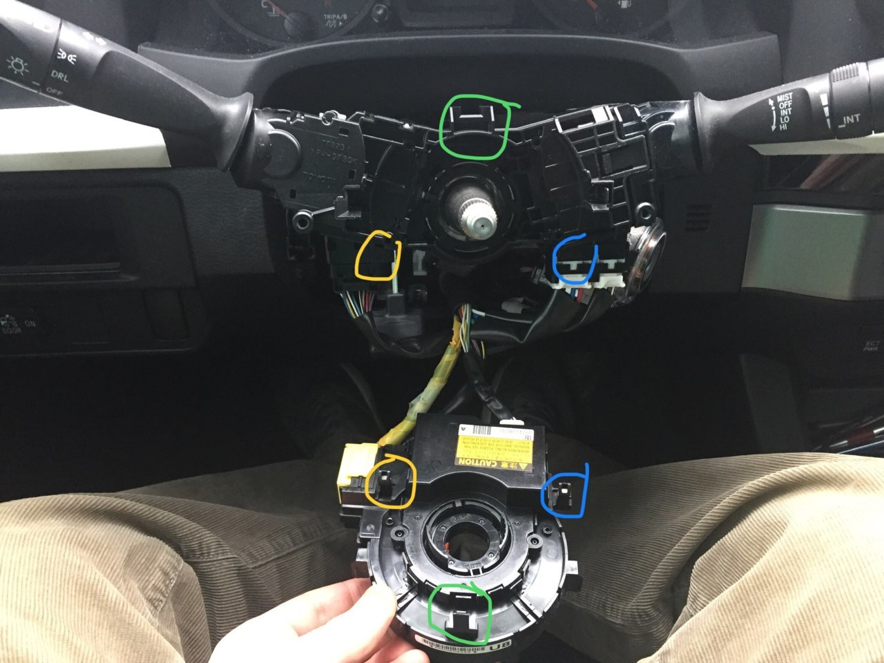

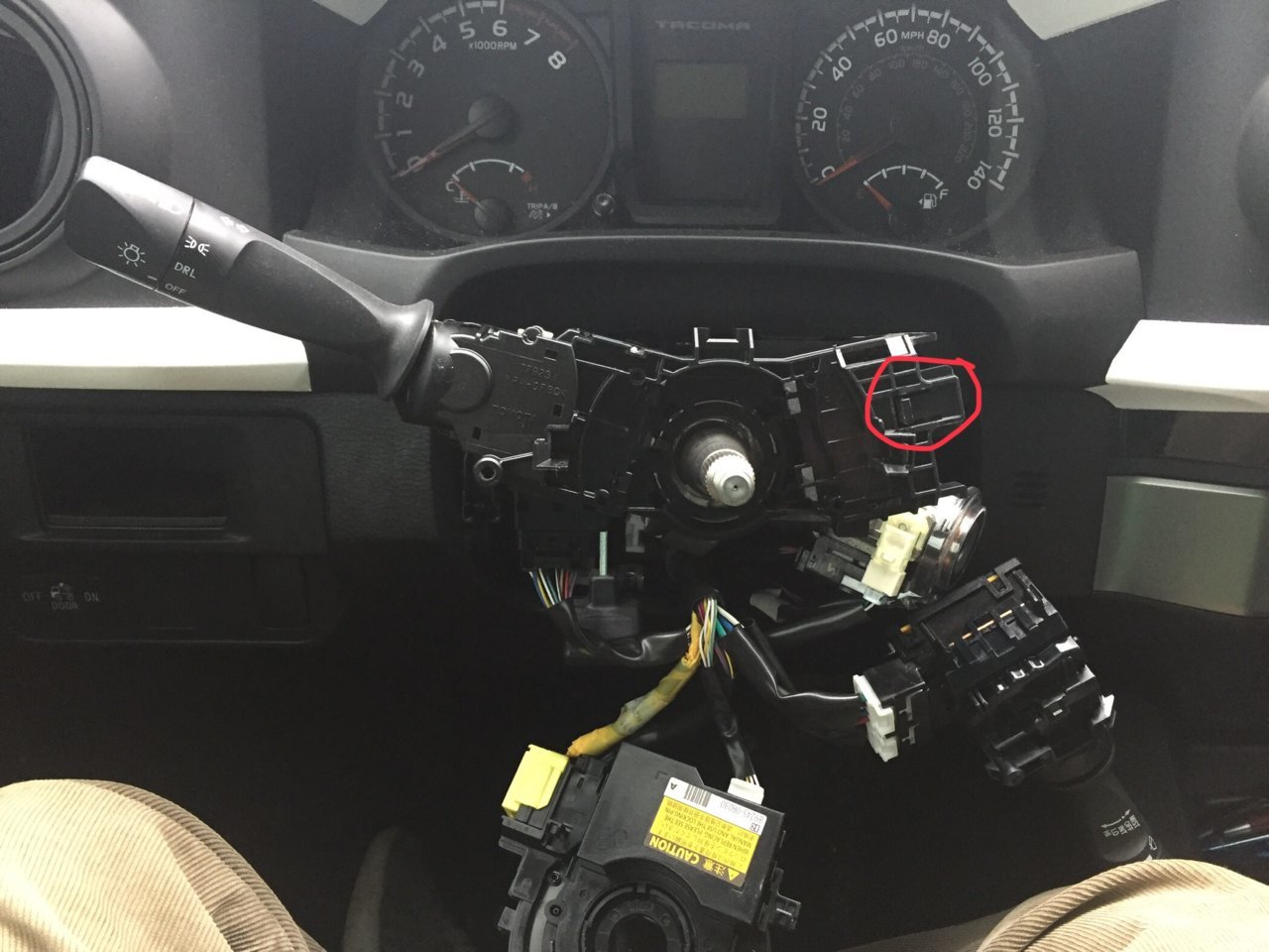

    Great writeup! I did this today with steering wheel off method. Swapped in a pro grill while I was at it.
    Some pictures and notes to help others....
    1. The torx screws holding the airbag in were really hard to get loose. I ended up attaching pair of locking piers to the end of my bit driver to get more torque to get them started.
    2. Once the airbag is off, you see the picture below. I unplugged the top middle and top right connectors as to not damage them when yanking the wheel off. I didn't see an easy way to unplug the airbag cables so I left those attached. You will also need a deep 19mm socket for the wheel nut in the center because its recessed so deep. I was barely able to get it with my wrench, because the end of the handle starts to hit the outer part of the wheel. I used the piece of tape on my dash and on the wheel so I could re-install it at the same position I took it off. Wheel definitely required a good yank to get it off.
    3. Not sure what the next plastic assembly is called (I think I saw some calling it the clockspring?). Anywho, as others mentioned, its got three tabs circled below.
    4. Then disconnect the wiper stalk (and add intermittent wipers while you're at it!)
    5. Finally remove the light stalk, its got three tabs at 12, 3 and 6 o'clock. Even once the tabs were popped it didn't come off easy. Another good yank was required.
    Putting it all back together is a breeze....just snap, clip, clip, plug, clip and you're good. (Don't forget the wheel nut or to re-tighten the airbag screws!)
    Thanks Nitori and everyone else that chimed in with their experience.

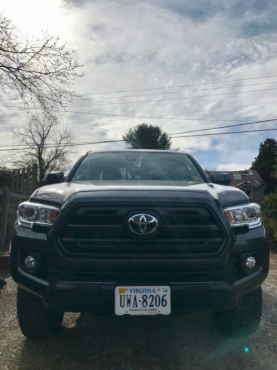

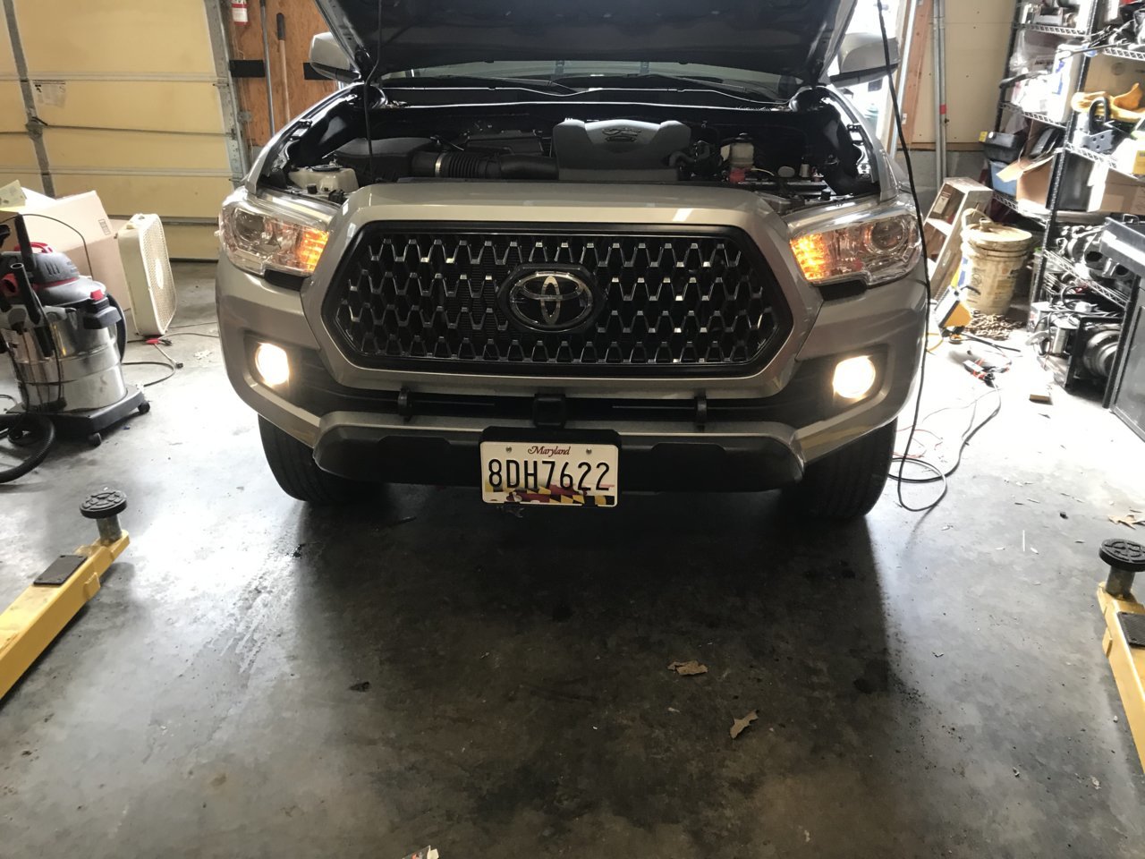

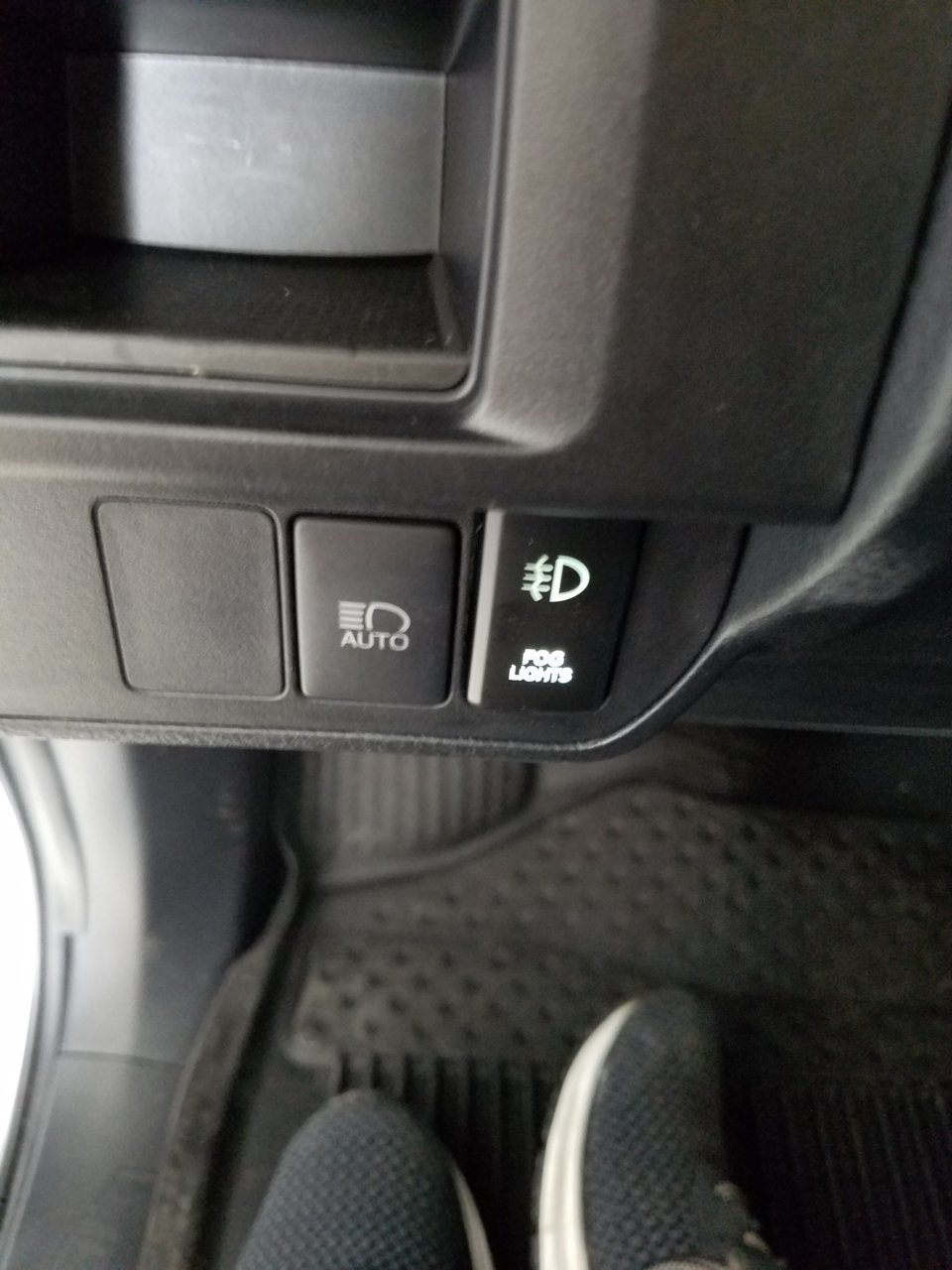

    Achievement unlocked! The fog light (pre-wired) and intermittent wipers mod done on a 2019 SR with everything functioning as it should. Thanks to @Nitori for an awesome mod! Also to @Roll_Terps , @lax22 and @bourbonbyte for useful pictures and videos that helped along the way.

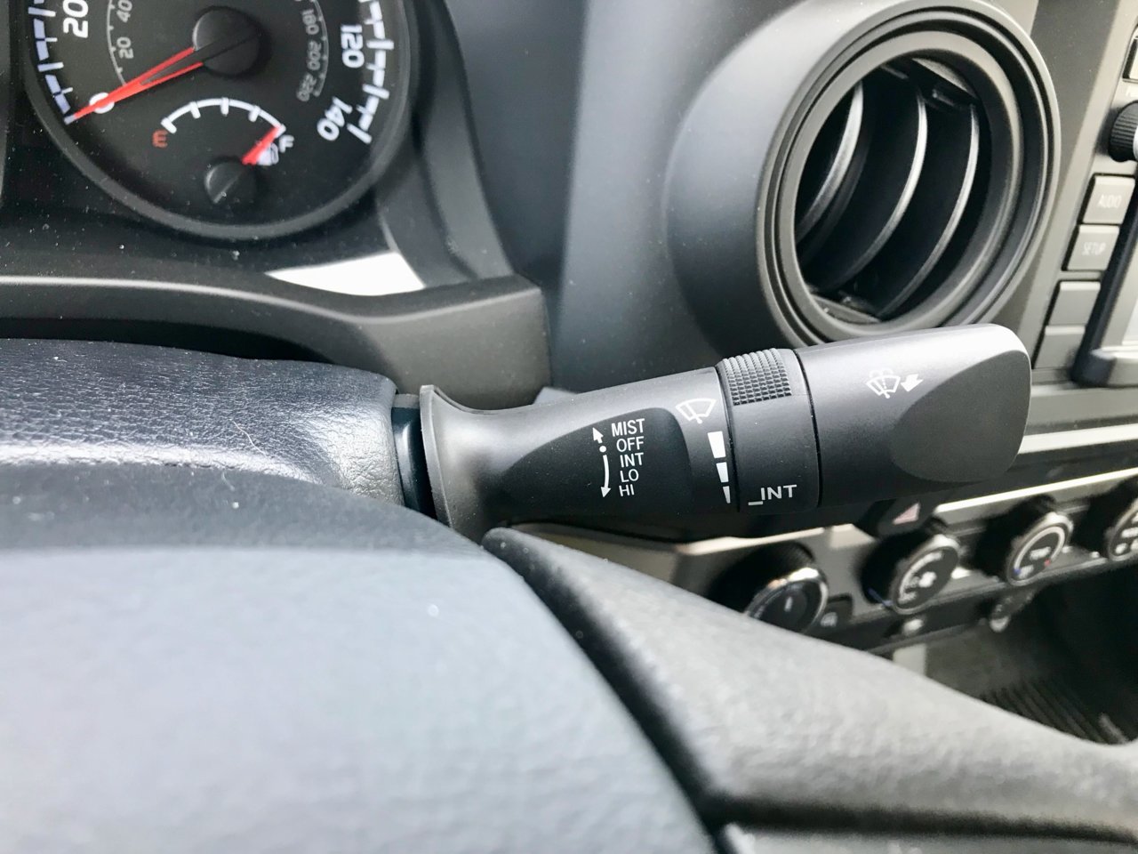

    I have a question, and yes I did read the entire thread. If you can do the intermittent wiper mod simply by installing the correct stalk ( and not removing air bag and steering wheel ), why can't you also simply buy the stalk with the fog light funtion and do the same? ( assuming the SR is indeed prewired for also the fog lights?

    Look at post 201. The wiper stalk is the top right piece and light stalk is the rest.

    Now that I look at the pic better, I see there is no tab to lift up like the wiper stalk. I'll have to check for pre wiring when I do the wiper mod. Thanks for the reply. :thumbsup:

    I don't have the lights yet, but I decided to get a jump on things and at least get the switch in. Yes the truck is pre wired. I did everything like in the first. Problem is the switch has lights when ignition is on, but when I turn on the lights, they go off. Could that have anything to do with not having the actual fog lights connected?
    bcgill likes this.
  19. Apr 6, 2019 at 2:23 PM
    #219
    MagRed
    MagRed Well-Known Member
    Mar 28, 2019
    #288246
    117
    Robert
    2019 SR access cab 4x4
    Ok reversed all 4 wires on the switch, like Nitori told someone in post 115, and almost there! Switch wording (fog light) illuminates when the headlights are turned on, but now , when you press the button, the fog light symbol kind of pulses on and off,????? not really a flicker, but it isn't on all the way. GRRRRRR
    As a side note, I had someone stand by the fuse box while I pressed the fog light switch........ he heard no sound from the relay so I would guess it's not working. ( it was a relay sourced from KIO Auto by cross referencing the Toyota Parts Number) Also hooked up one old Piaa lamp I had and nothing ( I do know they work so it ain't the lamp LOL ) I'm at my wits end. :annoyed:
    Well at least I have a nice new fog light button that almost works......1/2 way there:bananadance:
    All suggestions welcome:hattip:
