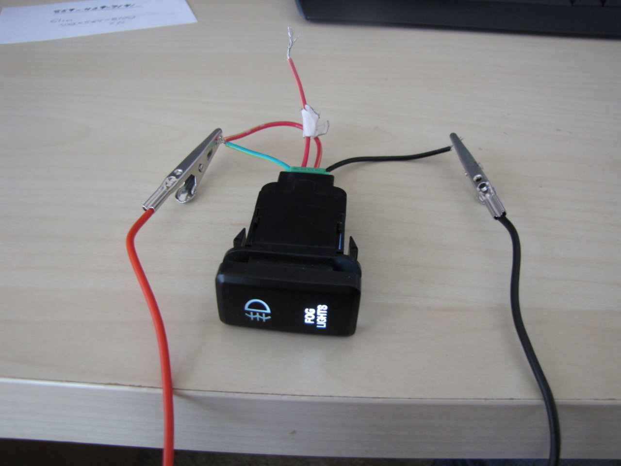

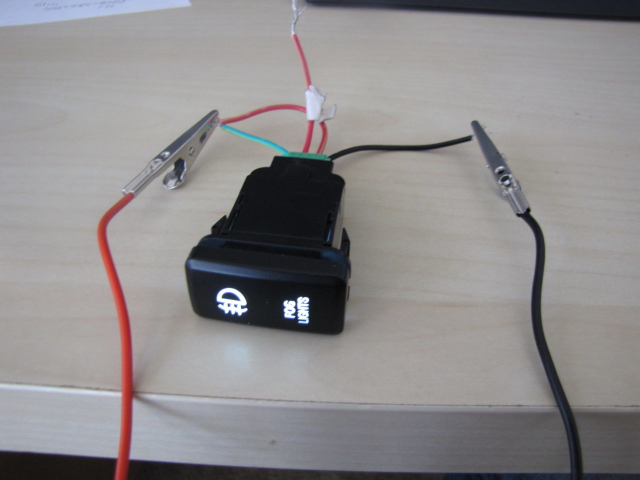

    Started testing the actual fog light switch with a 9 v battery and here is a new development. Started playing with the connections........
    When I hook up the black to negative, and red 2 & green to positive the illumination on the switch seems to work as it should.

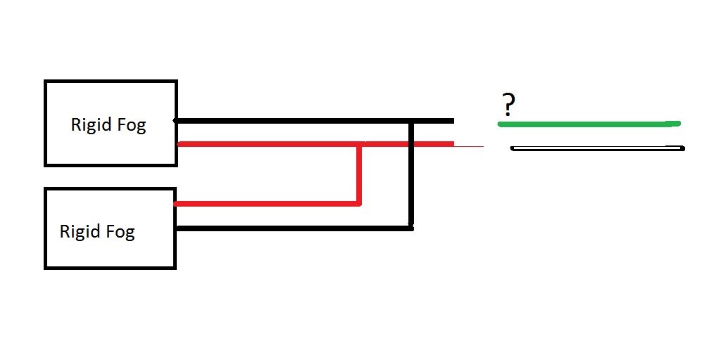

    Factory fog light harness under the hood has a green and a white/blk wire. Does it matter which color wire from the lights connect to?
    So should the remaining red wire connect to the ECU pin 26?

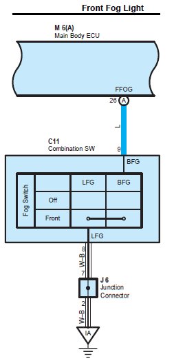

    4- you are not going to get any appreciable power coming out of ECU pin 26. It's not powering anything, it's sensing if the switch has been pressed. So a few microamps to detect a circuit being closed is not going to light a test light.
    What aftermarket switch makers ASSUME is happening is this:
    When you press the fog light switch it completes a positive circuit you've wired to pull power from a 12V switched source, which pulls the coil on the relay and completes a circuit from the battery to light up the lights.
    What is ACTUALLY happening under your dash is this:
    When you press the fog light switch it completes a negative circuit that tells the ECU that the driver has the foglight switch pressed. When the appropriate conditions are met, it illuminates the icon on the dashboard and sends a 12v "go" signal that energizes the fog light relay, completing the circuit from the battery to light up the lights.
    As far as your harness under the hood: GREEN to RED, BLACK to BLACK/WHITE. it will not work the other way.
    So again, take an alligator clip, hook it to the bare wire of ECU pin 26, clip the other side to any convenient ground (metal under the dash), and you should see the dash light come on and the relay energize.
    Once we have localized the problem to your switch (probably is), then we can go through the process of figuring out what pin connects to what other pins, just test which pins have continuity between them with switch on and off.

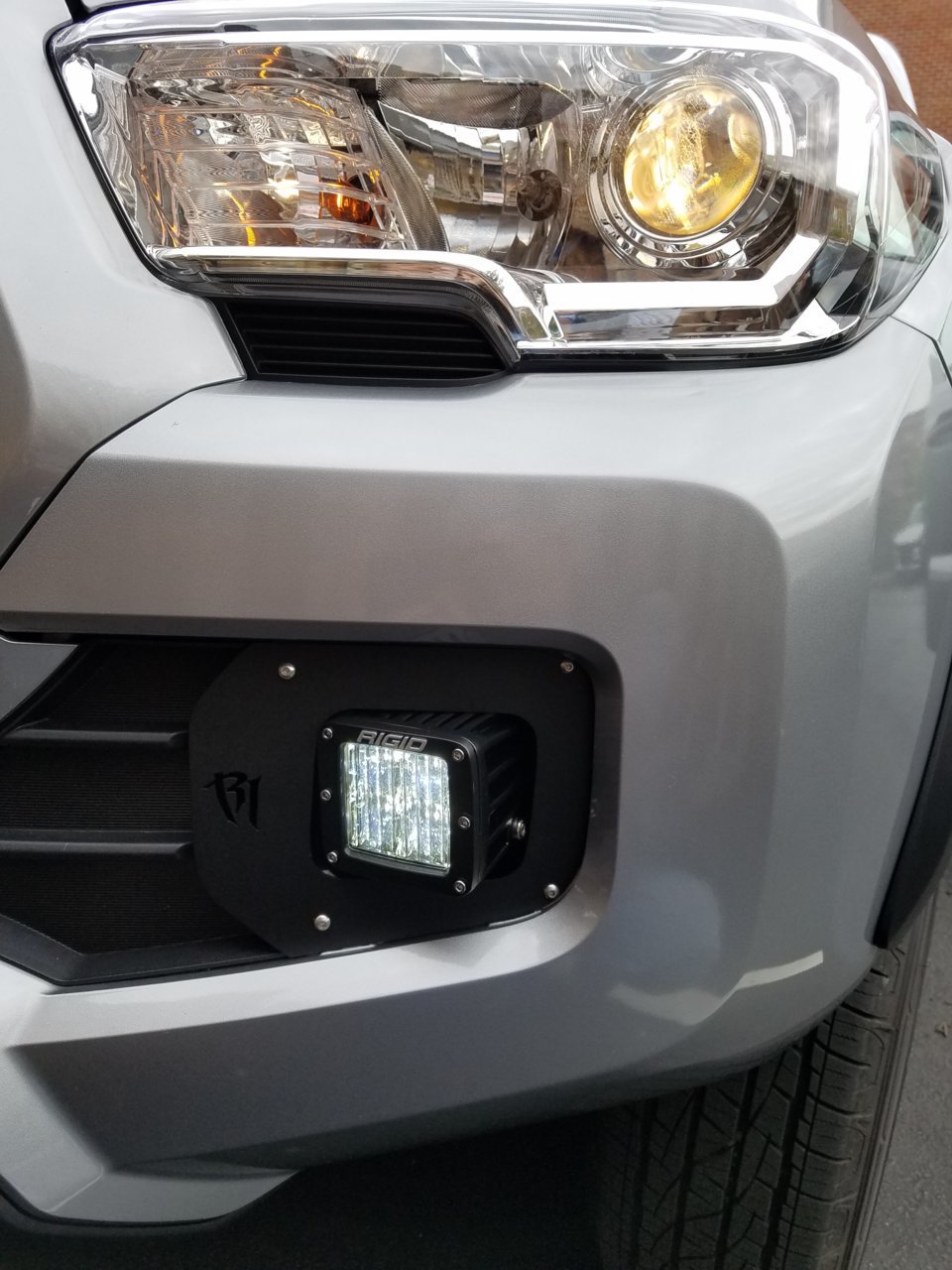

    OK....I feel like we have made a major break through! Connected the Rigid fogs to the factory harness and directly grounded the wire coming off pin 26 of the ECU. And...........................
    Now we have Fog Lights!!!! :bananadance::bananadance::bananadance:They come on with the day time running lights and the low beams. Turn off with the high beams.
    Yeah.....I would like to have a switch of some sort to control them in my perfect world....... but at least they are working!!

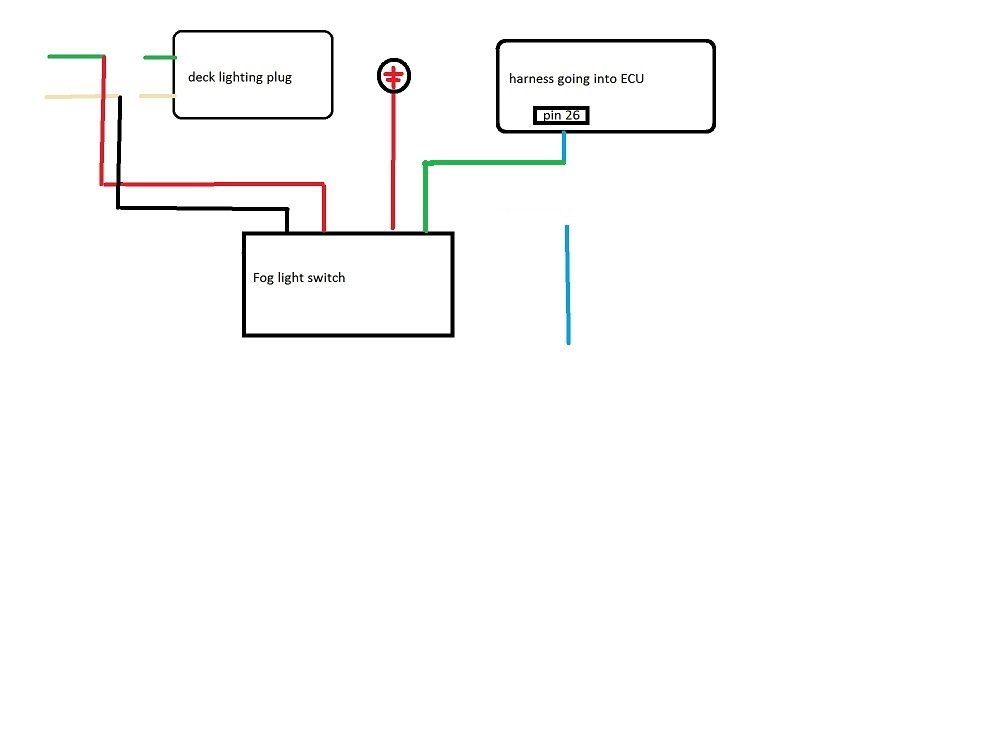

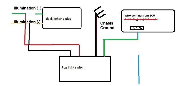

    Unless I am missing something.....that is the same diagram I drew. My switch has black / red 2/ red 1 / green
  11. Apr 10, 2019 at 10:58 AM
    #231

    If you look closer I clarified for others that the Blue is going to ground via the switch. Your drawing shows a red round thing that I saw as a (+) source...

    NO...that was my non engineering degree way of showing a ground on the second red wire. That second drawing wasn't there, or visible when I replied. :)

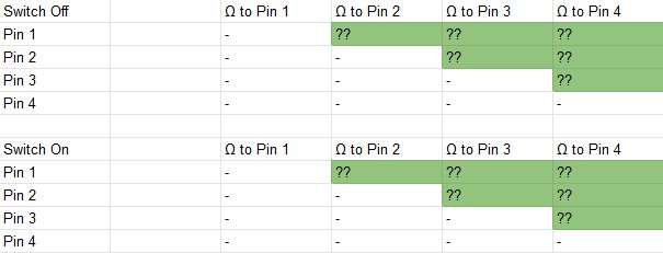

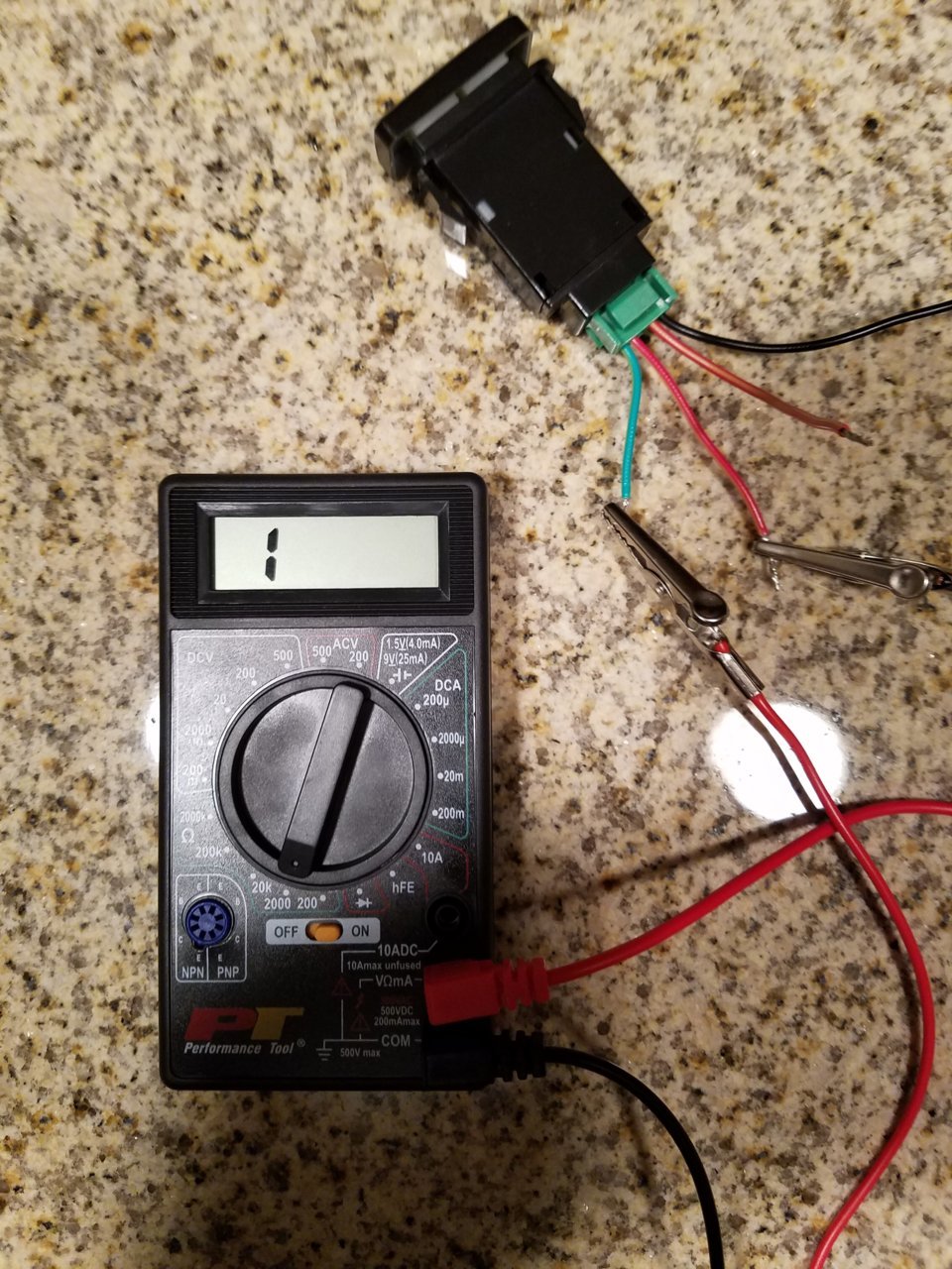

    Okay, so you have your multimeter and you've pulled the switch off the truck, time to make a chart!
    It seems intimidating but there's actually only 6 total continuity measurements you need to take. Measure pin 1-2, 1-3, 1-4, then 2-3, 2-4, then 3-4. When there's no connection just put "Open" or "N/A", and if there is some resistance be sure to mark down how much there actually is, a light circuit will have more resistance than a switch which should have basically none.
    Once you have it done with the switch off, push the switch to the on position and do it again.
    With this info we will lay bare the secrets of the Chinese ebay sellers! :rofl:

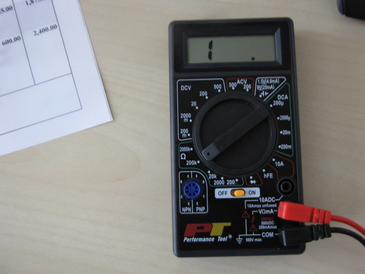

    I guess I should first tell you...................
    I know absolutely nothing about that multimeter:confused: where do I set the switch??
    Also, the wires are G, R, R, B Is G or B pin 1? Or does it even matter?
    Cool....let me have a couple of beers before I get start LOL

    Snug top Rebel, Thule tracks, ditch tracks, Bagged rear suspension, F/R anytime camera, intermittent wiper switch...
    Well, you're in the right part of the meter at least. Set it at 200, if it tops the scale increase the setting until you get a reading that fits the scale you're using. Just correlate g, r, r, b to the numbers and write it in.

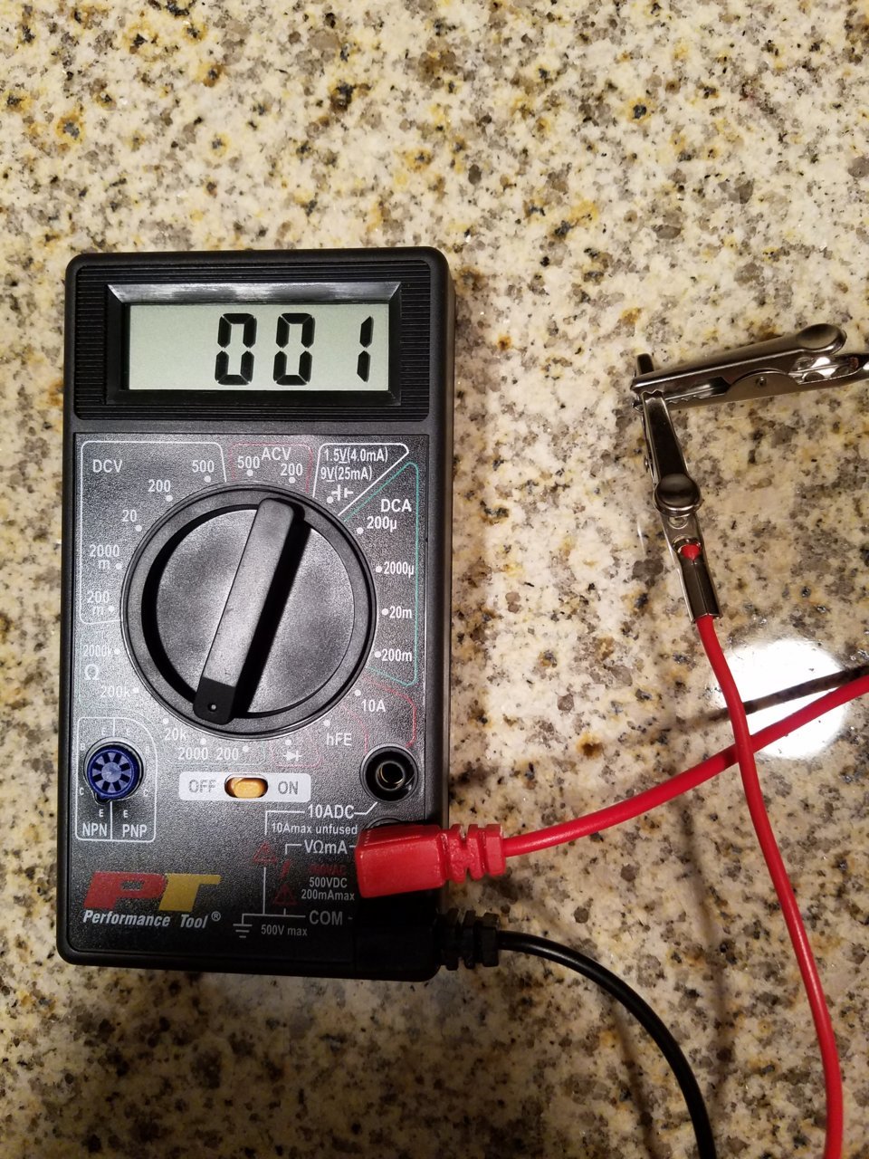

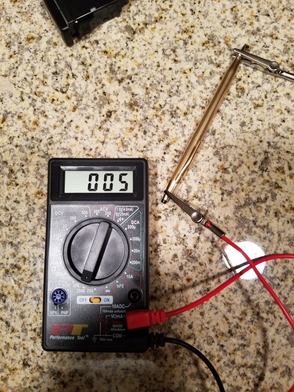

    Not sure if this is a bad switch.....after all the lights operate properly when hooked to a 9v battery.
    but when I checked it as instructed, every possible combination ( switch on or off ) all I got was no reading at all.
    But now I do know that my Cross pen has minimal resistance LOL
    What say you?

    The normal arrangement for that kind of switch is:
    Green = switch out
    Red 1 = switch power in
    Red 2 = illumination power in(oem this power source is active with headlights on)
    Black = illumination ground(provides ground or dimmer ground for switch leds but not part of the switch circuit otherwise).
    Put the clips back on green and red 1 then push the switch a few times. It should alternate between no connection and your lowest reading.
  20. Apr 11, 2019 at 8:13 PM
    #240
    bagleboy
    bagleboy Well-Known Member
    Aug 5, 2017
    #226018
    7,268
    Scott
    Norcal, Santa Rosa
    2014 5-lug AC 2.7L VVTI
    If it doesn't then you have a bad switch or it's not able to push in far enough to click, there's a circuit board inside with a small switch with through hole connections soldered to the board and not much tolerance. If the circuit board doesn't sit quite right in the switch housing, no joy.
