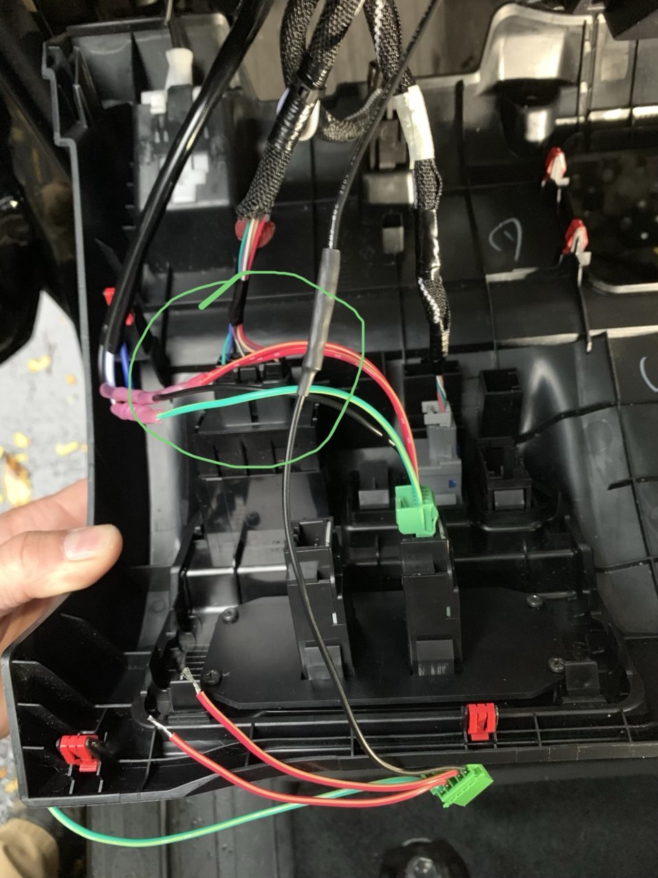

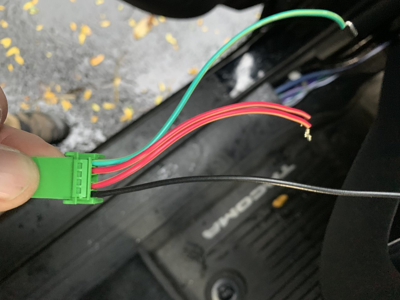

    @Nitori or others, I have a 2018 SR that is not pre wired. I am trying to use a CaliRaised OEM style fog light switch
    Green wire / 2 red wires / black wire
    I don’t seem to have or can’t find the black connector mounted to a dummy on the lower dash panel...is that something others have experienced? This is the connector where we “pirate the wires
    for the switch light” from as stated in the OP.
    I tried just using the power wire to pin 26 To BCM and grounding the switch but no luck. The switch lights up but the fogs do not. I may try a simple toggle switch but would prefer to get to the bottom of this using the switch I purchased.
    Am I missing something?

    And you want to tap the green wire on the deck light (aka bed lights) plug. No need to de-pin, as your plug is plugged in, just tap the wire. I can see the deck light plug on the left side of your photo, still plugged in to the panel.

    Ok, so the “deck light” connector is the back of cab cargo light switch / connector that I circled? If that’s the case, sorry for the confusion on my part. I didn’t realize the deck light and cargo light were one in the same.

    Yup! It confused me to, but Toyota calls the cargo light a deck light.
    So, for your switch:
    Green to pin 26
    Red 1 to ground
    Red 2 to the green wire on the deck/cargo light switch
    Black to ground.

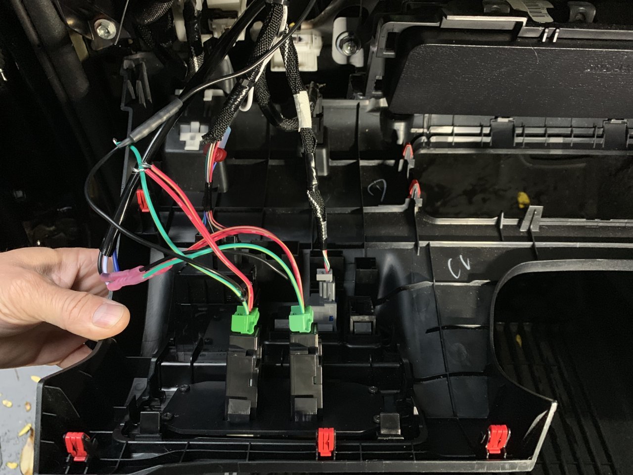

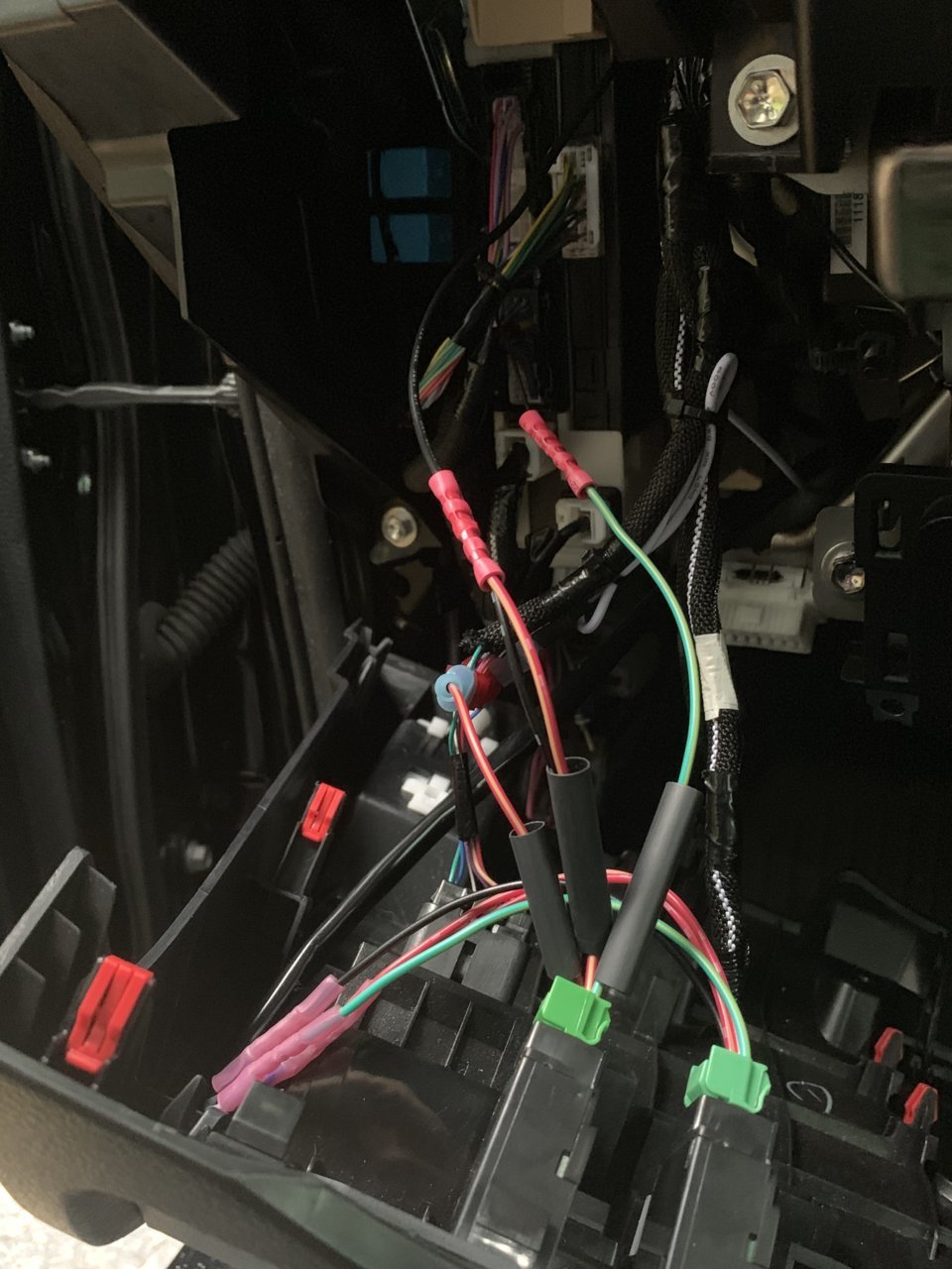

    So I made the adjustments to the wiring....still not working. Is it ok to tie the red ground wire and black ground wire like I did?
    Though the instrument cluster
    now shows the fog light symbol when the switch is active. I swapped the red wires because I didn’t know which is Red 1 / Red 2.

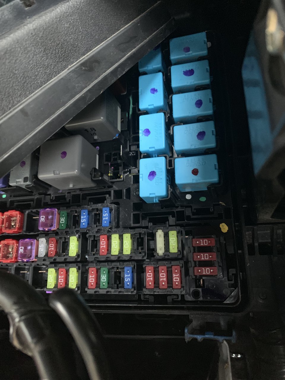

    The blue relay with the red dot is the one I installed. The 15A fuse is not blown.

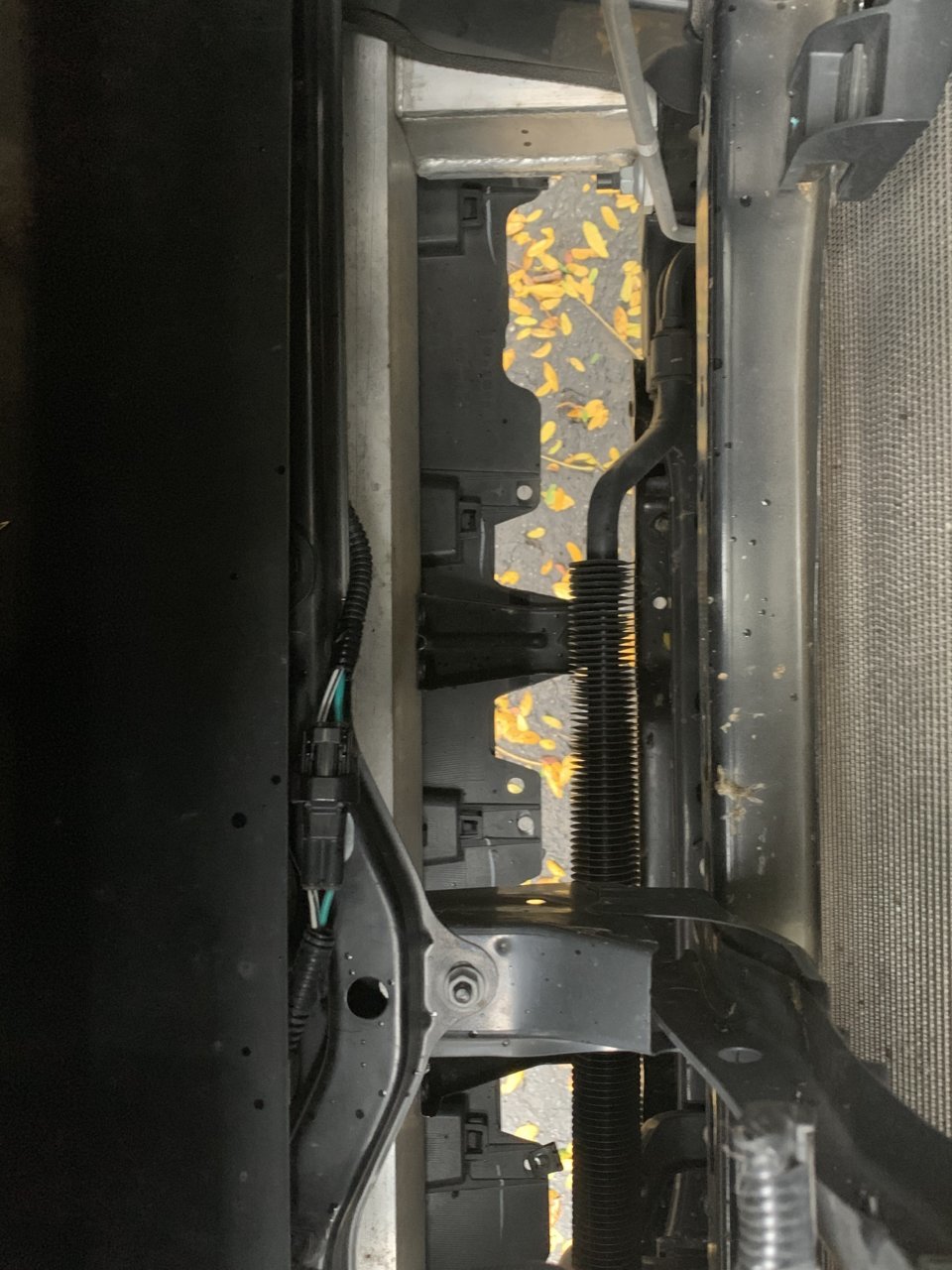

    Just to confirm I connected the fog harness to the proper connector on the body:

    Ok...I got them working. I checked and rechecked everything wiring wise. All was good. With that I re-checked the fuse and relay, I could even hear the relay clicking when activating the switch so I knew all was good. Lastly I disconnected and reconnected the fog harness to body harness connector....I look down and they were on! I don’t know how or why they came on...I can only assume the connector was not positively engaged at the body harness. Stupid mistake and a lot of messing around but all is well that ends well thanks to @skierd for helping with the switch wiring and @Nitori for posting this thread.
