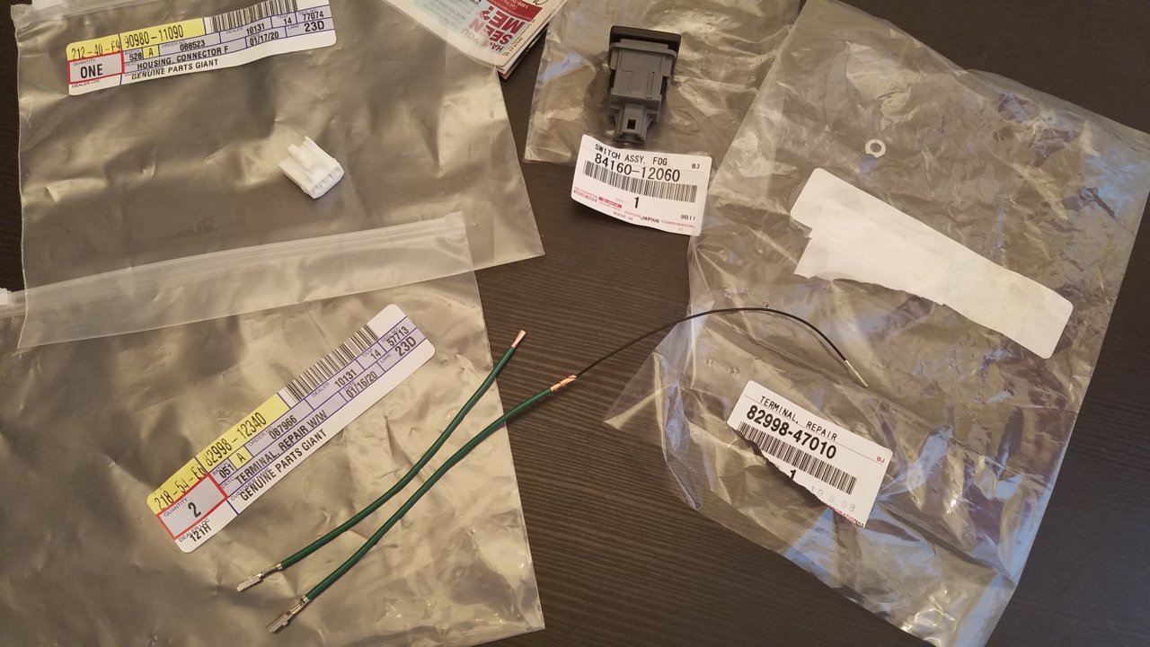

    So I went to final wire everything up, but seem to have hit a few snags. The green repair terminals seem huge like 16ga while the black repair terminal is tiny like 24ga. Is this really correct? I mean it's possible to solder the two together, but it just seems awful strange that this is the solution. Also, someone mentioned that the switch from the scions fit, but there is no way the white connector is fitting in there. Does anyone know the correct part # for the male connector and if the repair terminals fit? All of these parts are OEM, but something is definitely hinky. I'd like to get my fogs added soon, so any help is appreciated.

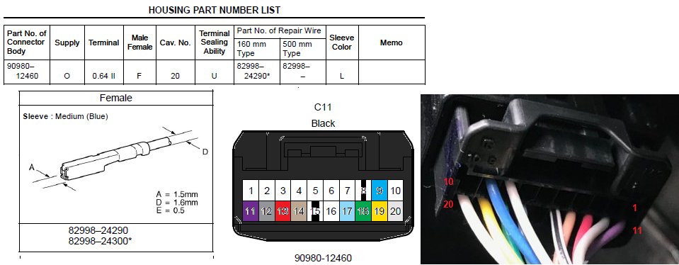

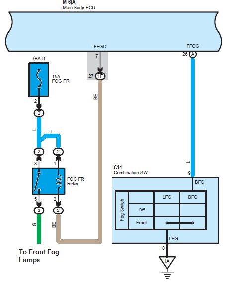

    I have a non-prewired Tacoma and I installed the OEM fog light stalk. I'm working on the wiring. Do you know where the extra two wires at pin 8 & 9 connect to? Based on the research, one wire should connect pin 26 of the ECU connector. I don't know which pins.

    If I remember correctly pin 9 goes to the ECU from the factory, but in this case it shouldn't matter because it's a simple ground switch and that means there is no polarity. (imagine the stalk switch is basically touching 2 wires together to complete a circuit)

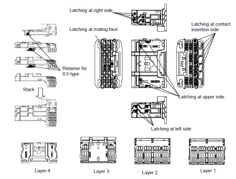

    Didya read the PDF? it has the info on the M6 connector disassembly. I know it's late but....

    C11_9 goes to M6 26...Look at post #1
    C11_8 is any ground really....

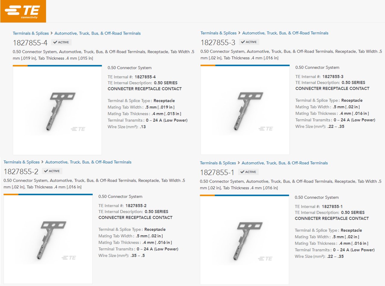

    Great!!! Any source where I can buy the two repair terminals. I searched for 0.64II on corsa-technic but couldn't find it.
