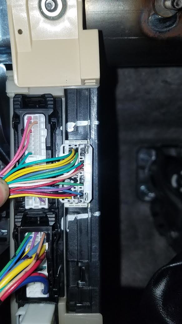

    2020 SR. Well the white connector in the dash has different pin out configuration. Different colors, different slots used and empty. I metered the fuse box fog relay to the dash connector and found no connection on any pin. The wires to the front from ground and the fuse box relay output do have continuity.
    Where might I get a schematic?

    It be nice if you placed a pic. You might have ID'd a different connector...

    2020 SR Now when I compare to Nitro's picture it looks the same o_O.
    What confused me is the shots with the connector apart. The connector is held upside down in relation to how it plugs in.
    I can report that this works just fine for the 2020 SR.

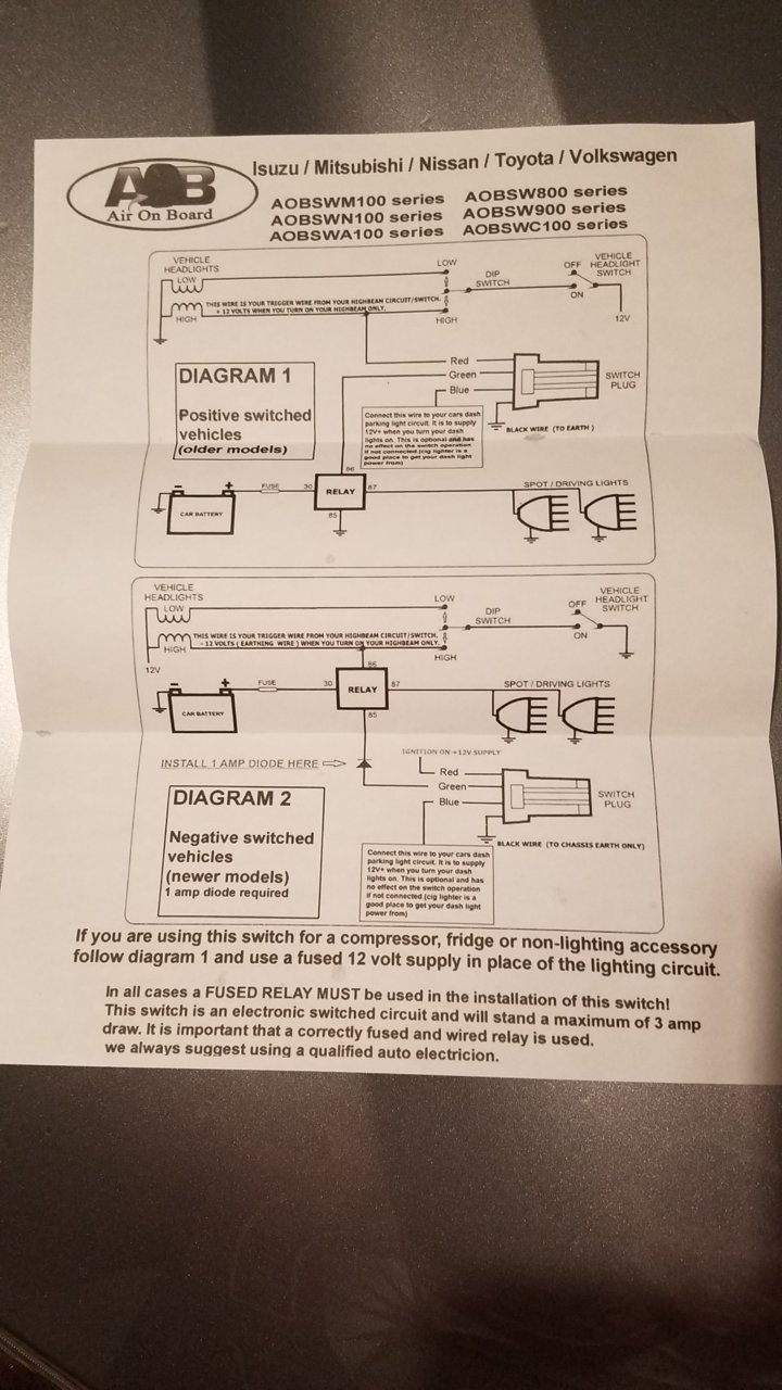

    For whatever reason, the tan and green wires have to be used in order for the switch to dim with the other dash lights. If I just use green for power and grounded the other wire it wouldn't dim.
    The Fog light symbol is pretty dim, which is fine, but the FOG LIGHTS writing is too bright. I may try to add an inline resistor to drop the current to the added switch night lighting.
    I have the mictuning switch, but that's the seller not the brand I think. Its the same as the other ones I ordered. Its a deep blue and not the light cornflower blue of the stock buttons. I ordered several different ones including the iztor, its all about the same.
    https://www.ebay.com/itm/12V-Blue-LED-Fog-Light-Bar-Push-Switch-fit-Toyota-Tacoma-4Runner-FJ-Cruiser/264298086361?ssPageName=STRK%3AMEBIDX%3AIT&_trksid=p2057872.m2749.l2649
    https://www.ebay.com/itm/3A-Car-Pus...var=522530538133&_trksid=p2057872.m2749.l2649
    https://www.amazon.com/gp/product/B01MY0TKJC/ref=ppx_yo_dt_b_asin_title_o08_s00?ie=UTF8&psc=1

    https://www.amazon.com/gp/product/B01G1QZ6MS/ref=ppx_yo_dt_b_asin_title_o00_s00?ie=UTF8&psc=1
    Circuit board design is probably the same but Im not sure.What lights up when you have your fog lights on, the “Fog Lights” LED only, or both the “Fog Lights” LED and the bulb symbol LED? Edit: I see you said your bulb symbol was dim, that could just be light being emitted from the bright “Fog light” text LED below, is the bulb symbol dimly lit even with the button not pushed (fog lights off)? How do you have the four switch wires wired up?
    Green to -
    Red 1 (beside the green wire) to-
    Red 2 (beside the black wire) to-
    Black to -
    I plan to install my fog lights this weekend and my current plan is to wire as follows:
    Switch wires
    Green- to M6 ECU connector to pin 26 which I will install (equal to your light stalk blue wire connection)
    Red 1 - ground
    Red 2 - cargo/deck connector green wire (Illum +)
    Black - cargo/deck connector tan wire (Illum-)
    Agree with you the only thing that really matters is your fog lights come on and your dash indicator lights when you push the button. The engineer in me though is forcing me to make that switch bulb symbol light up properly too because... it’s there. Lol :D

    Nothing lights up. The switch is only illuminated when the headlight stalk is turned on.
    When I push the button the fog light green icon appears in the instrument cluster next to the headlight icon.
    1) Green to blue headlight wire in steering column
    2) Red 1 to ground
    3) Red 2 to green illumination wire
    4) Black to tan illumination wire
    There is only one LED in the switch and no wiring to allow a second one.
    davidstacoma likes this.
