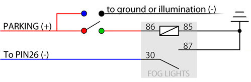

    You can also wire the switch to activate a relay, with pin 30 to ground and pin 87 to the tapped wire. This would light up the top LED when activated, and send ground to the tapped wire 26. That is how I am doing mine.

    I can tell you from personal experience, that fifth pin is not hooked to anything. The reason it wont illuminate the top LED is that the top LED uses the load wire (green) for the + input on the LED.
    If you were to say, wire it backwards, like swapping - and +, so that the green would be delivering a - and the black would be +, so that when the circuit between line and load is closed, it would deliver - to the LED and load. Problem there is that the anode and cathode would be backwards, and the resistor would be post LED, so you'd burn up the LED.
    So the way you want it to work cant be done without rebuilding the switch. That can be done and I can explain how to do it, but you'll need to solder, and it gets funky. I did this for a defroster that I am installing, and also changed the top LED to Amber. So the switch is light blue, and when pressed, the top graphic lights up amber, the bottom text stays blue, and the defroster turns on. After the defroster times out, the amber light shuts off. Sounds simple enough, until you have to add the 5th unused wire, resolder the LED and resistor, and jump a ground. Not worth the effort if you're a sane person....
    So here is the simple way around it:
    You just need a simple 4 pin NO relay.

    Boring update later. If I reverse the polarity on the switch and send power TO the relay instead of grounding it, then the second LED works, so I will have to find a good switched +12v in the cabin and then run that to the switches.
    I think I will lose the dimming control from the ECU, but that's fine with me. I hooked up the interior lighting lead from the bed light switch to a small .5a inline relay and had a rheostat laying around from a previous daft punk helmet project so I can dial in the brightness just the way I want it on the additional switches.
    Now I am retrofitting the two cornflower blue LEDs from the air onboard switch to the over-sized mic-tuning Blue LED Fog switch. Adding in another .5a relay to change it from providing power to the headlight pin in the ECU to giving it ground. So now BOTH leds work across the board, but I have a power wire running across the hood into the cabin while I'm testing everything out and haven't started hunting for a power source.

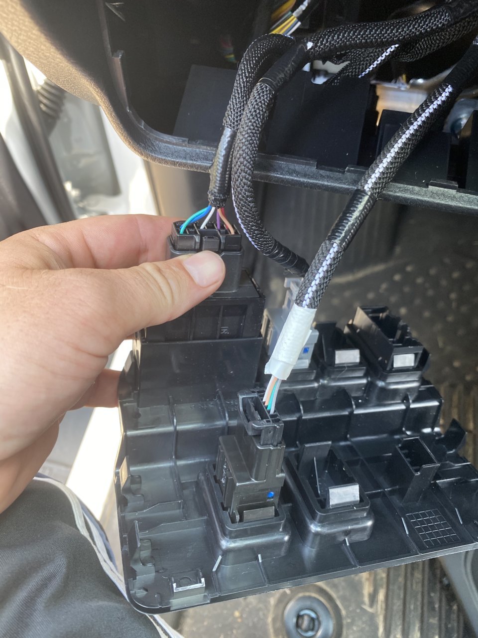

    So I’m trying to wire up my 2020 SR and I will already have to tap into the Blue wire on pin 26. The question is pulling power for the switch. The cargo/deck plug is already being used, bed lights came pre-installed. Would I need to tap into those or is there somewhere else I can draw power from for the dash switch?

    Blue is a ground. What switch are you going to use?

    I’m planning to use a dash switch, one of the ones used in the thread. The plug I’m holding is the cargo/deck plug, where others have plugged into for the power to the switch.

    upload_2020-7-18_15-16-52.jpg None of those wires are for "pulling" power.
    Green (+) switch illumination.
    Tan (-) Switch illumination - not to be used, unless the added switch has independent illumination bulbs.
    White with Black runner/stripe - Ground
    Blue - Purple - Red: don't mess with them for this install.
    So again, what switch are you using/adding?
    ExplorHer likes this.

    You can check his post history, but @caribe makaira is well versed in the Tacoma's electrical systems. He's trying to help you from causing damage to your truck.

    I guess “pulling” is the wrong term. I’m going to use one of the mictune dash switches with the universal plug. I know the green will go to pin 26, but the red 1, red 2, and black wires from the plug are where I’m trying to figure out the placement. Others have used the cargo/deck plug since it was unused. Mine is already used for the factory bed lights. If I need to tap into that I can, but I’m just looking at other options before I start splicing wires.
