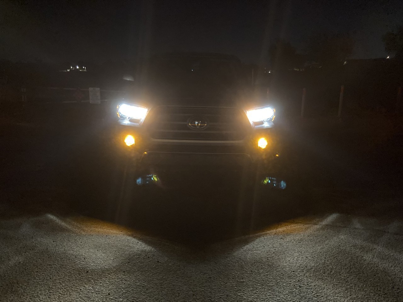

    I am not mechanically inclined whatsoever, so even successfully taking the air dam off was a confidence booster for me. I finished this install with the amber Morimoto's last night. I still have a couple tweaks to make, but everything works and I didn't royally f-up my beloved Taco. Thanks to everyone on this thread!

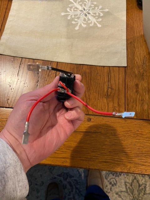

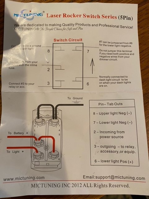

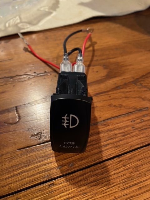

    Deleted post as I received the wrong switch from mictuning which caused the confusion on my part.....

    Are you attempting this mod or just wanting to add fogs and picked this thread to ask? There’s a big difference in how to connect this or another switch. Op has the details for this mod and an oem switch but it sounds like you need to read it again, maybe a few times.(sorry if this sounds mean but it often takes a few readings for it to click). This mod uses the switch to connect a computer terminal to ground. It doesn’t actually connect to the fog lights at all. Buried in the thread are discussions of the problem using an aftermarket switch instead(because of how the leds are wired inside aftermarket switches). There are other threads detailing anytime fog lights or how to wire something so it only comes on w/high beams using aftermarket switches.

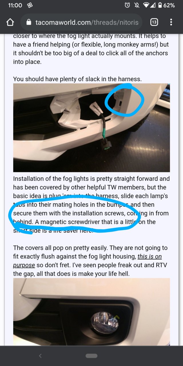

    Does anyone know what screws I can use to mount the fogs to the truck body?

    Plastic screws are similar to pan head wood screws but with a blunt tip. #8 is close. You might find them at an automotive outlet.
