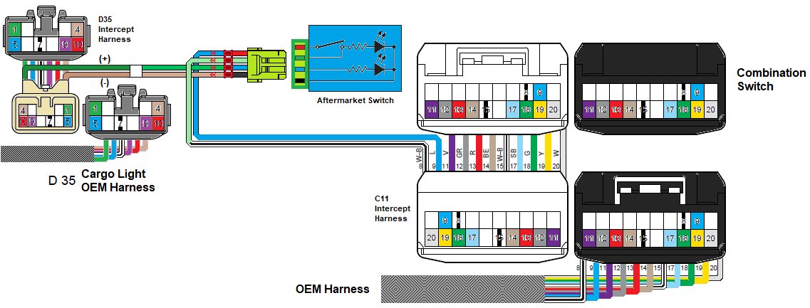

    caribe makaira
    caribe makaira Well-Known Member
    Feb 13, 2011
    #51121
    11,814
    Caribbean, Puerto Rico
    05 PreRunner TRD Offroad AutoTrans
    Hood Struts, My version Fogs always ON, Map & Overhead Light Mod,
    You have this option if the remove & replace combination switch is too much.

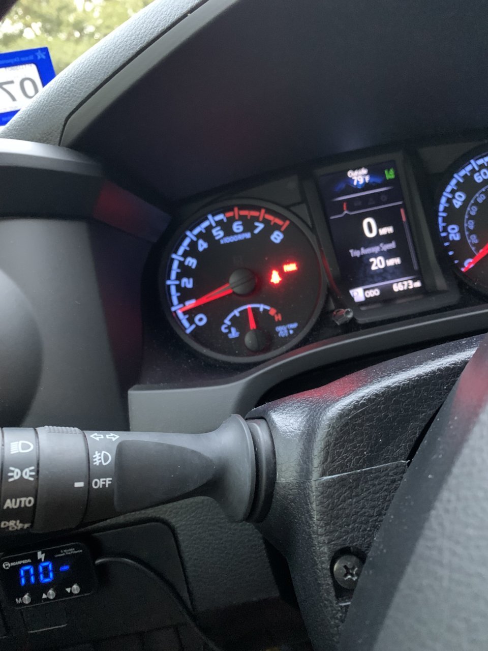

    Did the steering wheel removal method on my 21 SR. now I'm getting pre-collision system errors, lane departure error, and headlight system error. headlight could be that I don't have the lights in. Any thoughts on what's up and how to fix it? Drove the truck around town and it drives fine, just getting the error messages.
  14. Oct 30, 2021 at 11:54 AM
    #594
    907rx7
    907rx7 Well-Known Member
    Jul 1, 2019
    #298028
    1,695
    James
    '20 Tacoma DCSB SR 4x4
    Disconnect negative battery terminal for 10 minutes and reconnect perhaps?

  16. Oct 30, 2021 at 11:58 AM
    #596
    907rx7
    Jul 1, 2019
    #298028
    1,695
    James
    I would check to make sure the connector on the TSS sensor is seated too.
    I think Lane departure only uses the window camera though not the TSS sensor.
    Do your horn and all of your steering wheel controls work?
  17. Oct 30, 2021 at 12:13 PM
    #597
    MNFinn7300
    MNFinn7300 Well-Known Member
    Jul 1, 2021
    #370086
    492
    Erik
    2021 Tacoma SR DCSBV6
    Softopper, Diode Dynamics Fog lights, BD Spot lights
    Horn works, light controls work, windshield wipers work. I mixed up the errors, it's pre-collision system, stability control, LDA and headlights. Truck drives fine, took it for a spin to check that out.
  18. Oct 30, 2021 at 2:21 PM
    #598
    MNFinn7300
    Jul 1, 2021
    #370086
    492
    Erik
    hanging my head in shame. started tearing down the whole thing to put the old stalk in. Got the airbag out, the wheel off and the covers for the column off. started on the clips for the clockspring and found the one connector I neglected to reconnect when I buttoned things up. connected that and BOOM, no warnings when I got it all back together and turned the truck on.

  19. Oct 30, 2021 at 3:01 PM
    #599
    caribe makaira
    Feb 13, 2011
    #51121
    11,814
    That is what you had to do, return to prior status. Great that it wasn't worse.
  20. Oct 30, 2021 at 3:05 PM
    #600
    MNFinn7300
    Jul 1, 2021
    #370086
    492
    Erik
    ya. Good news it was just the one connector. new stalk is working so it's just the waiting game waiting for the lights to come in.
