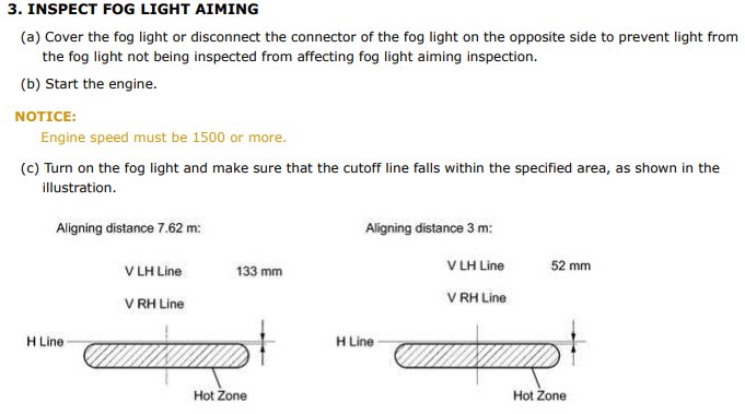

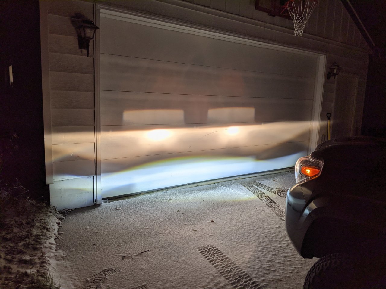

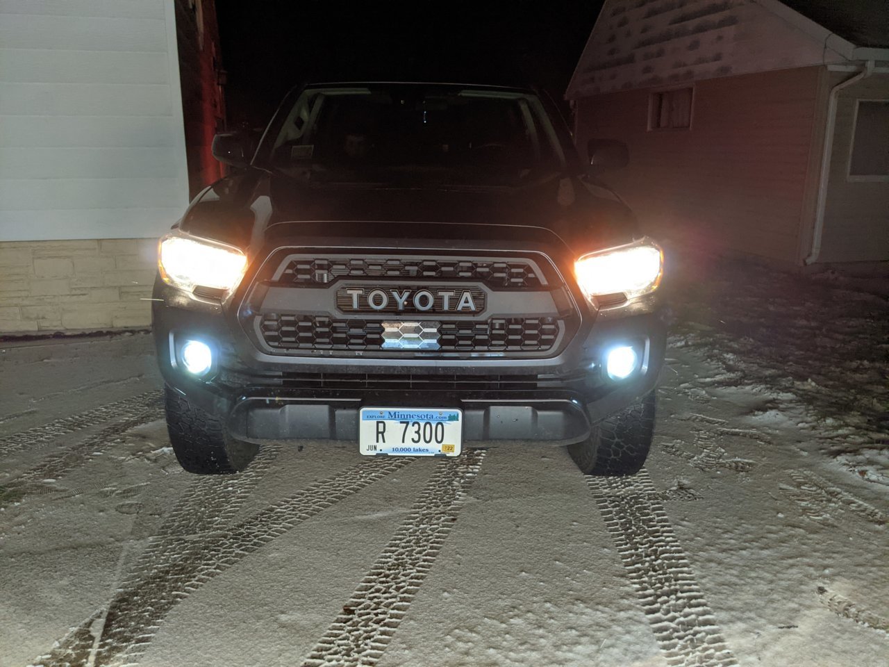

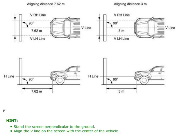

    Lights themselves went in today. Nice having them, though I'm not sure if they are aimed quite right.

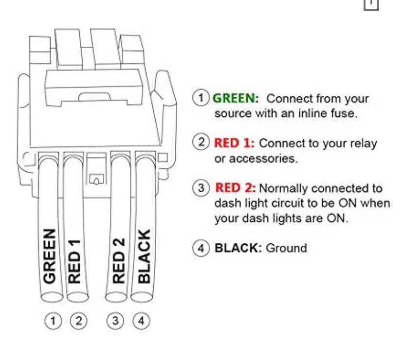

    I know I will probably be told to re-read the beginning of this thread, but I could really use some clarification on the wiring for a mic tuning switch i got. I am pre-wired and have installed my fogs but I just need to get the switch in. I'm planning on just tapping into the correct wires once I figure that out. Below is the diagram for the switch I have;
    From what I've read i think green goes to the pin 26 and then red 1 grounds on the dash bolt? Is that correct? Also is there any better place to ground that red 1 or is the dash bolt fine?
    Then I think red 2 and black are for the switch's backlight, so red 2 to green on the deck lighting plug? and ground to beige on the deck lighting? or dash bolt?
    I know I probably sound repetitive since all the info is there I just need clarification to be sure and not fuck anything up. I'm more visual and haven't been able to find pictures to get it straight in my head so thanks for any help.

    Correct
    Correct

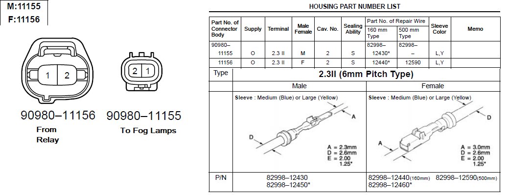

  6. Nov 17, 2021 at 8:41 PM
    #606
    taco_matters
    taco_matters Member
    Apr 29, 2019
    #291777
    16
    2018 Black Tacoma SR
    Thanks I’ve got the switch all set now. fogs work and the dash indicator comes on.
    Although I discovered I have a bad connector where the fog harness links to the main harness that was pre-installed.
    Looking around for a part number to swap that out but otherwise good for now with zip ties holding the connector just right
  7. Nov 17, 2021 at 8:44 PM
    #607
    caribe makaira
    caribe makaira Well-Known Member
    Feb 13, 2011
    #51121
    11,814
    Caribbean, Puerto Rico
    05 PreRunner TRD Offroad AutoTrans
    Hood Struts, My version Fogs always ON, Map & Overhead Light Mod,
    This connector?
  8. Nov 17, 2021 at 8:52 PM
    #608
    taco_matters
    taco_matters Member
    Apr 29, 2019
    #291777
    16
    Yessir thats the one. I think its the female side thats giving me issues but thinking i should look for both sides of it if possible
  9. Nov 17, 2021 at 8:53 PM
    #609
    caribe makaira
    Feb 13, 2011
    #51121
    11,814
    taco_matters[QUOTED] likes this.
