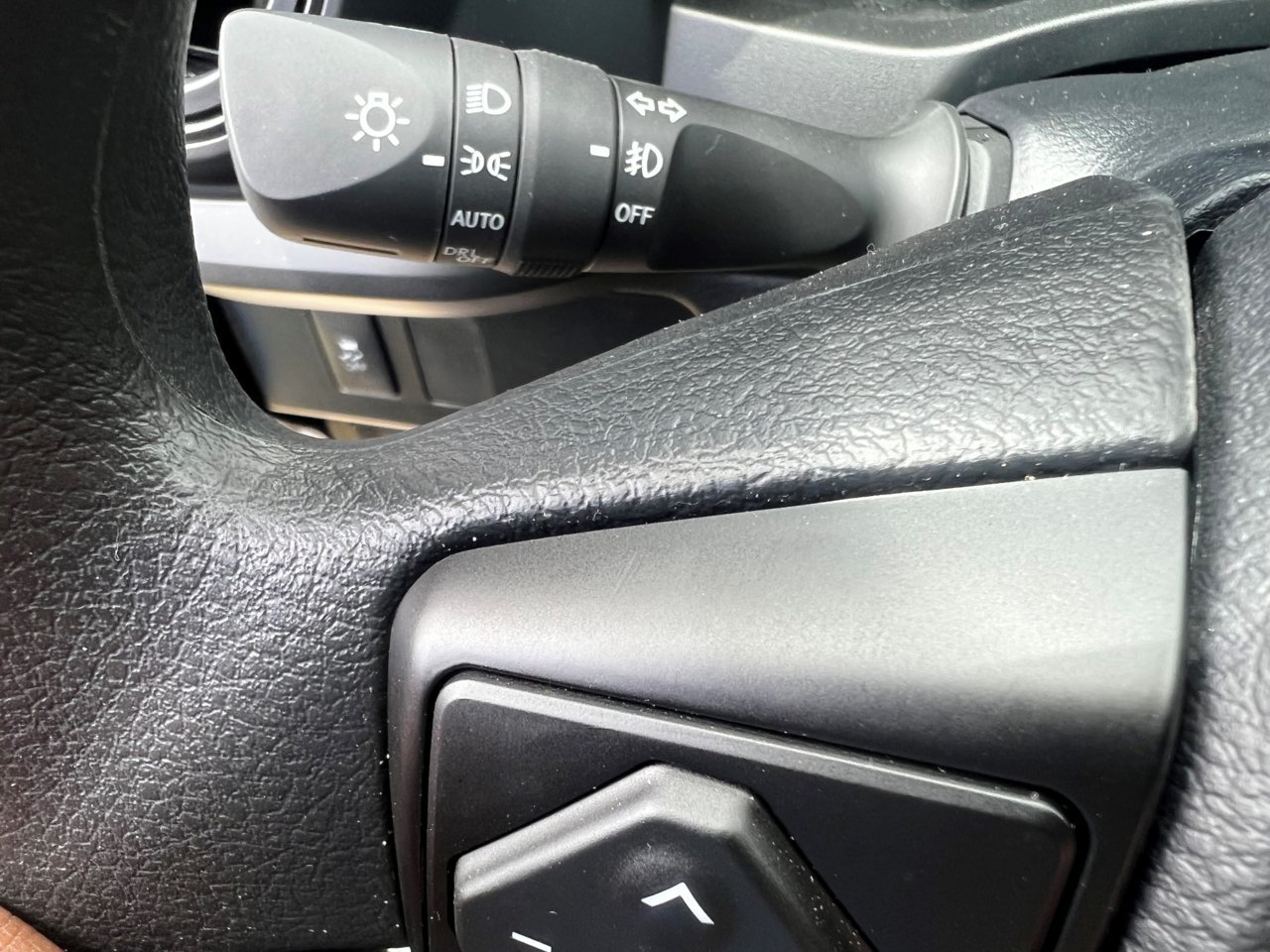

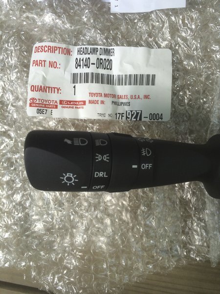

    Has anyone done the stalk swap recently on a 2022 SR, do you need 84140-0R010 or 84140-ORO20?
    My 2022 has:
    • Auto Off Projector Beam Halogen Daytime Running Auto High-Beam Headlamps
  8. May 11, 2022 at 6:46 PM
    #688
    caribe makaira
    caribe makaira Well-Known Member
    Feb 13, 2011
    #51121
    11,817
    Caribbean, Puerto Rico
    05 PreRunner TRD Offroad AutoTrans
    Hood Struts, My version Fogs always ON, Map & Overhead Light Mod,
    The Auto OFF substitute the DRL on/off feature on your Tacoma version.
    DawgFan1980[QUOTED] likes this.
  9. May 11, 2022 at 7:17 PM
    #689
    DawgFan1980
    DawgFan1980 Member
    May 2, 2022
    #396332
    20
    2022 SR V6 4x4
    So I guess I should stick with 84140-0R020.
  10. May 11, 2022 at 7:33 PM
    #690
    caribe makaira
    Feb 13, 2011
    #51121
    11,817

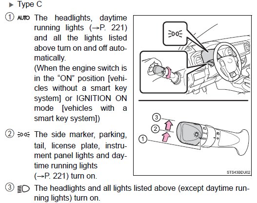

    According to this:
    It would the wrong one. I'd say you'll require the 0R010 since you have the auto headlight off feature.
  11. May 14, 2022 at 9:04 PM
    #691
    DawgFan1980
    DawgFan1980 Member
    May 2, 2022
    #396332
    20
    2022 SR V6 4x4
    Thanks for all the help!
    Before:
    After:

    Didya test the light positions? What part# did you use?
  13. May 14, 2022 at 10:42 PM
    #693
    DawgFan1980
    DawgFan1980 Member
    May 2, 2022
    #396332
    20
    2022 SR V6 4x4
    I used 84140-0R010, everything works perfectly. I have a brand new OEM 84140-0R020 still in bubble wrap if anyone is looking, I had ordered both just in case.
  14. May 14, 2022 at 10:43 PM
    #694
    caribe makaira
    Feb 13, 2011
    #51121
    11,817
    So in your SR you can turn OFF the DRL's via the light stalk AND have AUTO lights?
  15. May 14, 2022 at 10:49 PM
    #695
    DawgFan1980
    DawgFan1980 Member
    May 2, 2022
    #396332
    20
    2022 SR V6 4x4
    Yes, pretty sure I have full functionality on my '22. Will double check again in the morning.
  16. May 14, 2022 at 10:49 PM
    #696
    caribe makaira
    Feb 13, 2011
    #51121
    11,817
    :popcorn:
  17. May 14, 2022 at 11:05 PM
    #697
    DawgFan1980
    DawgFan1980 Member
    May 2, 2022
    #396332
    20
    2022 SR V6 4x4
    Just ran outside to check... yes it all works. I can turn turn off the DRL and Auto definitely works. I believe DRL has to be on for fogs, but I think that's normal.
  18. May 14, 2022 at 11:08 PM
    #698
    caribe makaira
    Feb 13, 2011
    #51121
    11,817
    Parking needs to be ON for fogs.
    Turn vehicle ON, place light stalk in DRL OFF, release parking brake then set it again. Verify if DRL's are OFF.
  19. May 14, 2022 at 11:33 PM
    #699
    DawgFan1980
    DawgFan1980 Member
    May 2, 2022
    #396332
    20
    2022 SR V6 4x4
    Unsure about the sequence you mentioned, nothing changed... but when I turn off DRL's everything is off on the front. If I switch to Auto the lights come on with the Fogs. DRL has to be on for Fogs to be on.
  20. May 14, 2022 at 11:41 PM
    #700
    caribe makaira
    Feb 13, 2011
    #51121
    11,817
    Maybe 2020 SR is VERY different, the DRL doesn't turn ON unless the parking brake is released while the vehicle is ON. The test is to verify that the new stalk is doing more than it should.
    Stalk in the ALL OFF, vehicle ON, parking brake released then set again. Verify if the DRL stay OFF.
