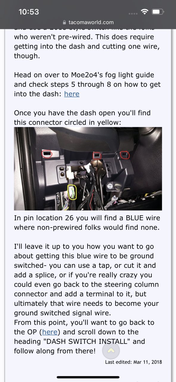

    I’m confused on how I make this green wire “switched to ground”

    It means that an added switch completes ground. The stalk on steering or the added switch will do that.

    How did you end up wiring this? I have the same truck and year as you. I’d like to add a switch that is lit up. We’re you able to do this install just like the post shows?

    Guess I’m confused on how to tap it or use a splice. I’d prefer to just add the switch to the dash that lights up rather than pulling steering wheel and ordering more parts for it.

    Red box shows combination switch at the steering wheel. blue wire (+) from control ECU to switch to ground. An added aftermarket switch would do the same.

    It's a very small gauge wire. You need the smallest crimp barrel (insulated) wired to the "IN" of the switch, then the "OUT" of the switch to chassis ground (bolt)

    @LifeAngler, have you verified your Taco does have the blue wire going into the steering column?
