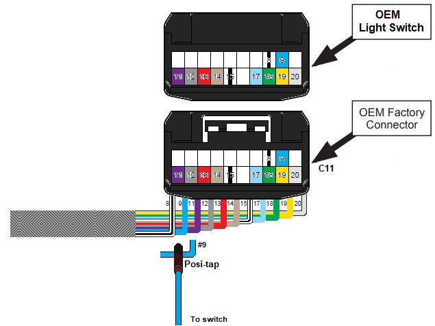

    Ok so cut wire, one end goes to the switch (which I will ground somewhere) and where does the other end go? Almost need a pic for this to make sense lol.

    Other end?
    If you do have the blue wire going to the steering column connector (C11) the t-tap it. Don't cut it.

    Ok I found a pic of the t tap earlier in this post. Thank you. I have a bed light switch so will I need to grab power from somewhere else to get the light to work on the switch? Also have you found anything that looks better than the 2nd hen switch that will be easy enough to connect to the t tap as well as get power to light it up. Appreciate your help. This is SLOWLY starting to make a little more sense.

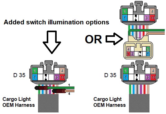

  7. Sep 21, 2022 at 9:15 AM

  9. Sep 21, 2022 at 9:28 AM
    #749
    LifeAngler
    LifeAngler Well-Known Member
    Aug 13, 2022
    #403470
    54
    Shane
    2022 Tacoma SR double cab 4x4
    Wish I understood these diagrams. So am I still pulling power from the cargo harness?

    Caribbean, Puerto Rico
    05 PreRunner TRD Offroad AutoTrans
    Hood Struts, My version Fogs always ON, Map & Overhead Light Mod,
    Yes, just illumination to the added switch. It'll dim with the other dash switches.

    Appreciate it. I’ll probably order that harness if it makes my life any easier then
    It’ll be worth it.
