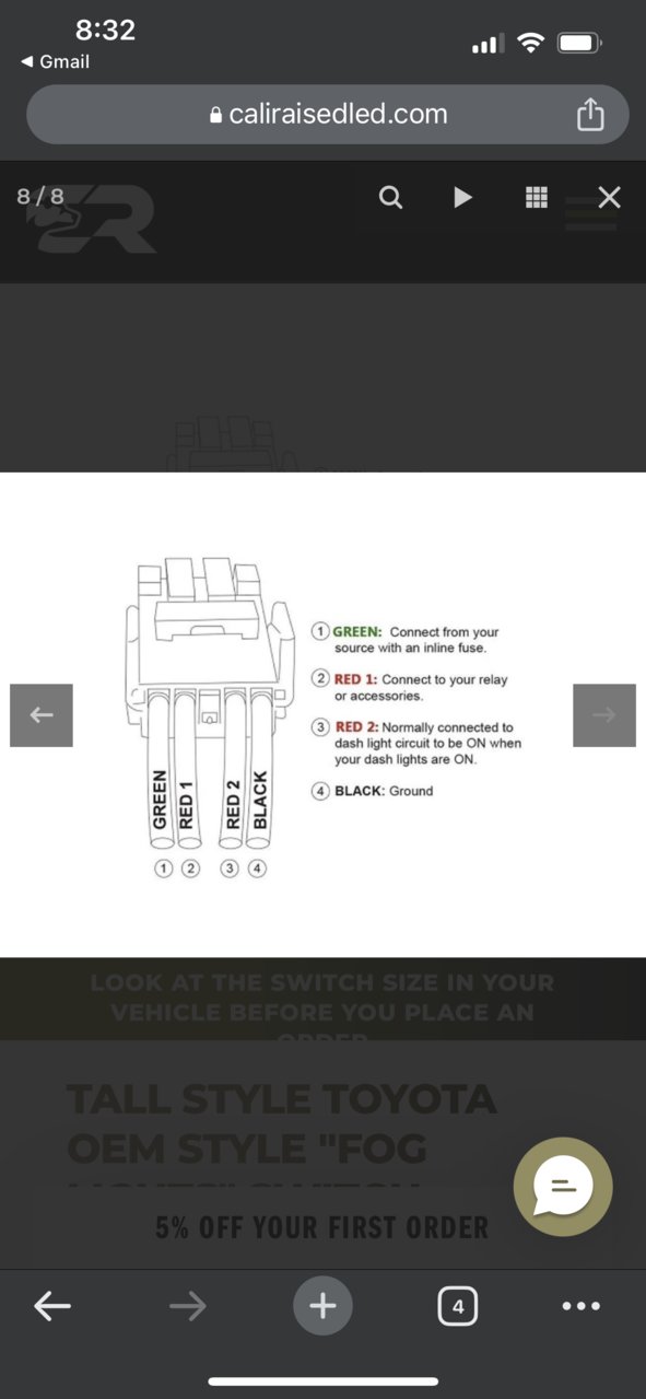

    The switch cycles fine according to an ohmmeter.
    From what I can conclude from setting up a test circuit. The only configuration that works with batteries and a test light bulb is. Illumination Power source + to green wire and - to black wire. (Outside pair)
    Light source power + to red 1 and - to light bulb, lead from light bulb to red 2.
    What I call working is -
    Switch off - light bulb is off and only the word fog light is lit on switch.
    Switch on - light bulb turns on and the word fog light and indicator on top of the bulb is illuminated.
    Using the Cali Raised Illumination harness as provided result is fog lights are always on regardless of switch.
    When I unplug and only use the green wire to pin 26 and the red 1 to ground , with out using any illumination power.
    The switch fog lights behave as intended.
    I’ve tried a few different scenarios with wiring in the truck and cannot get both illumination and fog light function to work correctly together.
    I’m beginning to wonder if the switch I have is not pinned out the same or if the harness I’m using is not intended for the way I’m trying to use it.

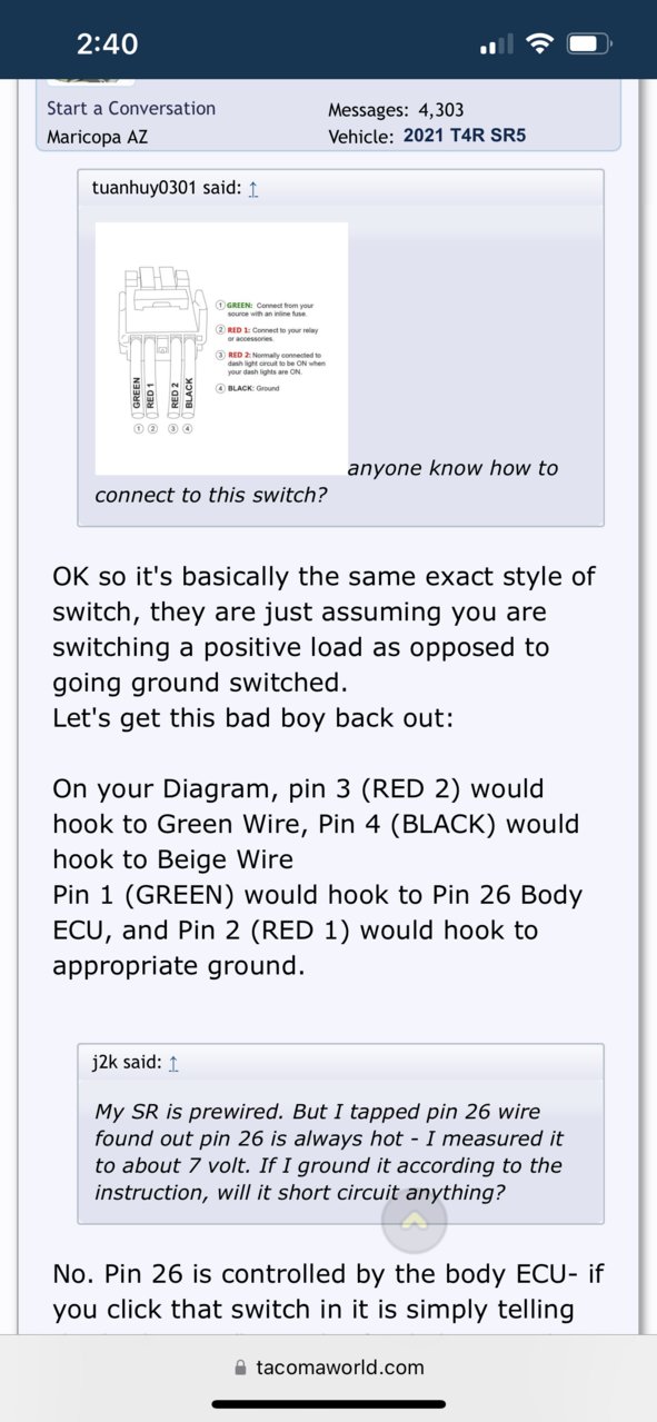

    Did you ever figure out the issue? My setup is behaving the same way. I also used the caliraised harness and fog light switch. It doesn’t matter if the switch is on or off, as long as the low beams are on, the fogs come on. I’m thinking of disconnecting one of the grounds from the switch wire harness.

    Up for now on the switch illumination. I didn’t try using only one ground. I wired it from the suggestion in the post. And I tried a couple other wiring choices that made sense from my bench experiments. If we could find a schematic of the circuit inside that relates back to the pin outs, I could figure it out. I had it working with the wiring a little different on the bench, but that didn’t translate to success in the truck. From what I remember is that switch has one led always one (symbol I think ), another turns on when switch is active (FOG LIGHTS I think) . So inside conceptually would be a switch across one set of pins for the actual circuit in the truck to turn lights on, another switch across one led to illuminate when active, and an led across the whole circuit to always be lit .
    I just haven’t figured the pins out.
    Maybe, Cali switch is designed to be used a bit differently than the way we are using it. ( using , switched 12v , not body control module logic )
    I know a switch is a switch, but this is a switch and an LED, so it’s possible that the led that lights up is fooling the computer to always remain lit, most likely were using the wrong pins for that particular switch.

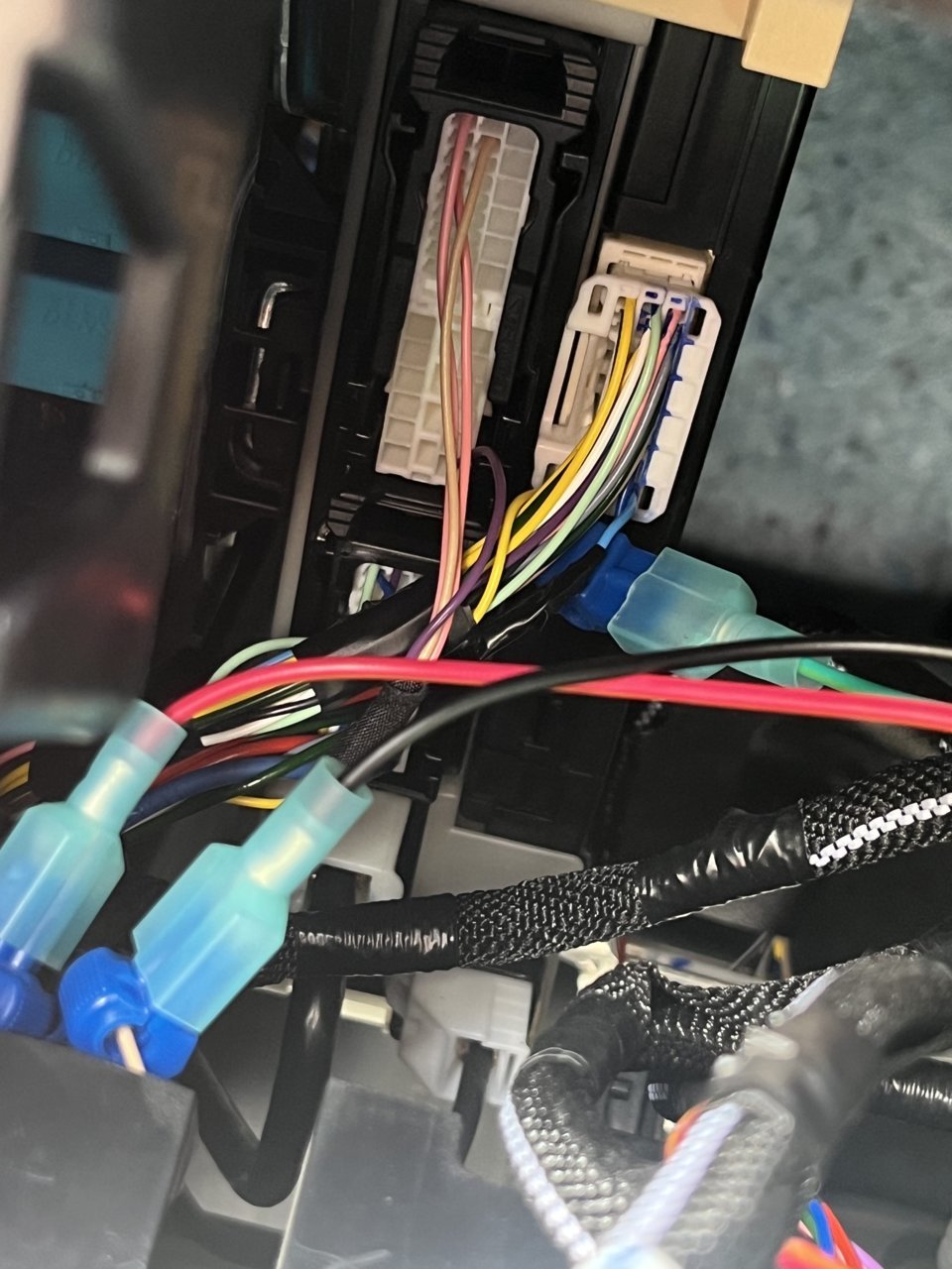

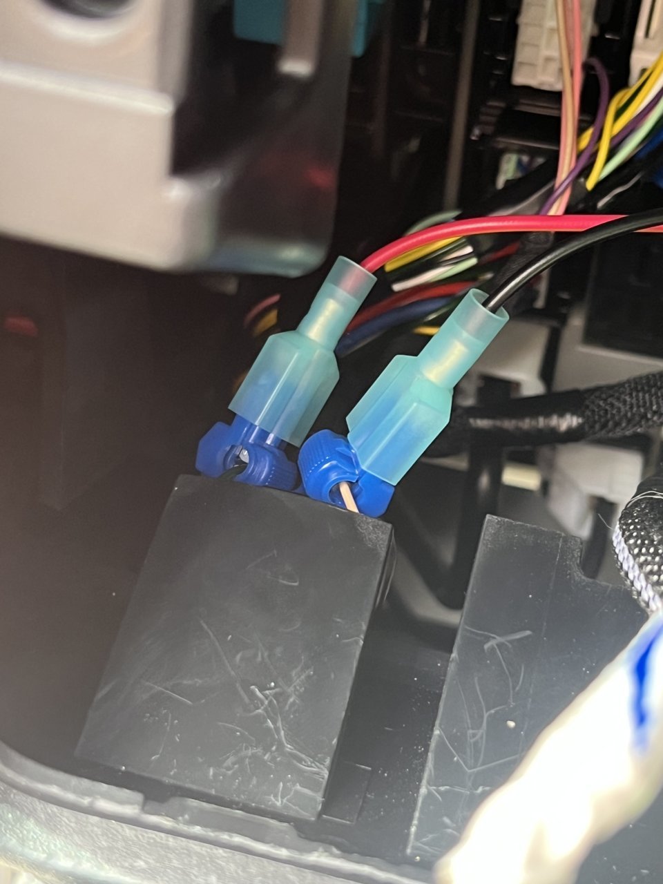

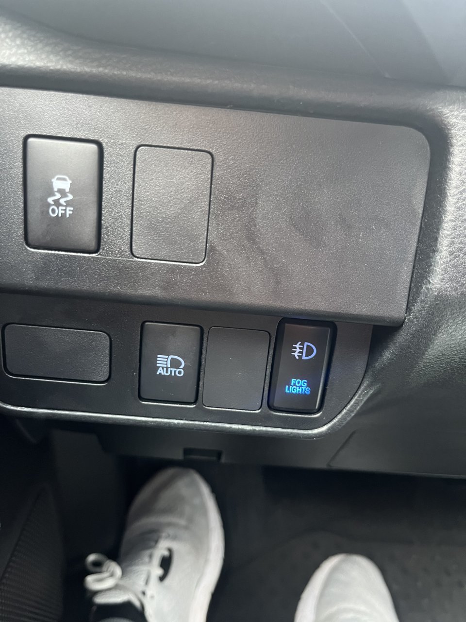

    Just finished installing my fog light switch!
    I have a 2022 SR SX and came pre-wired. Just had to get a fog light harness to connect the fog lights and a switch. Got a
    Cali Raised switch
    this is the layout for the wires. Green connects to the fog light wire(26). Red1 is a ground. Red2 connects to the deck lighting green wire. Black goes to the beige wire or to a ground.
    Originally tapped the wrong wire but luckily was able to undo it. Took me a bit to figure everything out.
    thanks you everyone on this thread. Been a great help

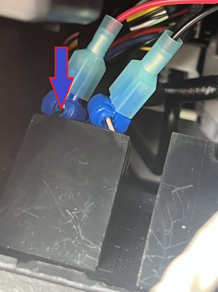

    What have you done here:
  18. Mar 30, 2023 at 12:08 PM
    #818
    hyauw91
    hyauw91 Member
    Aug 20, 2022
    #404006
    17
    2022 Mgm V6 SR SX
    That’s a green deck lighting wire.
