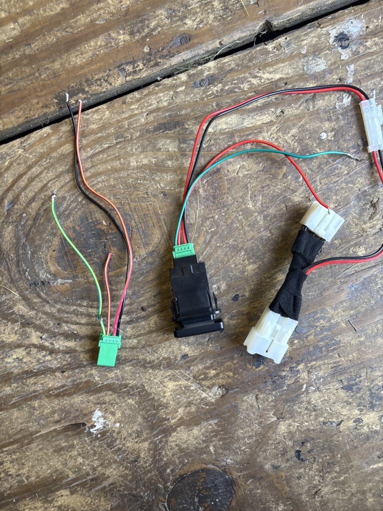

    I have a question about this thread. I am trying to add fog lights to my Tacoma. My 2020 has the blue wire in the ecu connection. When I put power to the blue wire, my lights don’t work. I ordered all the parts listed except I got different fog lights. I put the relay in, but I don’t have any power at the 15 amp fuse in the fuse box. Is my 3rd gen different from 2nd gen’s in this aspect? Thanks
  14. Jun 17, 2025 at 2:48 PM
    #954
    caribe makaira
    caribe makaira Well-Known Member
    Feb 13, 2011
    #51121
    11,817
    Caribbean, Puerto Rico
    05 PreRunner TRD Offroad AutoTrans
    Hood Struts, My version Fogs always ON, Map & Overhead Light Mod,
    That's because the Blue wire requires a ground, not juice.

    Ok, thanks!So I need to connect it to the ground on the Cali Raised switch I bought?

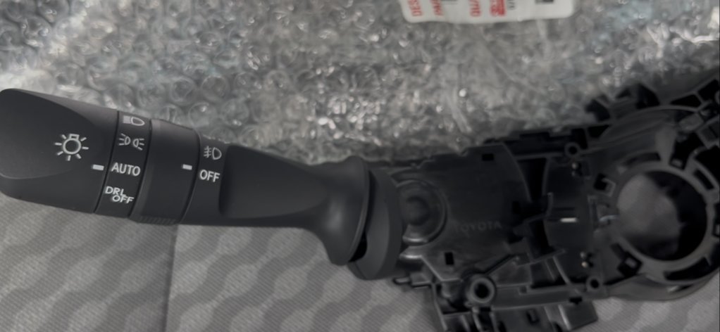

    I did a lot of research looking for the correct dimmer. The part number listed is not the correct one for me. (There are about 7 different versions.) I eventually went to CarMax's website. Found a 2023 Tacoma with every option known to man. Called the dealer with its vin and got the correct dimmer switch part number.
    This part number is for a 3rd gen Tacoma with all light options.
    84140-0R010
    • DRL
    • Auto Headlights
    • Fog Lights
    They seem to run about 150ish online and since I am doing this on a budget I will be holding off until I find a deal.

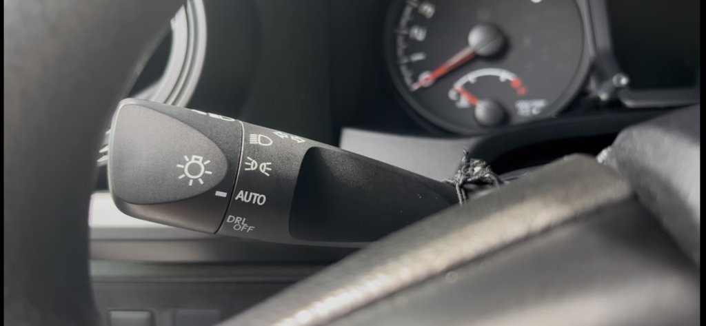

    I can confirm that 84140-0R010 is the right one if your existing headlight dimmer switch has the 4-option selector (headlight, parking lamp, auto, and DRL off).
    Old Part (84140-02840):
    New Part (84140-0R010):
