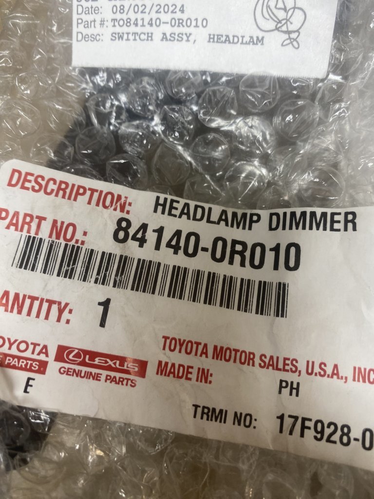

    IMG_6584.jpgThis is the part number for the stalk switch that worked in my 2023 trail edition. It was about $160 from the dealer. I’m sorry but no longer have the OEM fog bezel part numbers or the engine bay harness.
    Hopefully someone finds this helpful.
    The directions on how to do this job are second to none. Pretty easy for us pre wired folks.

    Yes. this thread was really helpful. The stalk was the hardest part but no biggie.
    The headlight Dimmer switch is the correct number for stalks with drl off setting.
    i got the part new for $110.00 from a local dealer so shop around.
    myself, I won't gamble with used electrical parts on my truck, but you do you.
    52128-04020 & 52127-04020 Are the Foglight Bezels Numbers
    Wire, Engine Room, N (82114-04010) is the Engine Bay Harness

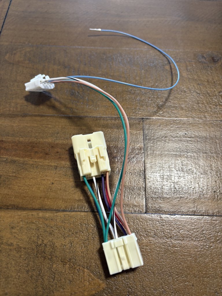

    Anyone know where I can buy a harness that plugs into my cargo/bed light connector so that I don’t have to splice the green and beige wire for illuminating the oem fog switch?

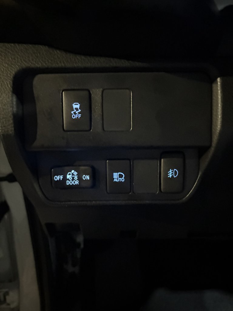

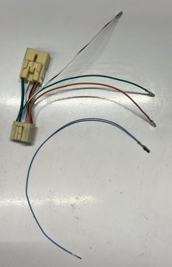

    Just wanted to leave some feedback on the custom piggyback harness I received from @Puppypunter ,absolutely awesome product. I went with the non–pre-wired method using the OEM second-gen fog light switch, and this setup was exactly what I needed since my cargo/deck lighting was already in use.
    Everything was 100% plug-and-play, no cutting or splicing into the factory wiring for the illumination of the switch.
    Really appreciate the time and effort @Puppypunter put into making this. Highly recommended if you’re looking for a factory-style solution for installing fogs on an SR, without modifying your truck’s original wiring.
