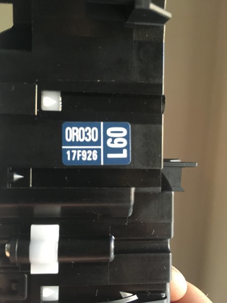

    Why do you have the part number for the STOCK switch? I ordered everything on the list and now have 2 useless switch assembly's. And get to do it all over again.

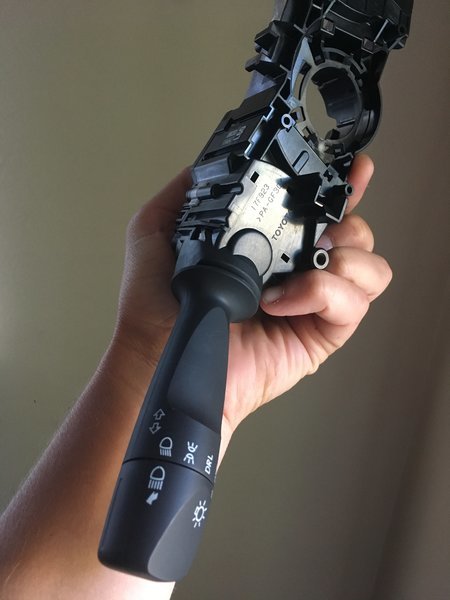

  11. Jun 17, 2017 at 3:52 PM
    #91
    Shamangue
    Shamangue Lets Rock
    Apr 28, 2017
    #217607
    40
    Tom
    Templeton - Ca
    2017 sr 2.7 4x4 5spd
    I was told, and found the opposite.
    0R030 is SR stock/without
    And 0R020 is with fog
    Even called Toyota and they checked vin with fogs to double check. That's Weird.
  12. Jun 17, 2017 at 7:47 PM

  13. Jun 17, 2017 at 8:29 PM
    #93
    Nitori
    Nitori [OP] Well-Known Member
    May 3, 2016
    #186058
    4,875
    Maricopa AZ
    2021 T4R SR5
    Wow that is really strange. Sorry for any confusion dude, I trusted the sources I was given and I will edit that post to reflect that there's something afoot. Let me know when you get an 020 and can confirm it has the fog switch!

  15. Jun 22, 2017 at 9:02 AM
    #95
    dawgstoy
    dawgstoy Member
    Mar 11, 2017
    #212941
    21
    21 SR V6 4x4
    I can confirm Shamangue is correct. I also ordered the wrong stalk, but was able to exchange it.
    0R030 is without fogs
    0R020 is with fogs
    0R010 is with fogs and auto DRL
    In this case, the "descriptions" are wrong, but the prices don't lie.
