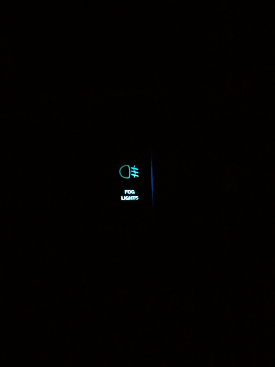

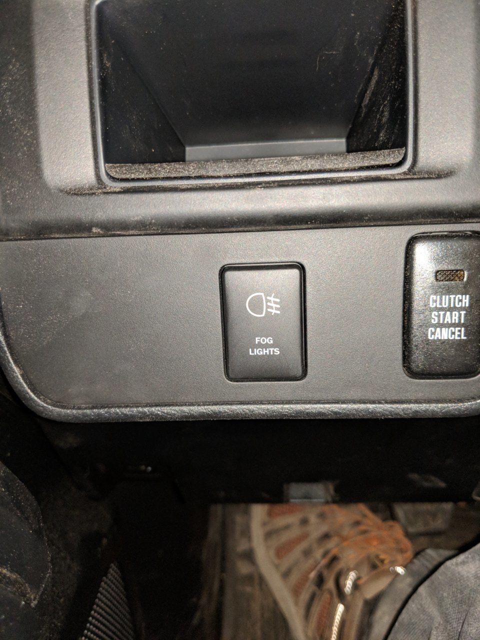

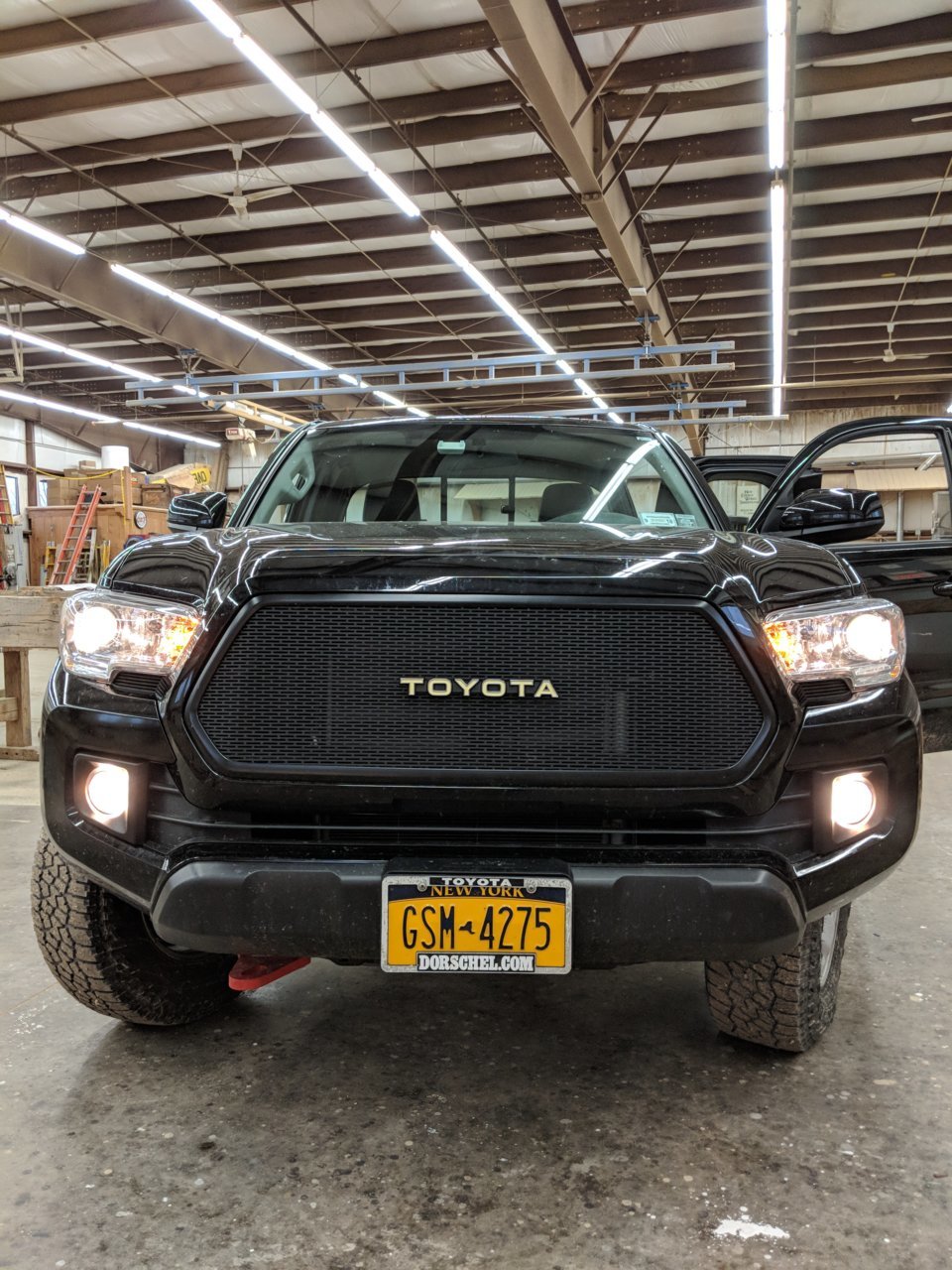

    Well installed my fogs today, thanks to this write up it went great!
    Even though I was pre-wired, I went with the dash switch because it was cheaper and I like it that way better. I got air on boards new Toyota switches, and they are a damn good match to the OEM ones.IMG_20180425_184145.jpg MVIMG_20180425_184158.jpg
