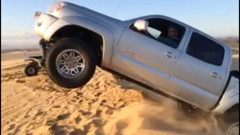

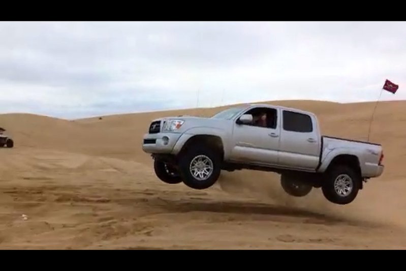

    Headed to Pismo tomorrow. Refilled the tank. Bumped the NOS up to 75 shot. Stock plugs, stock timing. Let's hope the motor holds up.

    Status report: blew through a full tank of nitrous at the dunes running 75 shot. The truck did well. It now competes with the razor XP 1000. They beat me off the line but I real them in toward the end of the strip.
