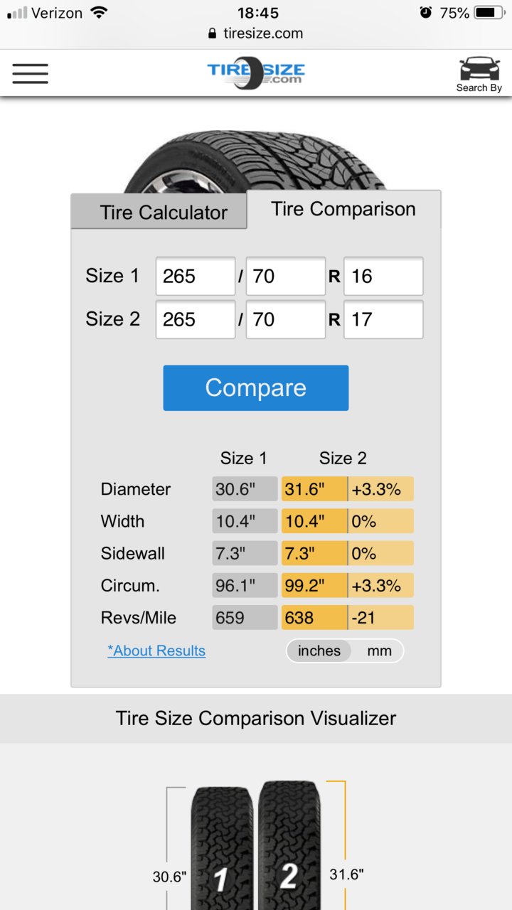

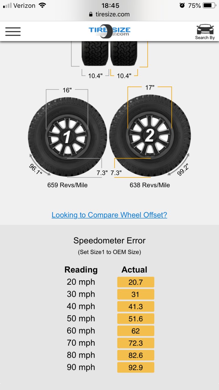

    On another note, will the 70 affect the speedometer. Will i have to get it adjusted?

    Maybe, factory spec to GPS is +/- 5% so it might even make your speedo more accurate.
    No, you wont need to get it changed, the difference is imperceptible
