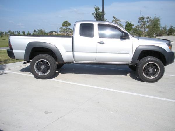

    I also ran the 285/60/18 NTGs when I first got the truck. They were on it when I got it. Rode fine, quieter than the Duratracs I have now but the grip in mud sucked compared to the Duratracs. They lasted good, drove good, were quiet & have 50k treadwear. They also come in C load for 18" rims unlike the Duratracs which are all E load in 18". Most of my travel is pavement so after the Duratracs give up, will most likely be going back to NTGs because of price, weight & performance. Had to go to 275/65/18 on Duratracs which are 32x11. The 285/60/18 NTGs are 31.5x11.5 but also come in 275/65/18. Not sure which of those sizes to go with next. With the 32" tires, my speedo matches my gps and other car's speedos exactly.
    Pic of the 285/60/18 NTGs.........They look a bit small OD with my lift IMO.....
