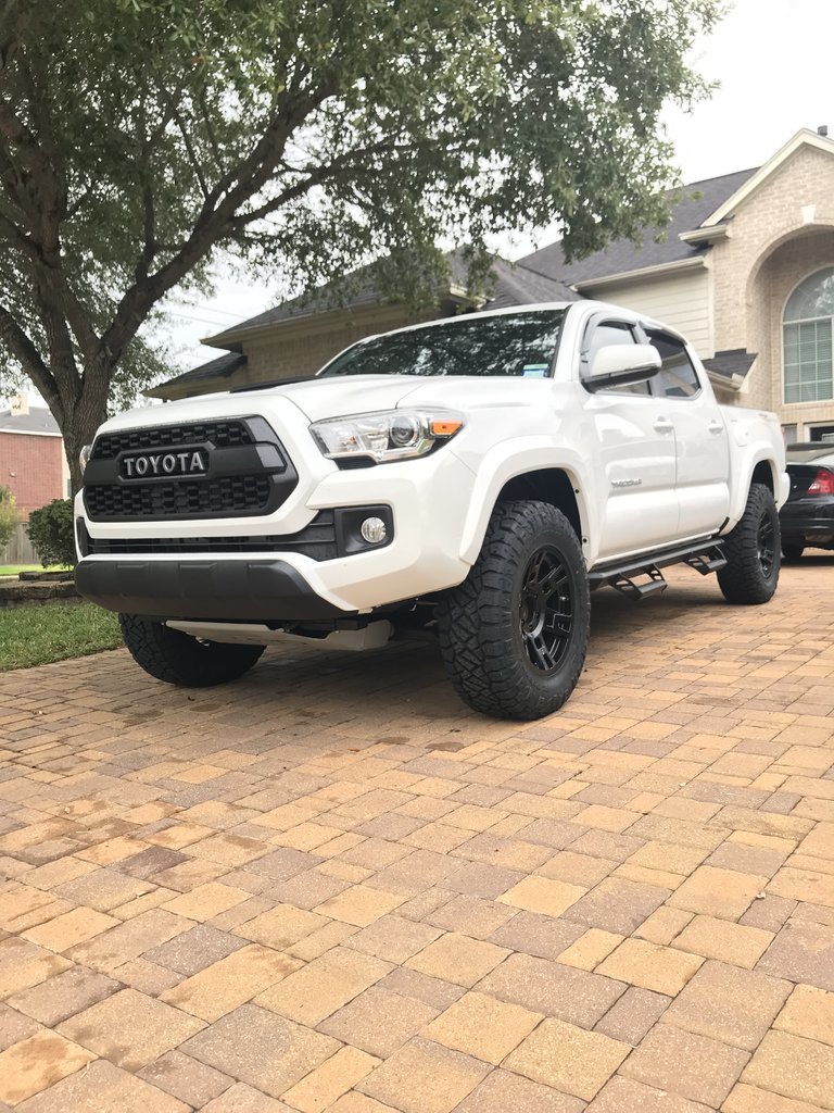

    Just got mine mounted and so far.. the ride has been quiet and not hollering ass.
    My MPG did drop by a few.

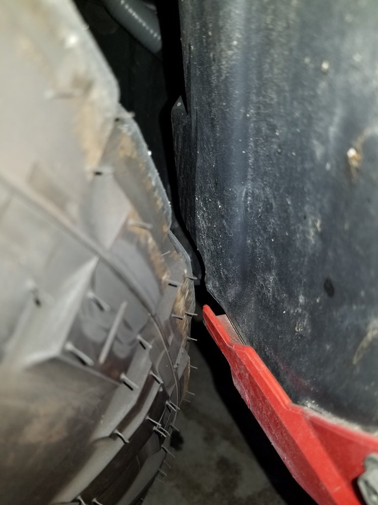

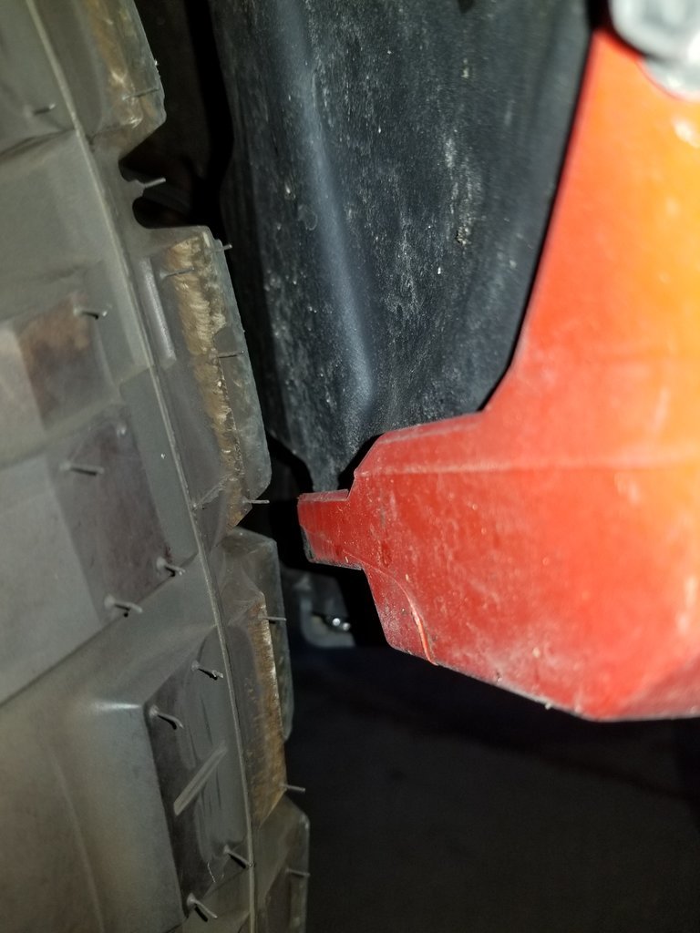

    Mine had a little rub on the plastic there too on my driver front when reversing and turned. I had them push the caster forward and no more rubbing. Will still do a CMC and heat the plastic for sound of mind in the near future.

    Looks so good! Nice job!
    Mine dropped too a little at first but then I learned to keep it under two grand. Which is very hard with these trucks. I think they they will stiffen up a bit after the first 500 miles. Mine seemed to. Plus tire size and air pressure play an important role. I try to keep mine at 37 psi. Seems to be the sweet spot for me. I still haven't verified that yet with the chalk test.
    Thanks, yea, it only rubs when I turn and brake at the same time, like at the end of my driveway. I think it is there to help hold the fender liner in place. I am sure it can be heated up and bent backwards. Or cut off with a dremel tool. If I put the mud flaps back on and heat up that bump out and push it in you would never know the plastic piece was gone. My tires only stick out about an inch, inch and a half so maybe the OEM flaps won't be beneficial. I kinda hate to spend the money on the Rokblokz if I don't need them. If they made them in orange I would be all over em' LOL.
    Edit, I Love to learn things............ https://en.wikipedia.org/wiki/Caster_angle

    Take a razor blade to it , that plastic cuts clean and easy, that spot is definitely not needed and won't even be noticed if you cut it off

    A-HA! Just as I thought! Thanks man. Appreciate it.
