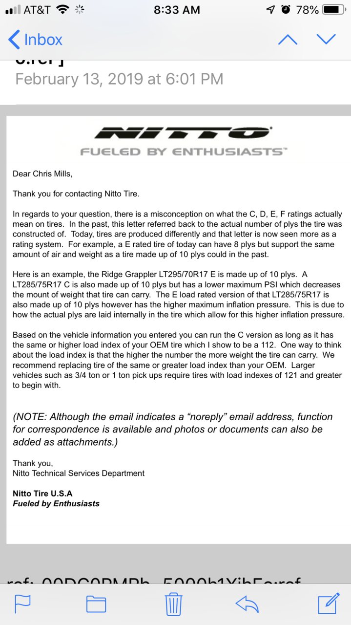

    E83FE0EA-9134-49F5-A6C5-530D5560FD12.jpg Does this help anyone discerning load ratings?? Or not really?? Lol..

    Funny, this is exactly what they told me when I called all 3 times and subsequently posted in the thread back then. Those posts and your written letter should be a Sticky somewhere :thumbsup:
    One other thing they said that your letter touches on is the "designation from the past" statement. On the phone they added this is done simply because it's easier for people to relate to. When I explained how if that's the case it just makes the specs confuse people more and the information should be noted on the site. Two of the three times they agreed. o_O
