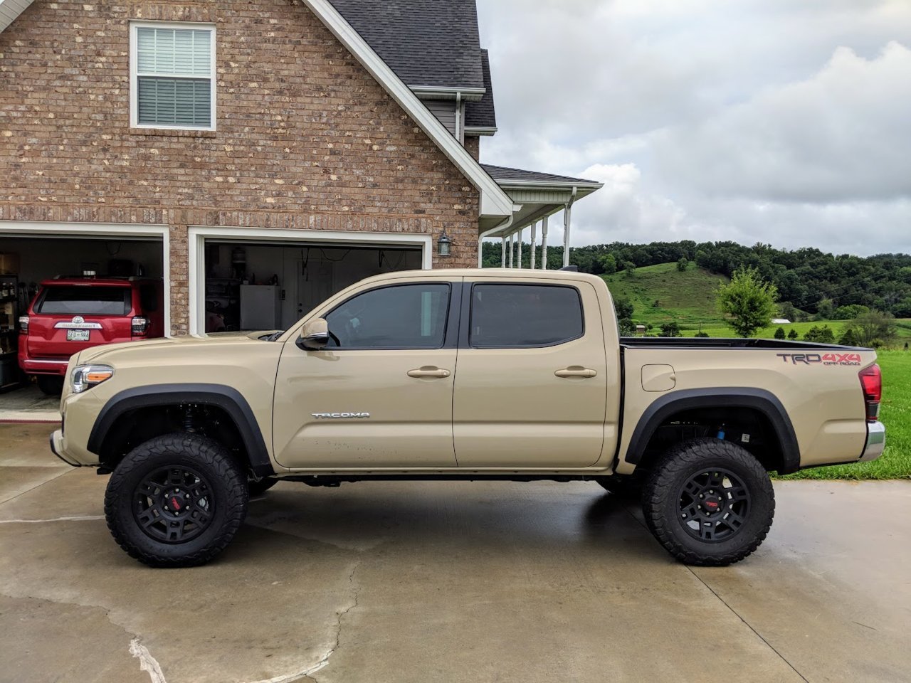

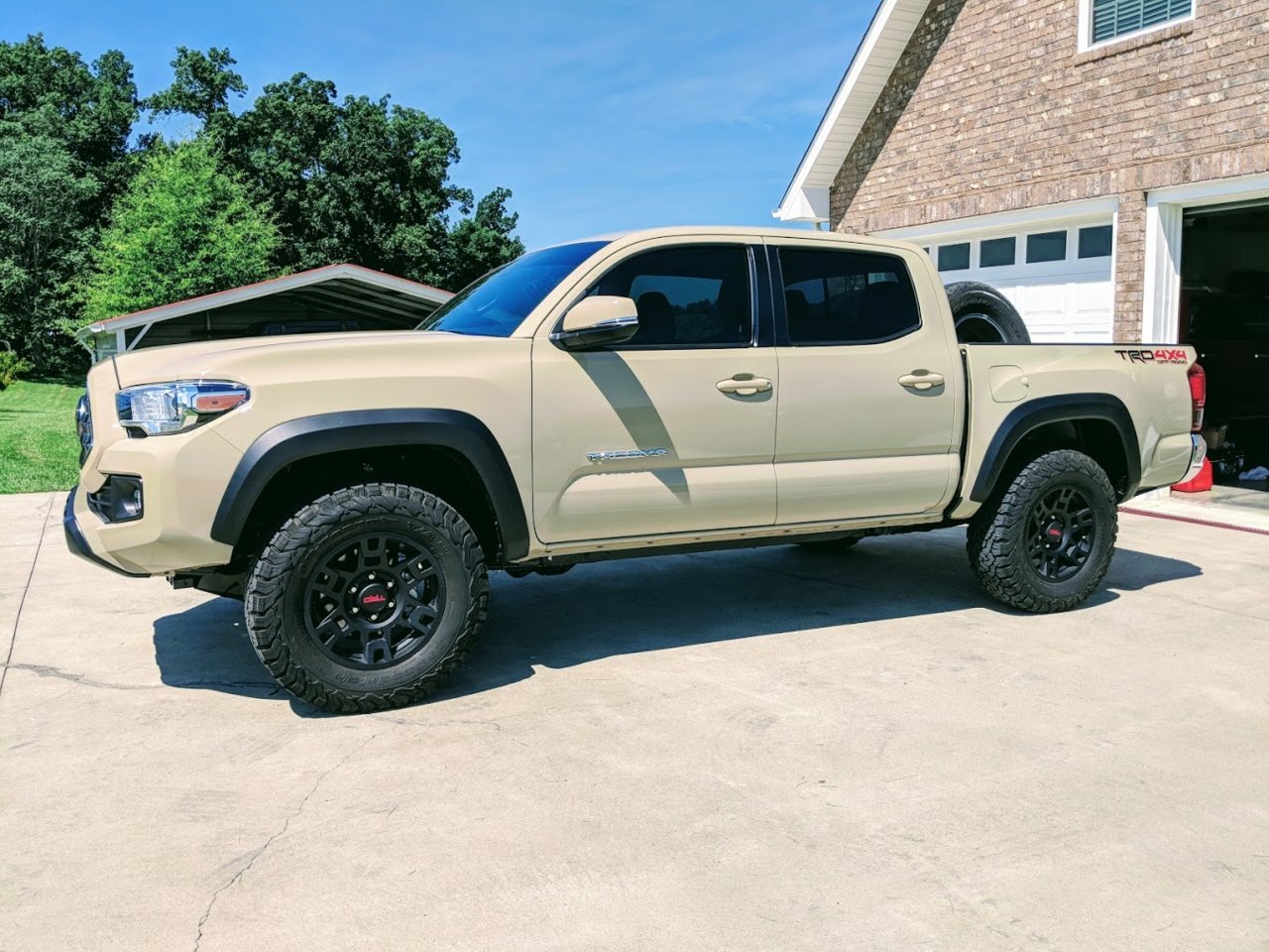

    This will work with no issues. I just installed the same rims on mine 2018 OR but I put BFGoodrich All-terrain KO2's on instead of the Ridge Grapplers. 265/70/17 no rubbing at all. Not even close. I dont have the mudflaps but I dont see how they could have rubbed even if I did.
    My lift was done this morning so Im selling the KO2's and installing 285/70/17 Ridge Grapplers tomorrow afternoon. I like them better after running them for over a year on my Jeep JKU.
    This is stock height with the TRD 4R rims and 265/70/17's
    This is same rims/tires but after the lift.

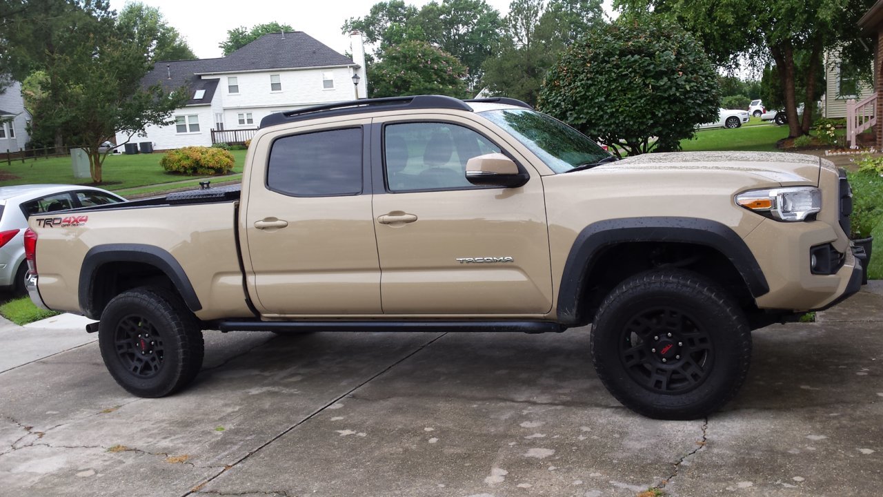

    Only difference I'm aware of would be the front valance (air dam) on the Sport as a potential source to rub on a +1 tire increase. Height between the Sport and OR should be the same.
    My truck with a 2 inch lift and Nitto terra grapplers at 265/70/17.

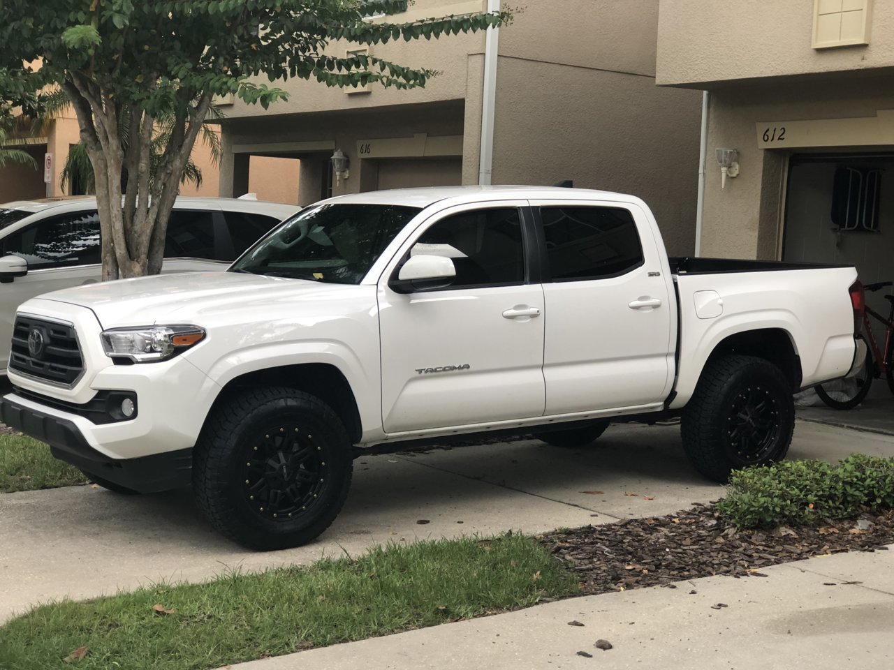

    John
    2018 Tacoma sr5
    265/70/17 Nitto Grapplers on a 2018 stock suspension, no lift , no rubbing whatsoever. You won’t regret going this size . Picture doesn’t justify how aggressive the tires look. Again no lift, no leveling. Enjoy :)
