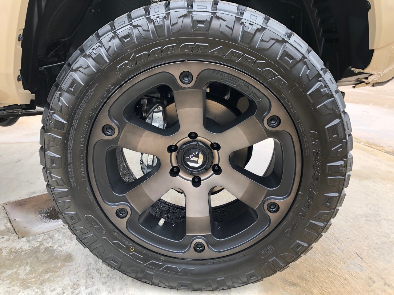

    Saw this tire on a lifted '18 Tacoma at a new car dealer here in San Antonio and loved the look. I ordered a set for my truck and they'll be installed tomorrow along with some ride-height adjustable Bilstein 5100's. Now I'm freaking out a little - is this too much tire for the 2.5" lift the new Bilstein's are going to provide? Anybody else have these Nitto's? How do they compare to the BFG AT KO2 in road noise?

    Thanks, Minmedic -- I'm going with the same wheel as the picture - a Fuel Beast 20x9. Mine will have a 1 OS - I'm not sure what offset the pic has. I think I would have preferred the look of the 20 OS but that might not be enough room in back.

    Thanks, TacoDude, I'm very glad to hear the tires are quiet (no pun intended). I'll be getting the same tire as pictured - 285/55R20's, so I think that works out to about 32.2"
