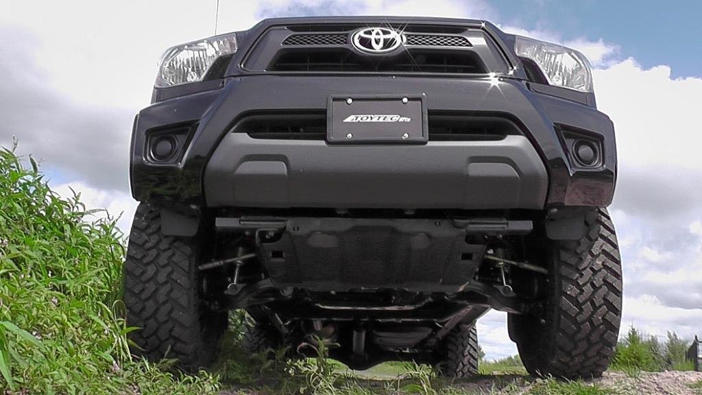

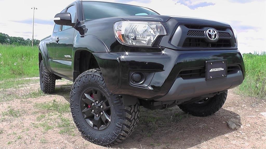

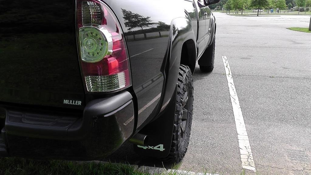

    Nitto Trail Grappler 285/70R16 on Stock SR Wheels. ToyTec BOSS Suspension (sits 2.75" over stock) and no cutting or trimming required! I have tested them off road with no rubbing at all but at full lock it is very close to the UCA and I may go with the Bora 1/4" wheel spacers that are hub and wheel centric... not sure if I want to waste $$$ and I really don't think it will be an issue... I also have the mud flaps on and there is no rubbing! Tires are smooth on road and very quiet! They have slightly more noise than the stock tires and handled great in the rain! I didn't get to test them out in the mud yet but I hope to soon! The diameter of these is equal to 265/75R16, just a little wider.
    Actual specs:
    Size
    285X70R16
    Load Rating
    10
    Diameter
    31.89
    Cross Section
    11.5
    Max Load
    3640@80
    Tread Depth
    18.9/32

    I ran the same size with a minimal lift, full lock & stuff and no rubbing. I loved that tire.

    Nice rubber :) , BIG NITTO fan, I've got the same tire with Kings, Fules, OME Dakar's. Very nice AC!!

    These seem to be the max for stock wheels without the need of spacers and cutting/trimming... and you can leave your mud flaps on if you like without any rubbing also. Nitto seems to be the only manufacturer with this size. They were $277.00 each mounted and balanced.
