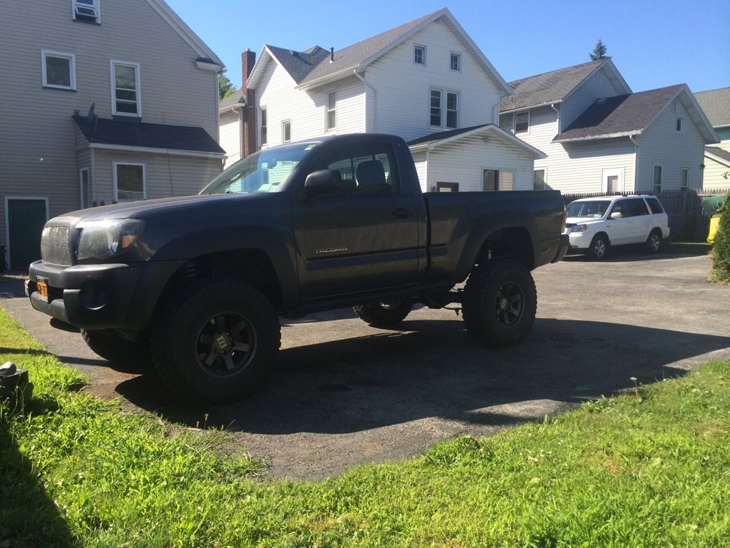

    Great, thank you!
    I currently ended up with a lot more lift than anticipated from the chevy swap :eek:
    Trying to figure out exactly how high from stock I am... Must be around 4.5" :anonymous:

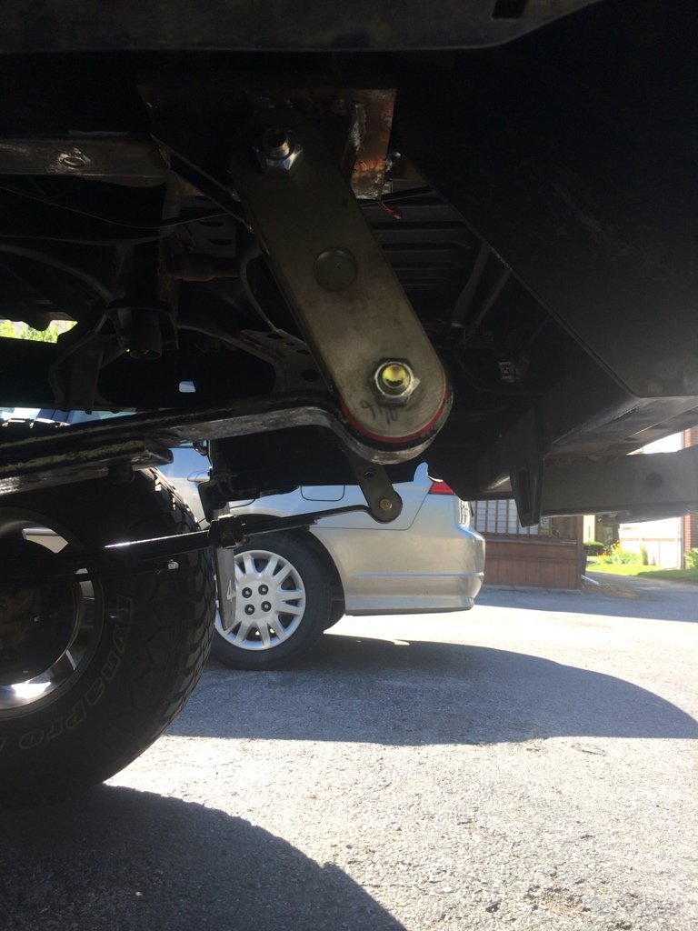

    Yeah, I set it so the shackle is vertical at full droop in hopes that it would be nearly 45* at ride height.... It's not :anonymous:
    5" shackle

    Thanks man! I may move the hanger forward, I think that's the right fix... Pain in the ass though. Not sure what the fix for now will be... Plate bumper with heavy tire on the swingout? Your setup must weigh a bit haha :)

    Ant, correct me if I'm wrong, you loose 1" for every 1/2" you take off the shackle. I think shortening your shackle 3/4" that'll put you at the lift you want and the angles you want

    Yeah, I wasn't sure how these things would compress so I just went for max droop... Now I know how much they compress I can move the shackle hangers forwards. Or live with it and order a bumper :D
