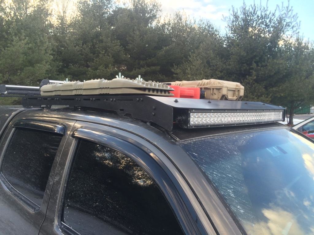

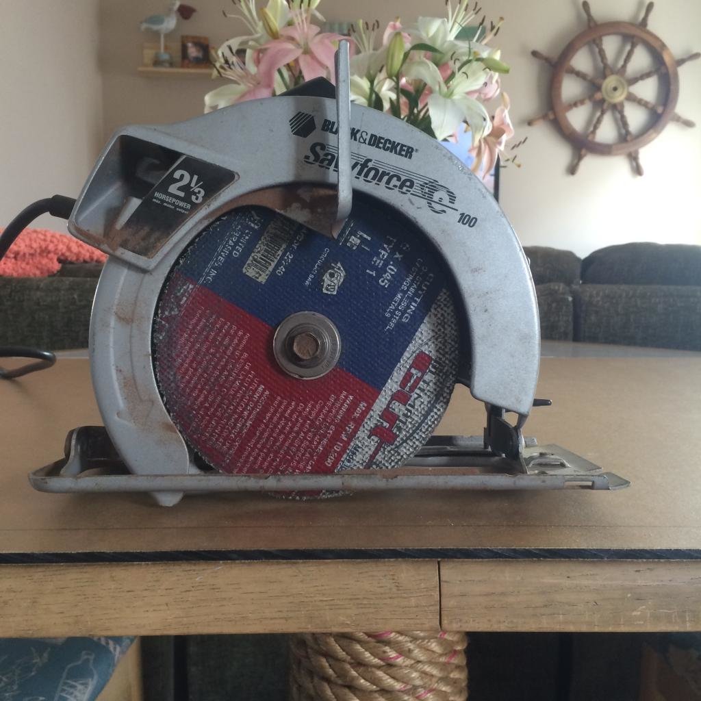

    Good scoop!
    Circular saw with grinding wheel worked great! Just have to make sure the blade is pulled up to only cut slightly more than the thickness of the plexiglass. Surprised to see no burning or melting, just cut with ease.

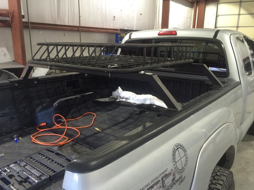

    Thanks to Josh and everyone that gave a hand in secret modding some bed bars for a fellow DB who always helps out others.

    That looks sweet. What's the dimentions of the angle iron you guys used for the mounts?

    beef.
    i'll let chux chime in since he bought it so he probably knows what it is, but i think it was 3" angle and 1.75" square tube.

    Yea pure beef. These are the raw material dimensions ^^^
