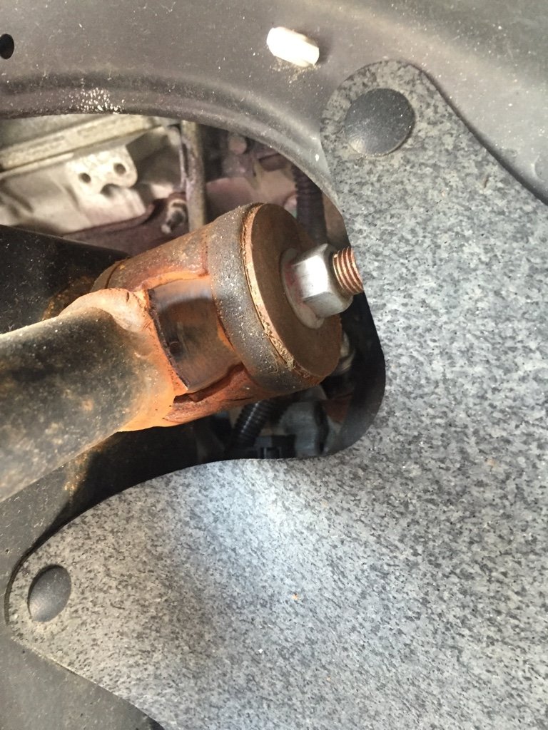

    So I went for an alignment few weeks ago and have them the specs. Alignment was done but all of the sudden I was rubbing like crazy and weird noise in front. I brought it back and they told me my passenger side upper control arm is cracked. I don't understand how they didn't pick up on it while truck was being aligned or they did it. What's my best option and does anyone know the warranty on the LR UCAs. Thank you

    Here is a pic!!FML

    Same exact thing happened to my LR UCA. I ended up swapping them out for Total Chaos UCA's and haven't had a problem since.

    Wasn't it just a certain batch that was doing that? Mine are about 5 or 6 years old now.

    SPC said it was due to the bushing, so they upgraded to the Spec-ride bushing. Then it was still happening and they determined that it was due to the UCA bolt compressing the washers, preventing the UCA from cycling freely so they extended the bolt sleeve and eliminated the two inner washers on each arm. Then they tweaked the bushing design again last year, so who really knows.

    LR FTL!
    Yep that's about right. Not the first one and certainly won't be the last one.
