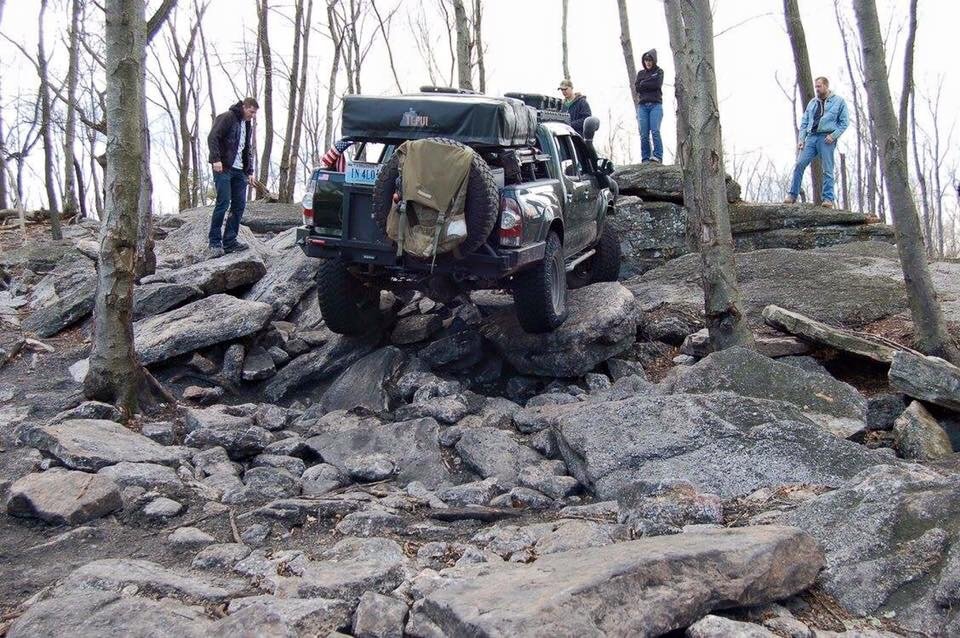

    I'll be there to wheel Friday, Saturday for blues and blacks and maybe Sunday on greens/blues if my brother in law wants to wheel his jeep again.
    I think we can get you up this time. We know the line now

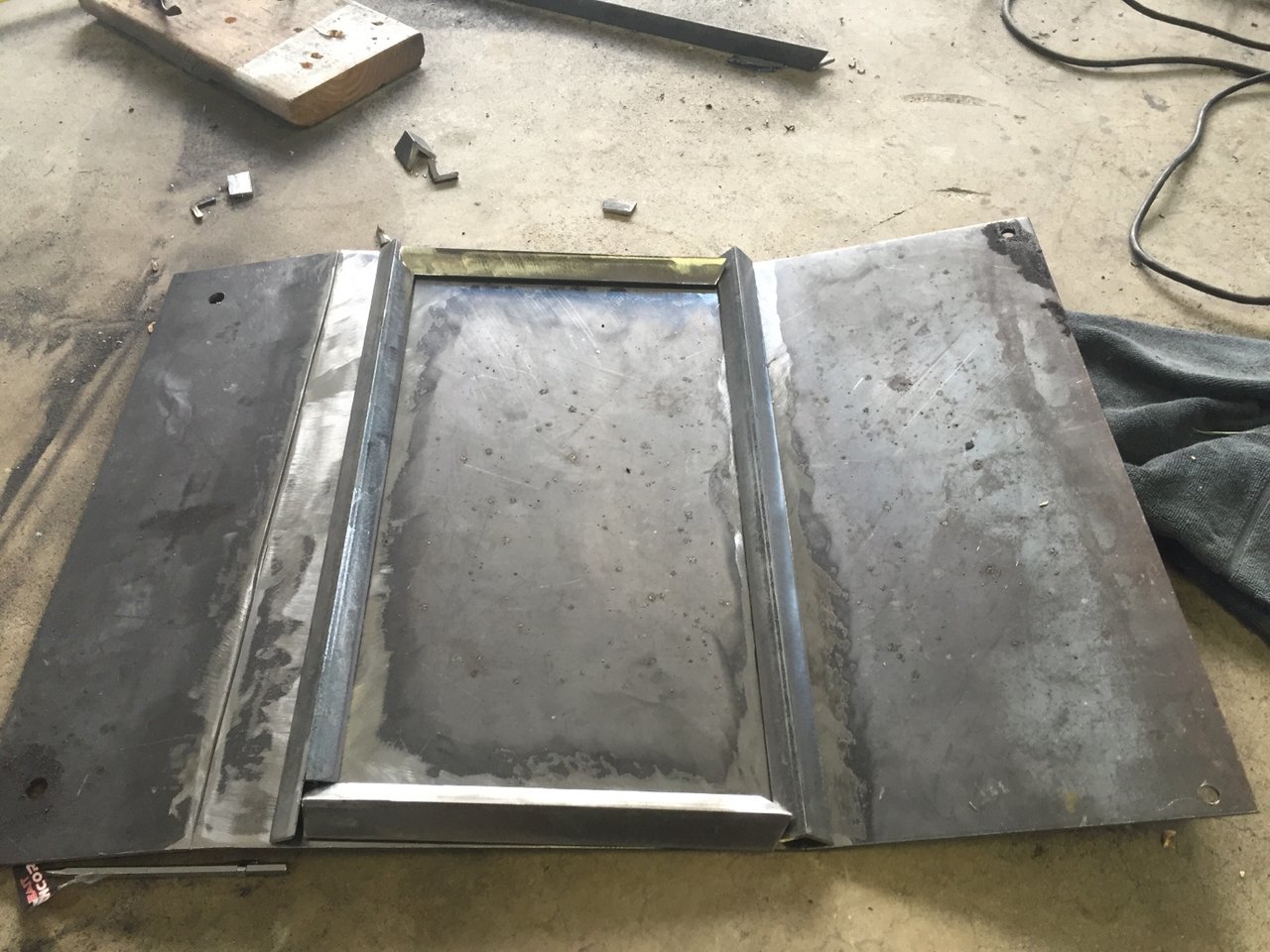

    Ready for welding.
    Damn 1/4" is beefy! Must be heavy as fuck to get on but that shits probably strong as hell!

    It's not that bad, I put a nut sandwiching the skid on one of the front bolts to the crossmember, so I hold the front of the IFS skid with one hand while I roll it in on a dolly, then spin the nut that holds it to the crossmember on with the other hand, then just go to the back of the skid and bolt it up. But that's why I mad my trans skid and IFS skid two different pieces, between the two of them, I'm looking at about 110 lbs if I had to guess.
