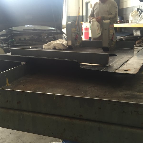

    Here's how my trans skid is being reinforced. Those are 3/8 thick 1.5" wide steel standing on their side. There will be another crossing over in the back connecting the two side bars.

    That gonna be strong enough??

    My first thought is clearance 1.5" even layed down is gonna be tall

    There's 3-5 inches between the trans pan and the skid. Plenty of room for the 1.5" pieces :thumbsup:

    These will be fully welded and are much more solid than the lip that gives the skid rigidity from RCI. If this isn't strong enough, I'm on the WRONG trail... :D

    Idk I think angle iron would add more strength and be less....weird...

    Who cares about weird? It's under the truck between the skid and trans lol!
    It'll do the job. And it's free :thumbsup:

    Gotcha, ya it'll work fine for you

    The problem is where that lip on the sides ends. It's just not long enough from RCI. Of course, that's where the damn thing bent. This just adds that support, but stronger.

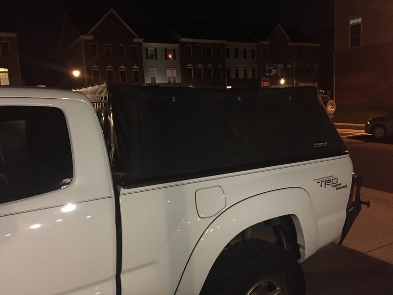

    Softopper installed!
