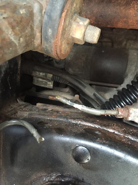

    Question for those smarter than me. When I remove a brake line, should fluid continually run out of the whole rest of the system is sealed?

    I wouldn't think it should run out continuously...

    That will happen. You should gently pinch off or kink a rubber line to stop it. Or let it run out and bleed the whole system when your done.

    Usually it will trickle slowly, I cap it with w vacuum cap to slow it down. If you open something though like the m/c cap it will flow faster than hell haha

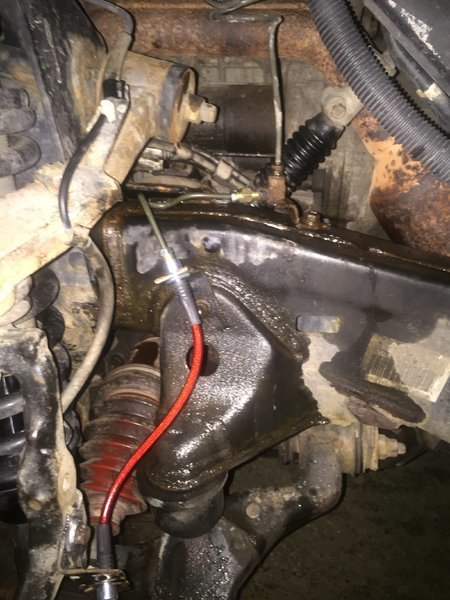

    Everything I touch on this pig is rusted! Had to replace another ridged brake line to get the stainless line on, then the part store didn't have the right lines! Had to use an adapter to make it work. All night for one brake line.

    Yikes! Im happy my shit wasn't that rusty. It also helps if you use a tubing wrench. But THAT would not have been prevented with a tubing wrench...
    Now that they are in to bleed them by yourself will be a PITA. I loosened the bottom fitting on the new lines and just let gravity drip fluids down and out... Once it started coming out more than a drip tightened it up and did the other side... Then just sit in the truck with it running and pump the brakes and then bleed them normally... I got literally no air in my system

    What's a tubing wrench? Is that like a pipe wrench?

    Line wrench
