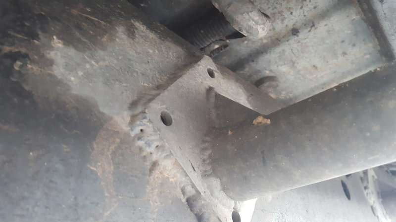

    Drop bracket lift and booger welds
    Huh? Never heard this before. Always seen the gusset welded at 12, and never seen an issue. Also welding the gusset horizontally on something that takes vertical force doesn't make sense to me at all. That gusset won't puncture through the scab plate. Maybe if you welded the leg to the frame directly that could happen, but not with a scab plate and solid frame behind it.
    I was going to say, fuck drilling those holes if those are supposed to be bolt on. Then like the other guys said, the legs get welded to the scab plates, and the plates get welded to the truck.

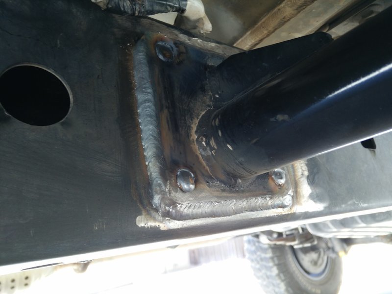

    Good example:

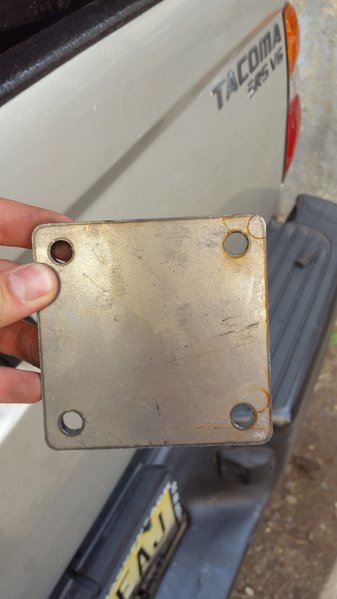

    Holes are most likely for welds. When you weld plates, a lot of time guys will have holes in plates to have more surface area. Stronger weld.
    If you were to use the holes for bolt on. You'd need to insert sleeves inside the frame and weld them. I can guarantee the frame is to thin just for a simple bolt on solution.
    I agree. Most guys weld them at 12. But it's better to weld two gussets at 10-2.
    You'll be ok. Just use weld through primer, weld it and call it a day.

    ....i think everyone welds the plates straight to the frame, I can lift my truck by the slider and the slider and frame do not move.

    Or do it like the other bolt ons with a backing plate on the other side of the frame c channel. Just bolting to the outside of the frame will lead to the frame twisting, right @stairgod?

    Welding a plate on the frame is better and stronger because it destributes the force more evenly. With out a plate, the rock sliders can puncture through the frame like a soda can. And it flexs a lot so welding a plate is totally safe .
    Also knowing how to weld is good. If u suck u can mess up the frame.

    Like I said. Fill those holes with weld. Stronger.
