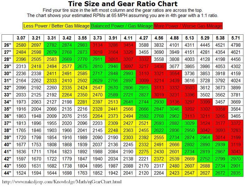

    Any clue what your trans temp is during warm weather/towing?
  17. Nov 7, 2016 at 6:06 PM
    HomerTaco
    Mar 28, 2010
    #34129
    45,874
    HomerTaco
    HomerTaco
    HomerTaco
    I still feel that 4.56 gears on 35's is not exactly right. After driving across the country a few times I think 37's on 4.56's will even everything out to where I wanna be. Lower highway RPM's and obvious NFG on the trails with the crawl box.
    Nimble9 likes this.
  18. Nov 7, 2016 at 6:07 PM
    HomerTaco
    Mar 28, 2010
    #34129
    45,874
    HomerTaco
    HomerTaco
    HomerTaco
    Do that long enough and wheel it with any regularity like Thayer did & you'll cook that auto trans. ;)
  19. Nov 7, 2016 at 6:08 PM
    stairgod
    stairgod NOOB
    Aug 16, 2015
    #161924
    7,965
    Jo n
    PA/NJ
    2011 MGM Trail Limo
    Locked Boosted 35s
    What is your overdrive ratio with the MT?
  20. Nov 7, 2016 at 6:09 PM
    HomerTaco
    Mar 28, 2010
    #34129
    45,874
    HomerTaco
    HomerTaco
    HomerTaco
    :notsure:
    I can tell you that "highway speeds" put me cruising at over 2800 RPM. I'd like to lower that a bit.
