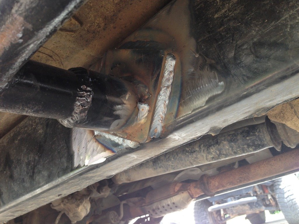

    I'm pretty busy. It will also probably take two days. if you want, we can meet and you can give me the legs, frame plates, and gussets so I can get those welded before we even start. I'll have to look into if there's anything different about positioning first gen sliders

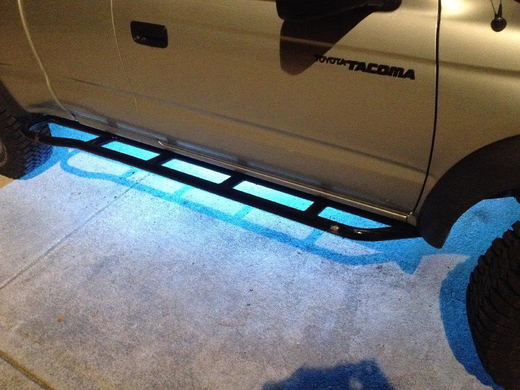

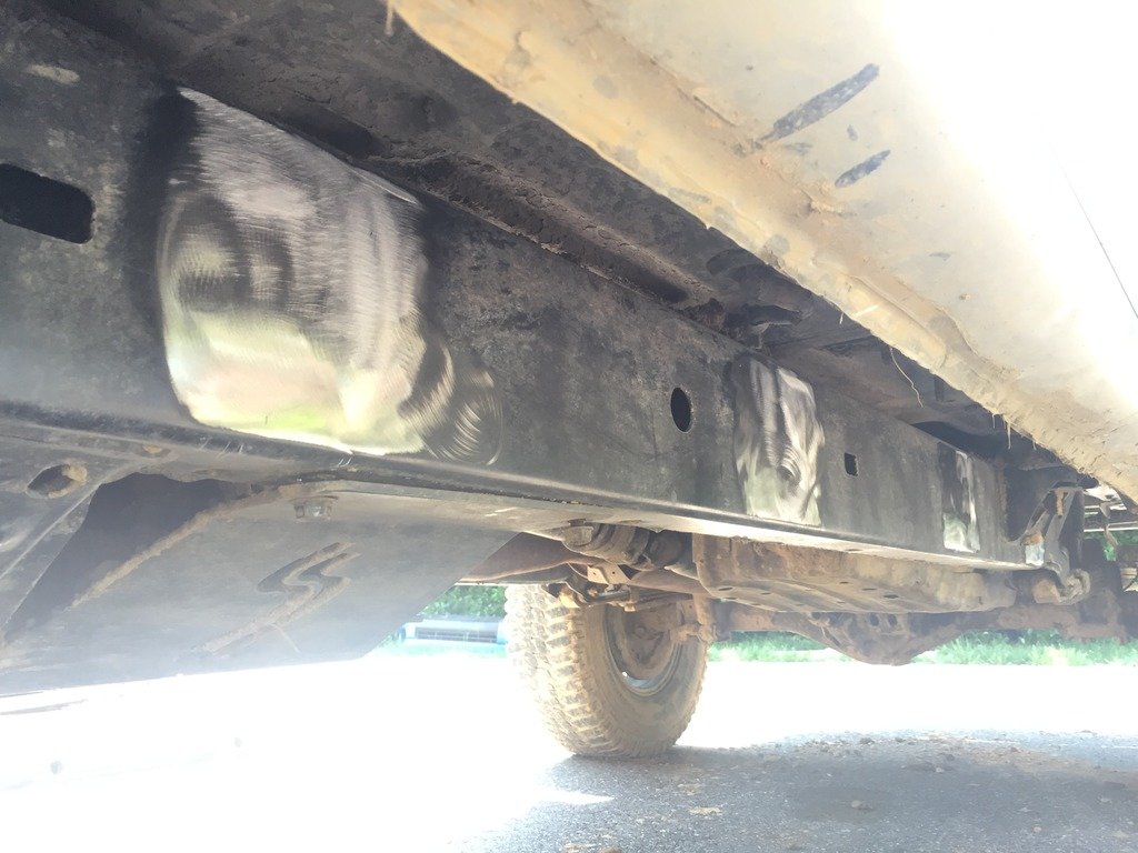

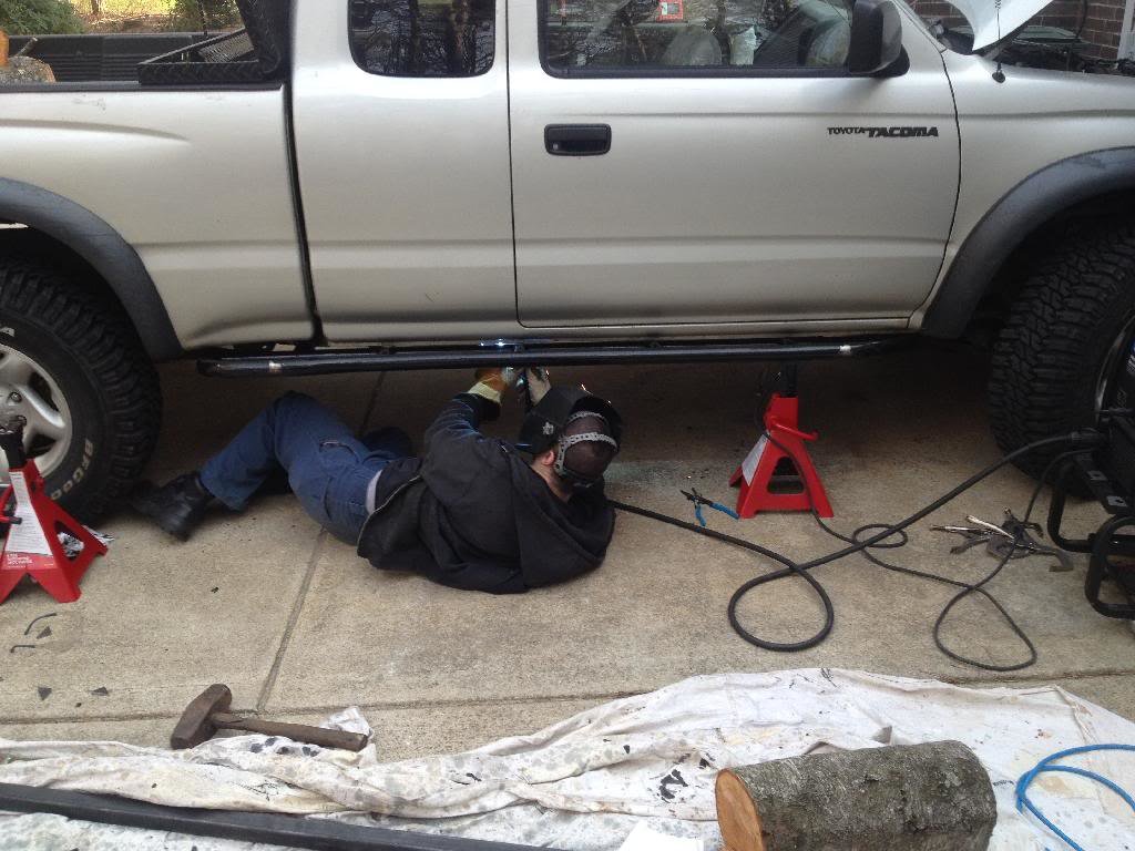

    No science to it. Ant and I just made sure the front of the slider was behind or in line with the body mount (so that when I tubbed for 35's the tire wouldn't hit the slider) and the rear kick out ends right at the wheel well. I also bent the pinch weld on the body up a bit so I could tuck the sliders as high as possible (last time I didn't and the sliders and body would rub).
    First time:
    Second time:
    You can see whre I bent the body over, angled towards the center more.
    ^^ shows why we started the slider where we did.
    Otherwise if you dont plan on having a super flush slider mount or tubbing for 35's it matters a whole lot less lol. If you don't bend over the pinch weld on the body I recommend keeping the slider away an inch allowing for slight deflection/flex in the frame vs. body.

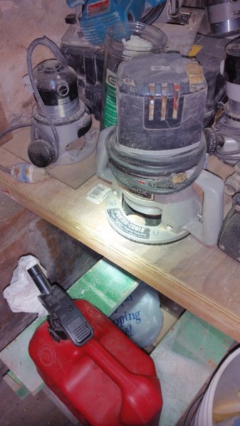

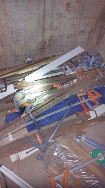

    I ask because when I bought my place the guy I bought it from gave me tons of carpentry equipment and tools. I'm sure you have tons of carpentry equipment, but if you interested I can give them to you. Not looking to get anything out of it, just cleaning up my basement.
    I'm going to take pics of some stuff and will send them your way

    Can you post a pic of the frame plates with legs welded on, I did mine offset to the bottom to have enough space between slider and body. I also positioned them like a diamond instead of square

    Same concept, just different plates and legs than you would be working with.

    Ok so you did the same, diamond orientation with the leg offset towards the bottom right?

    Yessir. Well Ant did, I just helped and discussed where I wanted it. :p I'm a very hands on helper though.
