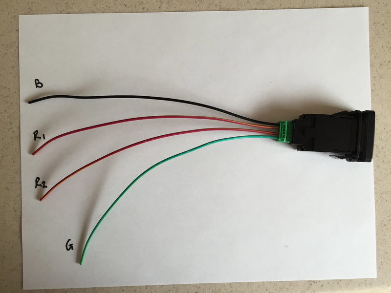

    What switches did you use?

    Im confused. You ground the switch with no electricity and it lights up? Where the fuck is is getting its power from?

    "Whatever you want" is a very broad description. Same gauge wire (as the ground wire) is preferred. Yes butt connector will work fine.

    Haha. The lights are wired. The power to the lights is wired. The power for the LED on the switch wasn't wired. I touched the ground to the vehicle and it lit. Maybe it's getting power from the battery since that's hooked up? I'm not an electrical genius. I just try to use common sense when wiring stuff.

    Most switches won't light up without a ground wire.

    Well where do I get power from on them?

    Four wires. Two Red, a green, and a black. I think IIRC I have one red and green going to the lights themselves. They work fine. Then theres another red and a black. Black is ground which leaves the other red to power. Since the lights work I would assume that's wired right. When I didn't connect the other red but touched black to a ground the switches lit up. When I turned them off they shut off. I shut the light off and they lit up again. I think they are supposed to light up dim, and brighten when the power is on. I'm fucked up. Either way, I don't know where to draw power to the LED's on the switch from. And I need wire to lengthen the ground.

    Got same switch last year.
    Here you go:
