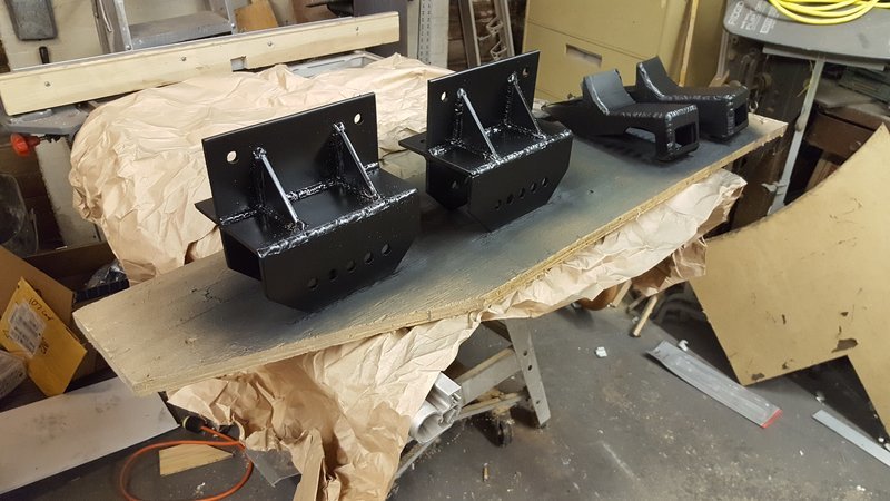

    Lloyd pm me your best price on that shackle flip. I'm thinking of making one but we'll see.
    And Jon can I see some pics of the one you made to get some ideas

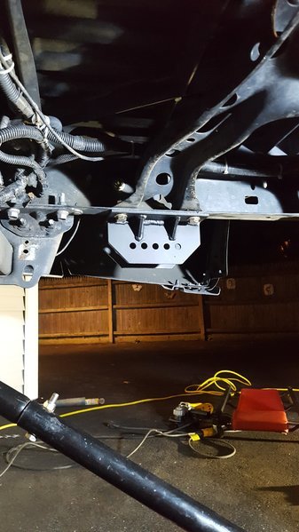

    These work for you Ryan?

    Flip combined with shock relocate made such a big difference.

    Yea, I like it

    Both. The Dakars are perfect for the weight I have on the rear. The full and relocate gave me more droop and more usable uptravel. Ass end no longer hops on big bumps. I hit speed bumps at 25 and it just floats over them.

    Do you have to relieve the stress on the e brake cables? Mine are pretty tight at full droop with just axle shock mount relocate

    E brake cables not bolted to leaves anymore. And unbolted from front spring hanger also. Put a zip tie through bolt hole to keep the bracket from flopjng around.
