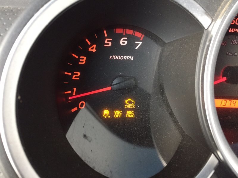

    Threw a P0430 code. Got the same code last year. Changed plugs, cleaned throttle body and MAP and it went away. A year later, today, got this.
    What I don't understand is why did I get the Traction, VSC and VSC TRAC warning light to come on at the same time?
    Guidance please?

    What? I read this several times and I think I'm starting to understand.
    Last year when I threw the p0430 code, the other 3 didn't light up. What's different about it now?

    I'm thinking the VSC/TRAC lights are lit up because of the possible change in front end geometry because of the new bumper/winch weight and that I still have the OME 884's? But then, why the CEL P0430 code as well?
    I haven't done an alignment yet. Going to install B6112's, Eibach 700# coils and LR UCA's this weekend. Then alignment.

    Which code is that?

    P0430 Catalytic Converter Efficiency below threshold. Bank 2.

    Could be the rear O2 sensor, as they are what monitor the efficiency of the cats.
    Just for kicks do the wire method to reset the VSC
    FYI, when my alignment was out of whack after doing my front end, my VSC ligjts was on constantly
