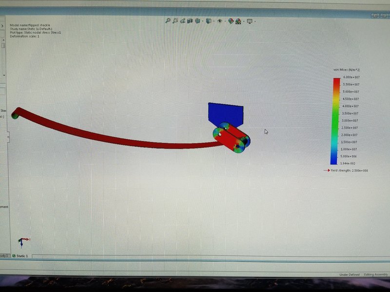

    I used 1000N force up on spring. All material is A36 just for comparison. shackle length is 5" I think. I didn't get a chance to model it as technically a spring...Just as a bent piece of metal. The program has trouble with the excessive displacements that springs exhibit. A very rough estimate of dimensions, materials, and forces. But it has helped me to visualize what goes on much better

    1k Newtons???

    Yes haha I was rushing

    A bit excessive maybe?
    Dakars were so.ething like 25 Nm/mm as far as aspring rate Iirc

    I adjusted the force based on the displacement I was getting with one leaf

    1000N is only like 225lbf

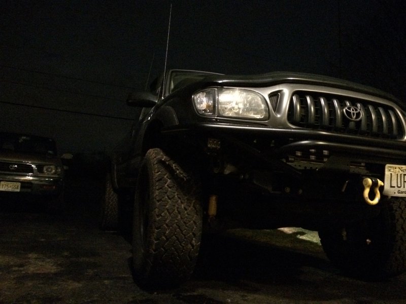

    got everything buttoned back up, the other side took 1/4 the time once I knew what I was doing and had all the tools out. Then I threw the spacers on all 4 wheels. Feels good not to have to worry about ball joints for a good chunk of time. But Instead of worrying about a ball joint failure now I'm gonna be worrying about the spacers failing lol. Spacers stick the tires out about flush with the flares, maybe a bit more. Doesnt rub the frame anymore but Its rubbing bad on the flare so Ill have to trim that a little bit tomorrow.

    Gladiator
    Possible, if the shackle isn't able to rotate freely that would change the effective spring rate.

    Well with stock hangars, the weight of the truck makes the shackles instantly want to be at 90° relative to the ground, so anything other than that is adding to the spring rate
