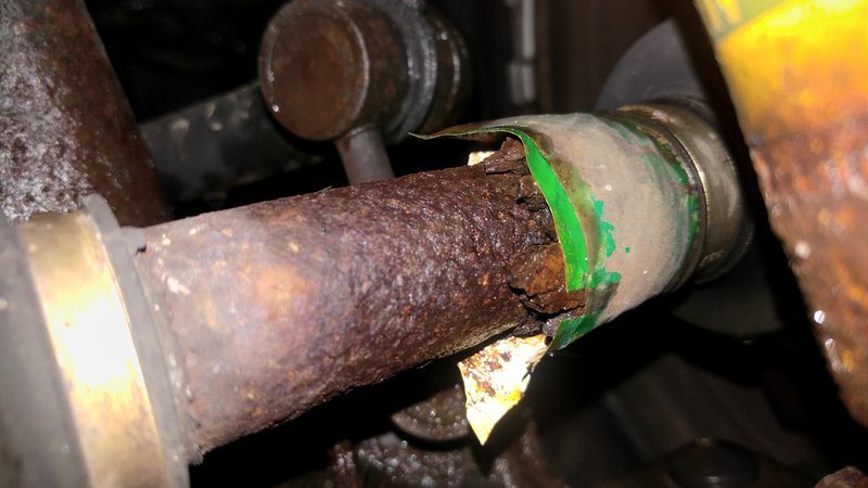

    I wanna swap one in and reboot the old one, do they just have torn boots?

    No, the boots ate fine. It's the main shafts. They're considerably eroded.
    Note the circumference difference of the bulk of the mid shaft compared to the end section. Much thinner. I wouldn't put much trust in them.

    Wow I have never seen a cv like that before, crazy what the salt will do, it's like this state tries to destroy everyone's cars. in that case I'll just have to search around for one on eBay or something
