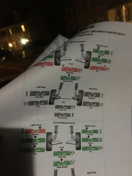

    Truck is fixed ish from the weekend:
    Bought a collapsible saw for next time
    Alignment fixed too!

    it handled fine, but the front right squealed during sharp turns until the alignment, and now the steering wheel is centered.
    I don't always get an alignment after a wheeling trip, but i'm thinking I should start. wonder if Cam Tab gussets would help?

    I have JBA UCA's so I don't know if I can get anymore caster than that?

    I'm not sure with JBA UCA's. From what I've read, you want to shoot for ~2.5 or better. My LR UCA's have no problem going over 3

    TC FTW. Got 4° out of mine.

    4* sounds high Craig.
    What's the benefit of 4* Caster? Clearance?

    Pushes the wheels forward - with 35's it helps keep the tires off the firewall.
