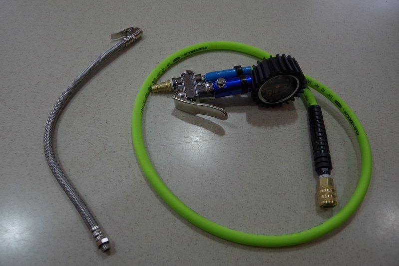

    Here are the parts (all from Amazon) that I used to extend the hose on the ARB Inflator. Credit goes to Nick @Crom for the idea, parts list and detailed instructions: I love the lock-on chuck. It's a hundred times better than the original ARB chuck IMO.

    What do you do just use a lock on style air chuck on the end of he green hose then? Or is that brass peice the chuck?

    I removed the original stainless braided hose and horrible chuck and replaced it with the brass lock-on chuck and green hose. You'll need the 1/8 BSP male to 1/4" barb to connect the hose to the main body of the inflator.
