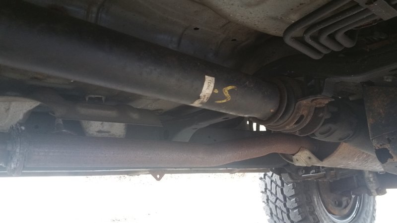

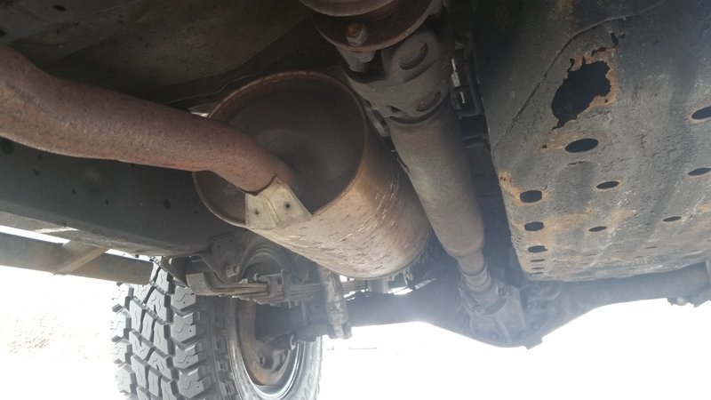

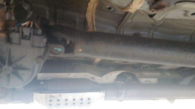

    How long ago did you lift? Did you have vibes before you did?
    Ideally you want your driveshaft angle like this:
    There are two things you can do to try to get this to line up, an axle shim that can slightly angle your diff or drop your carrier bearing a bit with washers. Best bet is to check your angles.

    A bad ujoint can rattle a truck apart if let go long enough. A joint bad enough to shake like that will either have noticeable play or be seized. Your other post saying it was always there but is now worse leads me to believe it was seized and has now gone to noticeable play. Set parking brake, chawkz the wheels, put the truck in neutral and grab the shaft... and try to move it up and down, left right and see if anything moves other than the normal rotational play

    Will check. One thing I did noticed when I acquired the truck is that the shaft zirks were barely serviced. No grease at all. So much that the front driveshaft would not budge when the clutch was being serviced. I had to buy a used one. I have only greased it about 4 times in almost 3 years and 25k, definitely not enough. So you might be right, something is probably seized.

    It actually doesn't look like the angle @cynicalrider suggested

    The only play I found was a little in the carrier bearing, but I think that's normal no?

    It's hard to tell from your photos. The most important pic to take is a side shot of the rear diff. You want that to be in a straight line from driveshaft to where it hooks up to the diff.
