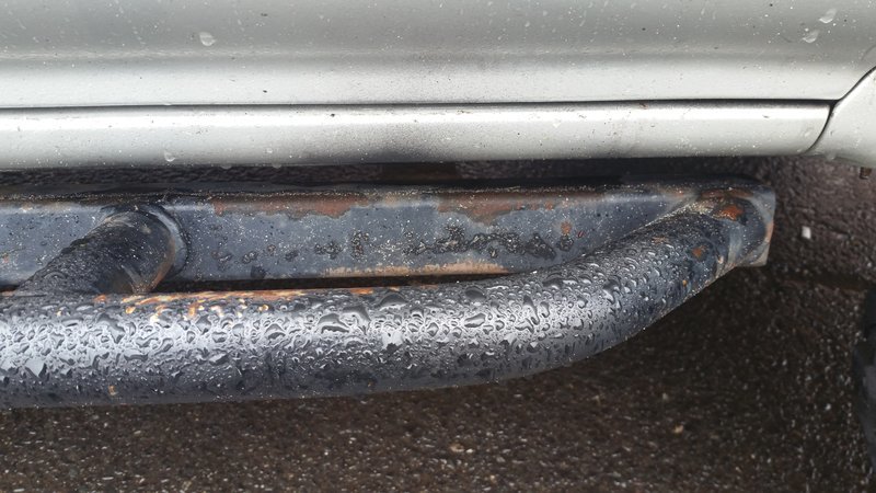

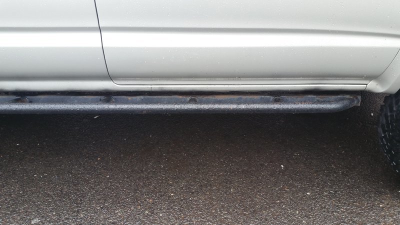

    I say go with kick outs. You want your kick out to basically run in line with where your eventual rear tires will stick out to. That way you have a smooth protected transition when scrubbing a tree or rock.
    Also it's all about camera angle, and angle you set your sliders at when it comes to rocker protection. Here is my truck, you hardly notice the sliders from this angle.
    Mine are almost touching the pinch weld, so much so that I bent the pinch weld over so it doesn't make contact when the truck flexs.
    You want them angled up as high as possible, while still being able to open your door and not have them hit.
    Here is a side view that makes them look a little less nice, but still it's pretty tucked.
    Bolt on vs weld on isn't a matter of strength anymore. Good bolt ons are just as good but let you easily repaint if you need to. I wish I could have afforded bolt ons. Weld ons are a fuck ton cheaper though. Honestly best bang for your buck weld ons are 4x. Also if you get bolt ons you cant set your angles like you can with weld ons.
