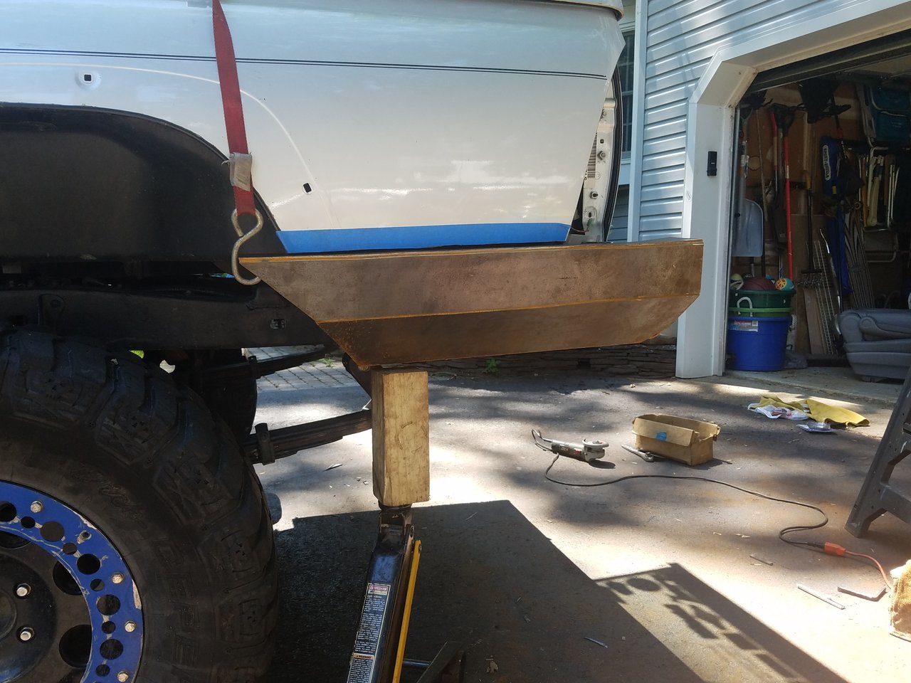

    Starting to look like a bumper:sawzall::welder: pain in the ass by yourself tho

    Recovery points going to be at the main frame plates?
  5. Jul 2, 2017 at 2:49 PM
    Sub-Zero
    Sub-Zero NOOB
    Oct 15, 2014
    #140388
    4,524
    Frederick, CO
    '06 DCSB
    None
    Idk yet, I wanted the 1/2"plate to stick out far enough but that doesn't seem to be the case so for now the whole thing is the recovery point. I'll probably just sink some moor 1/2" in there when I do the hitch

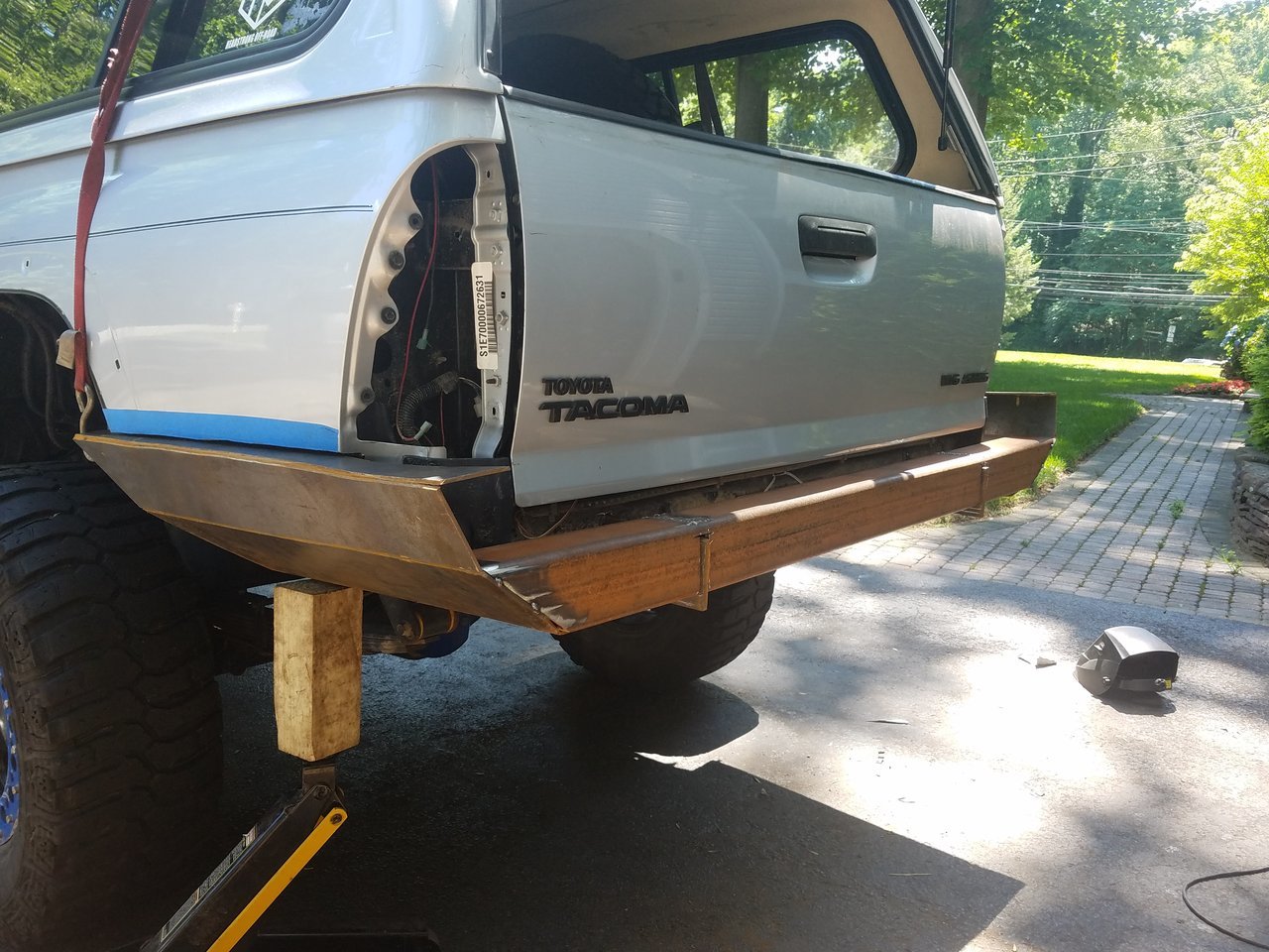

    damn, how heavy is this thing??

    Not terrible...but pretty heavy

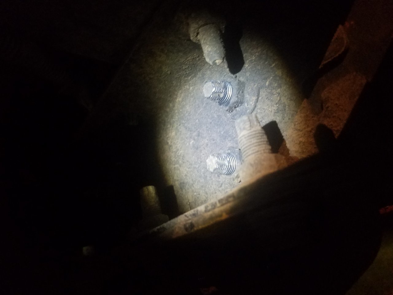

    The factory tow hitch mounts are 1/8". They do have a curl to the edges, so are stronger than flat 1)8" stock. I am going with 1/4".

    The factory bolts have about an extra 1/4" of thread past the nut that is welded to the frame. So 3/8" would be max to still have total thread engagement.

    Does your bumper use the Bott nuts on the frame like the factory hitch does?

    That enough thread engagement for ya?
