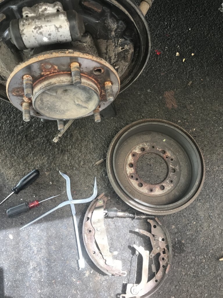

    Today is gonna suck.
    Rear shoes, drums and cylinder all need to be changed.
    One of the brake shoe hold down pins broke the other day and everything imploded.

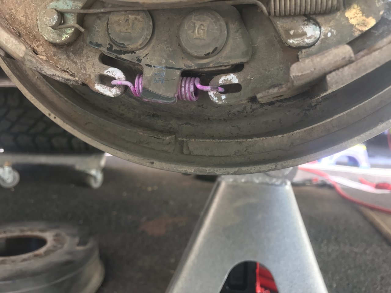

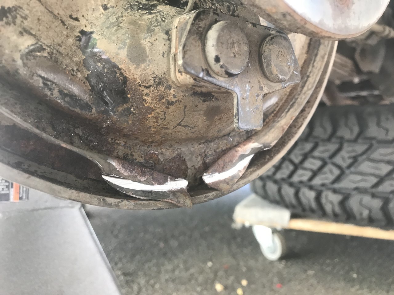

    Just spotted this.
    Should I just beat on it to straighten it out? Or do I have get a replacement?
    Should look like this:

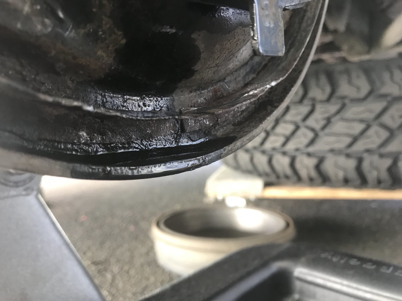

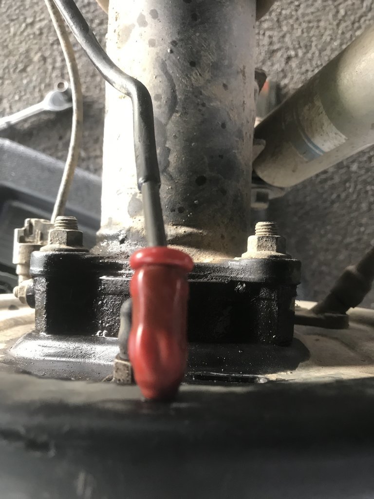

    I'm going to have to remove the old brake cylinder and replace with a new one. Which means I have to undo the brake hardline flare nut.
    How do I deal with the brake fluid that's gonna pour out? Is there a way to slow or stop the fluid?

    Not sure what size the brake lines are in the back on our trucks but possibly a pencil eraser cap? Or you could get one of those brake bleeder bottles and stretch the hose over the line then binder clip it closed.

    Got a condom on it

    Just pound it back into shape

    Cut off a box wrench and weld it onto a piece of pipe.
    I did the two wrench dog leg.

    Before:
    After:
    Tested with the new drum before installing the shoes. No rubbing!!!!
